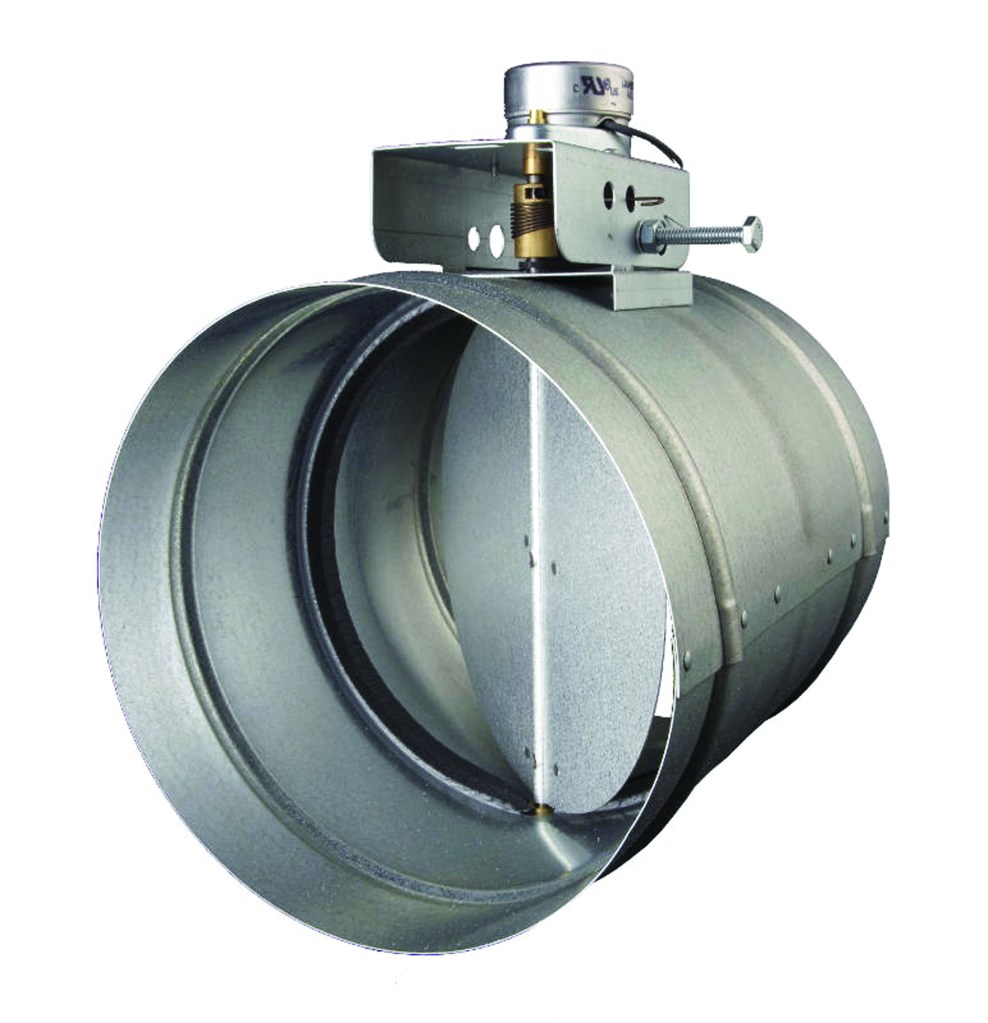

Broan’s makeup air damper opens or closes in response to the control on the range hood fan, allowing passive entry of makeup air for the exhaust fan.

There are two kinds of solutions to providing makeup air: active and passive. Typical of the passive solution is the Broan Automatic Makeup Air Damper (see photo, above). The damper comes in three sizes (6 inches, 8 inches, and 10 inches). The idea is for the damper to open any time the exhaust fan is depressurizing the space. Broan offers a variety of control strategies for operating the damper: a “LinkLogic” connection that sends control signals over power wiring, a direct-wired connection that communicates with the exhaust device through low-voltage wiring, and a Universal model that controls the damper by means of a pressure sensor at the exhaust device, connected to the damper via low-voltage wiring.

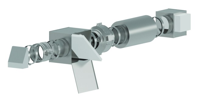

Fantech’s MUAS makeup air system includes ductwork, a filter, and an inline fan designed to supply the same amount of air used by the exhaust fan while maintaining a neutral pressure in the kitchen. MUAS sizes are available to match very large range-hood and downdraft exhaust fans.

The Broan solution requires a pressure difference to move air through the makeup air duct. An alternative to this strategy is the Fantech Makeup Air System, or “MUAS” (see photo, above). The MUAS incorporates an in-line intake fan to the air supply duct, calibrated to match the kitchen exhaust fan. Like the Broan damper, the Fantech equipment comes in a range of sizes to match various exhaust fan capacities: the MUAS 750, the MUAS 1200, the MUAS 1600, and the MUAS 2000 (the number corresponds to the maximum cfm of the fan). Controls enable the installer to set up the system to operate at a neutral air pressure, a slight positive pressure, or a slight negative pressure. The system responds to the speed of the exhaust fan and ramps the MUAS fan up or down to match the exhaust airflows.
In cold climates, in-drawn air can cause discomfort during winter. To compensate for this, Fantech offers an optional MUAH air heater that tempers the incoming air using electric resistance heat.
