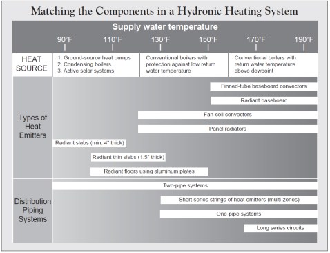

To design an efficient system, you must match the heat source to the “heat emitters” — that is, radiators and convectors. Some types of heat emitters are best suited for relatively high-temperature heat sources. For example, the familiar finned-tube baseboard convectors, used in many residential and light-commercial buildings, work well with water temperatures above 150°F, but not with low-temperature systems such as ground-source heat pumps (see table “Matching the Components” ).

This chart shows the typical operating ranges of various hydronic heat sources, heat emitters, and piping systems, although unusual circumstances may occasionally require designs outside of these ranges.
Because each heat emitter receives water at about the same temperature, the temperature drop between the boiler supply and return will be less than that associated with a series piping system. A typical parallel system, for example, may have a temperature drop of only about 10°F between the boiler supply and return. By contrast, a typical series system could have a temperature drop of 20°F or more. The smaller temperature drop of the two-pipe system helps keep the temperature of the water returning to the boiler above the dewpoint of the exhaust gases, thus preventing flue-gas condensation.
Two-pipe systems are the best choice for use with low-temperature heat sources such as heat pumps or condensing boilers. Radiant floor systems can be considered two-pipe systems since each floor circuit is connected in parallel with the other circuits at the manifold stations. Twopipe systems also allow easy zoning by using valves to regulate flow through any given heat emitter.
