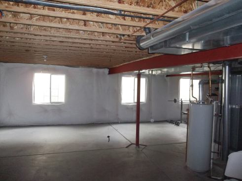

The furnace and water heater are often installed in the middle of an unfinished basement, with access to the entire volume of air in the basement for combustion. Once a basement is finished, however, the furnace and water heater are usually isolated in a small mechanical or utility room, which limits the available combustion air and requires a different strategy.

All homes leak air to some degree, and homes more than 10 years old are likely to leak a lot. These leaks occur at construction joints and penetrations of exterior walls and ceilings, as well as through doors and windows and along pathways such as dryer vents and kitchen exhaust systems. This air infiltration is looked at in relative proportion to the volume of the spaces within the house. Specifically, 50 cubic feet of interior air (that communicates with the fuel/gas appliances) provides enough combustion air for 1,000 Btu/h. So for our 140,000-Btu/h example, we would need 7,000 cubic feet of volume, or an 875-square-foot unfinished basement with 8-foot ceilings. But the situation changes when a mechanical room is built to hide the furnace and water heater.

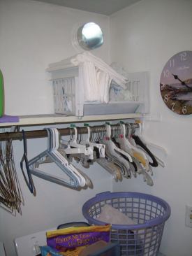

Transfer air grilles are one option for putting a furnace out of sight, but not out of compliance. These openings in the mechanical-room walls allow the air outside the mechanical room to communicate with the air inside. With this method, one opening must be placed within 12 inches of the ceiling and one within 12 inches of the floor, to promote thermocycling—the natural movement of air due to temperature differentials—in the room. Thermocycling is key for ventilation around the equipment.
Each opening must be sized individually and have at least 100 square inches of “free area”—the actual open area of the grille not including any mesh or other screen or louvers. (For a metal grille, the free area is typically 75% of the area of the grille, and for a wood grille, only 25%). If the opening is through a wall, it must provide 1 square inch of free area for every 1,000 Btu/h of all the appliances (140 square inches for our example). The upper opening can also communicate through the ceiling to the space above, but then it must have 2 square inches of free area for every 1,000 Btu/h.
Using fully louvered doors on the mechanical room is one solution. The bottom half of the door acts as the low opening and the upper half as the high. Even with a paltry 25% of actual free area, louvered doors are usually big enough to meet the overall size requirement.
Place transfer air openings so they won’t be highly visible in the finished basement and make sure they won’t be blocked by furniture. For design flexibility, the high and low transfer air openings don’t have to be in the same part of the wall, as long as they both communicate with the same volume of space. Transfer air grilles cannot take combustion air from bedrooms or bathrooms.

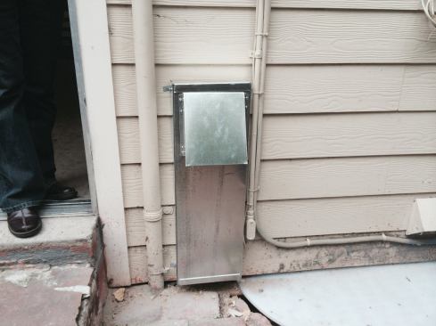

When the mechanical room is adjacent to an outside wall, openings for combustion air can be direct to the outside. When high and low openings are used (as with inside air), they need to have only 1 square inch of free area for every 4,000 Btu/h. So in our 140,000 Btu/h example, the high and low openings would each need to be just 35 square inches (or 7 inches in diameter). This same size would also work for vertical ducting to transmit outside air from above or from a ventilated attic or crawlspace. Inside the room, direct or vertical openings must terminate right where they enter the room.

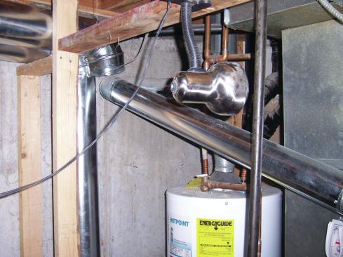

If air travels through a horizontal duct to the appliances, a different sizing method must be used. In this case, the area of the ducts must be twice as large as with the direct and vertical methods—1 square inch for every 2,000 Btu/h, which would increase the diameter for our example to 10 inches. Air moving horizontally through a duct encounters more resistance than air moving vertically, but curiously, the code doesn’t place limits on the duct’s length.
Remember that air just needs to be introduced to the basement or mechanical room, not brought directly to the equipment. Don’t duct outdoor air to a natural-draft combustion appliance. In colder regions, air brought directly to a natural-draft appliance can have an adverse effect on the flue, and the cold air can freeze nearby water pipes.
