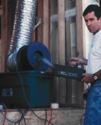

The first step is to attach the Duct Blaster fan to the air distribution system (Figure 2). We can attach it to the blower compartment on the air handler or to a return grille. If the air handler is not set when I arrive to test, I connect the Duct Blaster directly to the trunk lines in the mechanical room where the air handler will eventually be set. But we prefer to test with the air handler installed, because of the leakage we've seen in even brand-new units.
Figure 2.The author tapes a plastic transition fitting to a piece of cardboard cut to fit the opening in the air distribution system (top), then places the assembly in the opening (left center) and connects the fan to the opening with a length of flex duct (right center). It's best to test the system with the air handler installed, because the air handlers are often a leakage point. If the air handler has not been set, the author hooks up the Duct Blaster to the trunk line where the air handler will go. The equipment can also be attached to a return grille (bottom).
