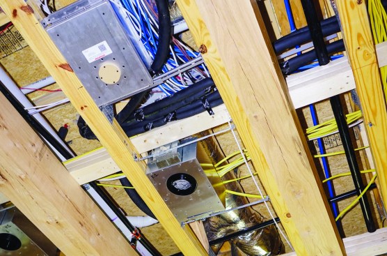

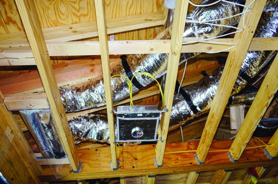

Ductwork installed in this high-end custom home under construction will be difficult to access after the ceilings are
drywalled.
Ductwork installed in this high-end custom home under construction will be difficult to access after the ceilings are drywalled.
At this point in the job, however, the air handlers have not been installed.

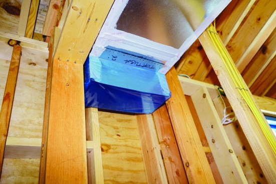

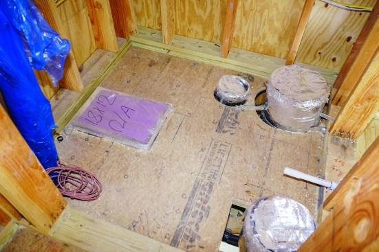

Instead, supply and return duct runs are capped with plastic wrap and tape in the mechanical room.
Positive Energy duct expert Sean Harris will test the duct system now, and then return later in the job to re-test the fully assembled system.

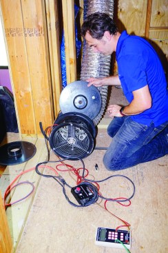

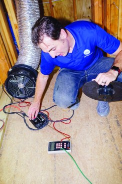

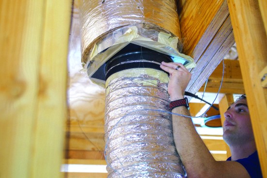

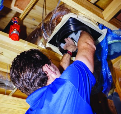

Next, Harris attached his Minneapolis Duct Blaster (energyconservatory.com) to the duct system. “When I hook up to the main source,” he says, “it’s important for me to look at the plans. I have to make sure that I haven’t missed anything that I need to seal off, and check that the locations on the plans match up with what is there in real life.”

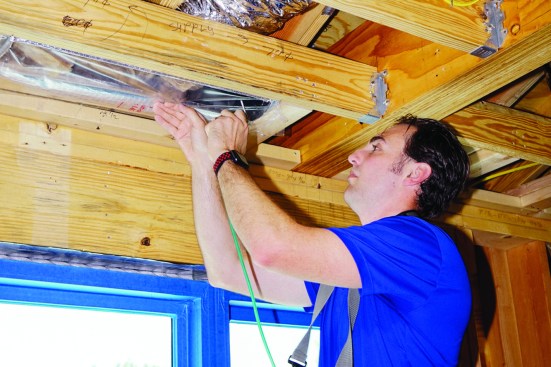

To prepare for pressure and airflow testing, Harris attaches the Minneapolis Duct Blaster’s collar to the end of a supply duct, sealing the inside of the collar.
He seals the outside with tape.
Next, Harris inserts the end of the Duct Blaster manometer’s pressure-sensing air tube into the taped-off end of the duct. When the fan is up to speed, the device’s DG-700 pressure and flow gauge will calculate the duct run’s air leakage.

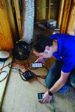

In this case, after taping off all the duct registers, Harris connected the end of the Duct Blaster to the end of a trunk line in the ceiling of the mechanical room, then inserted the pressure-sensing air hose for the device’s manometer into a supply duct register. Then he powered up the Duct Blaster for a pressure test .
After hooking up the Duct Blaster, Harris adjusts the fan controls to bring the pressure in the system to 20 pascals.
By itself with no-air handling equipment hooked up, the duct run is remarkably airtight—so airtight that to get meaningful numbers, Harris has to insert a “Ring 4” flow restrictor into the fan assembly.
With the flow restrictor in place, Harris recalibrates the
pressure and flow gauge, and uses his smartphone to calculate the equivalent leakage rate.
With the flow restrictor in place, Harris recalibrates the pressure and flow gauge, and uses his smartphone to calculate the equivalent leakage rate.
As it happened, the leakage for this run of ducts was so low that Harris had to insert the smallest available flow-restricting ring (known as “Ring 4”) into the Duct Blaster, then use a lookup table on his smartphone to calculate the leakage rate based on the modified fan speed and pressure.
If the system shown in this story were complete, he notes, the calculated level of leakage (9 CFM25) would have been extraordinary. But only after the equipment was installed would he see final numbers for the whole system. “I’m not looking for just a pass or fail on duct leakage at this point,” he explains. “I’m thinking about the big picture.” This test did establish that the ducts would not need to be fixed before drywall.

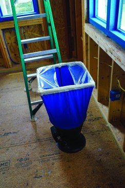

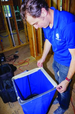

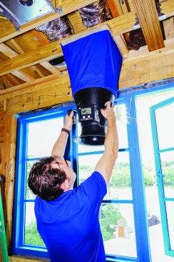

With the leakage test complete, Harris moved on to the airflow test, using an Alnor LoFlo Balometer Capture Hood, manufactured by TSI (tsi.com). “I take down all the tape off the registers, and I turn up the fan, and I make sure that the fan is putting out roughly the amount of airflow that I should have through the duct system,” he explains. “Then I can see how balanced the rooms are in relation to each other. If I find major imbalances, I need to figure out what is going on. Maybe we have to put some dampers on. Or maybe the installers used the wrong duct size, and one room has a duct that is too small.” In one case, Harris actually detected a duct run that was completely blocked: “The trunk line never got cut in at the plenum. Once the duct was attached, you couldn’t see it, and nobody caught it until I was there to test.”
The Alnor flow hood measures airflow through a supply register.
Because he’s testing the system with no drywall installed,
Harris masks off the parts of the flow hood that would ordinarily be blocked by the drywall.
Because he’s testing the system with no drywall installed, Harris masks off the parts of the flow hood that would ordinarily be blocked by the drywall.
On this house, Harris didn’t find any deficiencies. That’s not surprising, he says. “If the air-conditioning contractor follows our design to the T, they shouldn’t have to balance anything. Sometimes I go in and measure, and I get the exact numbers that we designed for that space.”
Then, with the Duct Blasterfan set to supply the design airflow for the system, he checks the output of every register in the rooms served by this duct run, to make sure that the actual flows match the design values for the system.
