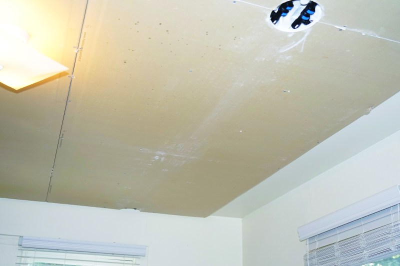

The radiant-panel ceiling, left exposed in the author’s offices for educational purposes, consists of a gypsum board layer over aluminum heat-transfer fins, backed by a 1 1/2 -inch layer of EPS insulation. Ink patterns on the surface of the drywall help installers avoid screwing into and puncturing coolantcirculating tubing within the panels.

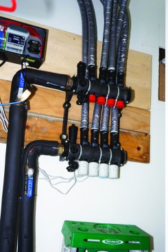

A manifold allows the system to be zoned room by room.

The radiant system uses cool ceiling panels as the heat-absorbing surface. These are premanufactured panels that consist of aluminum heat conductors sandwiched between a layer of gypsum board and a 1 1/2-inch layer of EPS insulation that isolates the cool fins and gypsum board from the framing of the building. Polyethylene tubing filled with glycol and water fluid runs through the aluminum fins in a serpentine pattern to transport heat into or out of the panels. Because of the EPS insulation, the radiant exchange from the hydronic tubing occurs more strongly with the room-facing panels than the framing-facing structural members. This allows for a rapidly variable panel surface temperature—important in a humid, cooling-dominated area like central Texas.
In operation, the gypsum-board ceiling is maintained at about 68°F. Humans (and their dogs) in the space radiate heat to the gypsum board, which absorbs the heat and conducts it into the aluminum fins, which conduct it to the tubing. The fluid circulating through the serpentine tubing at about 60°F absorbs the heat and transports it to a manifold, which directs the warmed fluid into the return line leading to a buffer tank in the mechanical room. We have four rooms in our office, so our manifold has four loops. But you could manage as many zones as you wish by extending the manifold.

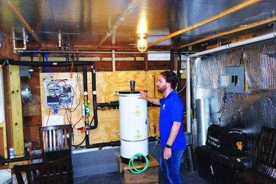

The buffer tank in the basement separates the source side from the system side. The buffer tank plays an important role in maintaining equilibrium for the system, because the fluid in the system maintains a reserve of heat and cooling that is always available to answer short-term demands. Our system has a 30-gallon buffer tank, maintained at about 60°F during the summer cooling months. If there were to be a massive call for cooling upstairs, and we needed to send an increased volume of thermally absorptive fluid up there, the reserve in the tank would be available to answer that call and our cooling source (an air-to-water heat pump located outside) would be able to carry on at its usual measured, consistent pace.
So we separate the source from the system using the buffer tank. The buffer tank can be considered a thermal battery, and could be larger than 30 gallons if needed for the application. For example, we could design an off-grid system with sufficient thermal storage that the high-COP (coefficient of performance) heat pumps run only when solar photovoltaic power is available during the day. In that case, we could use an array of 80-gallon or 100-gallon buffer tanks to store cool water that could answer the demand for cooling without the need for an energy-hungry compressor to operate. For larger projects or projects with critical loads, these thermal storage reservoirs can be extremely well insulated and hold thousands of gallons of thermal fluid, or even a combination of thermal fluid and phase change materials (PCM), capable of absorbing or delivering tens of thousands of Btu of energy.

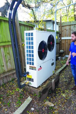

The buffer tank provides a thermal mass that lets the system smoothly ride out fluctuations in the demand for cooling or heating. Outside the building is our heat source and sink: a 3-ton SpacePak Solstice air-to-water heat pump. Here, the heat that was originally absorbed as direct radiation from the bodies of people in the space into the ceiling panels is finally shed from the system out into the outdoor air. This same energy could have been shed directly into the ground around our building using a ground-coupled heat exchanger and a pump to circulate the hydronic fluid. In our climate, we can avoid the installation cost, soil ecosystem disruption, and embodied resource use with ground loops by rejecting the waste heat into the air. We can even first shed waste heat into a domestic hot-water storage tank, while maintaining high coefficients of performance.
In a lower-floor mechanical room (above, right), a buffer tank isolates the indoor side of the system from the outdoor side, allowing the heat pump that powers the system to run efficiently without having to directly answer calls for cooling from the occupied space.

Outside the building, a 3-ton SpacePak Solstice air-to-water heat pump dumps excess heat from the building to the outdoor air—just one of many possible solutions that are possible with radiant cooling.
