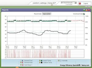

Take a look at the second graph, which shows data from a two-and-a-half-story rental house built in 1880 in Climate Zone 5. See how the temperature (green line) races up whenever the furnace runs? Fast temperature changes can feel uncomfortable; our bodies prefer slow changes. It’s possible that this home’s furnace is oversized, the occupants are uncomfortable, and the energy bills are high. Once you start installing Ecobees, you’ll realize that almost all HVAC equipment is substantially oversized, which very often leads to comfort and balance problems.
Indoor air temperature. Many of us have lived in older homes that were poorly insulated. In those homes we had to sit on or near a heat vent to keep warm. More than likely, the indoor air temperature fell like a stone when the furnace shut off, and the surrounding surface temperatures never quite warmed up to levels needed for human comfort. Maintaining consistent air and surface temperatures—achieved with right-sized HVAC and a decent (it doesn’t have to be perfect) building enclosure—are critical to maintaining indoor comfort.
Look at the graph again. See how quickly the temperature drops once the furnace cycles off? This suggests that the home may need air sealing and insulation. Wouldn’t this data enable you to ask the client informed comfort questions as well as guide your investigation efforts?
When clients are cold, they increase the temperature set point. If you see thermostat games—the red dashed line on the graph tells you that—you know that there are problems.
