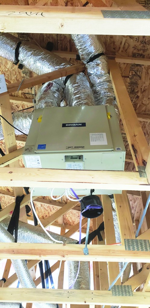

The Broan ERV shown above runs continuously, providing fresh air to the home. In the most recent generation of Mandalay Homes houses, the ERV is integrated with the ductwork serving the home’s heating and cooling system, which continuously distributes air through the house.
Geoff Ferrell/Mandalay Homes The Broan ERV shown above runs continuously, providing fresh air to the home. In the most recent generation of Mandalay Homes houses, the ERV is integrated with the ductwork serving the home’s heating and cooling system, which continuously distributes air through the house.

The ERV we use is the Broan ERV140TE, one of Broan’s newer models that has been sold in Canada for a while and was recently introduced in the United States. It has intelligent controls and an ECM motor that allows fine-tuned control of the fan speed and operating time. We can dial in the amount of airflow that we are looking for, based on the square footage of the home, so that we’re meeting ASHRAE requirements but we’re not overventilating or underventilating. This way, we don’t have to use a different ERV in every home; we can just program the Broan to precisely meet the requirements of any size home that we build.

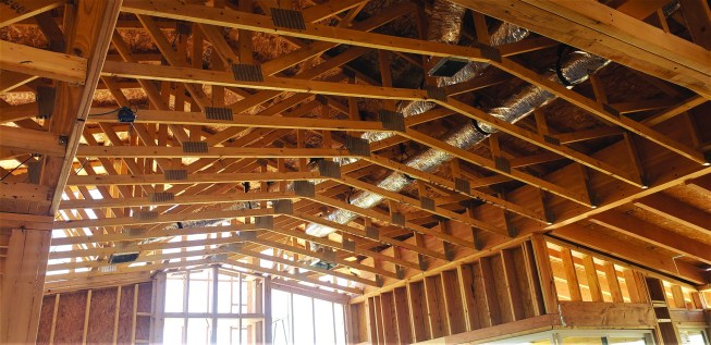

The home’s HVAC duct system delivers conditioned fresh air to every room in the house. A centrally located return pulls stale air from the living space and exhausts it to the outdoors.
Geoff Ferrell/Mandalay Homes The home’s HVAC duct system delivers conditioned fresh air to every room in the house. A centrally located return pulls stale air from the living space and exhausts it to the outdoors.
We pair the Broan with the Trane by connecting the supply duct from the ERV to the return plenum for the heat-pump air handler. We dump the filtered incoming air to the return plenum, and then the Trane’s fan moves it through the supply ductwork to every room in the house. We have a dedicated, centrally located return for the ERV that draws in stale air from the house and sends it out of the building.
Running the ERV continuously as we do enables us to control the air pressure in the house relative to the outdoors. When commissioning one of these ERVs, the pressures in the system must be balanced. We do this by measuring indoor and outdoor pressures with a manometer, and then we set up the system so it creates just a very small positive pressure in the house compared with the outdoors. It’s a tiny difference—just one or two pascals—but it’s enough to keep air from seeping in through any leak points. This helps the homeowners avoid pollutants from outside, like smoke, dust, and pollen. Indeed, our homeowners report that they see less dust and fewer pollutants in their houses.
