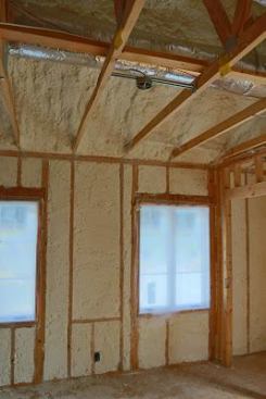

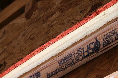

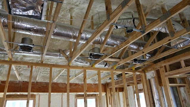

CEILING INSULATION:
Ceilings have gone from R-30 to R-38 but that requirement is based upon fiberglass insulation on a flat drywall ceiling and a "hot" attic above. With a conditioned attic and spray foam under the roof deck the code has changed from R-21 to R-25. With open cell foam (approx R-3.8/inch) we used to use 5.5" inside the roof line to make code. (I'm also a big believer in using 2" of rigid foam sheets on the roof deck, see this video for my technique). Now to make the R-25 requirement you will need 7" of open cell spray foam. My new Risinger Homes standard is 8 inches of open cell at the roof line for R-30 insulation.

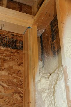

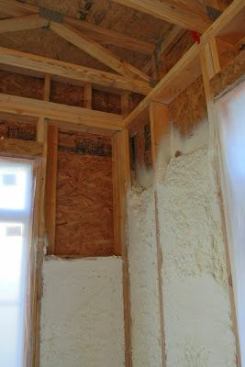

WALL INSULATION:
Walls have gone from R-13 to R-15 OR R-13+2. The +2 is referring to exterior rigid foam that can be added to a standard 2x4 wall with R-13 insulation. This means that typical fiberglass batts in a 2x4 wall don't meet code anymore (finally), you'll need a total fill BIBS or Spray Foam to make the R-15 requirement in a 2x4 wall. My preference has long been to use a total fill insulation and open cell spray foam is tough to beat. It totally fills the stud cavity and it does a good job of air sealing inside that stud bay. Here are some photos of a Risinger Home under construction in Barton Creek my crew just insulated this week. We used 8" of foam in the roofline, and 5.5" in the Advanced Framed Walls.
