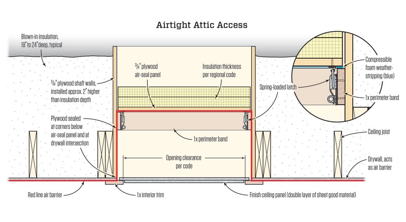

The attic access provides a portal to the attic space, while being integral to the “red line” air barrier. The walls of the assembly also act as a dam to retain blown-in insulation in the attic. The finish panel visible from below does not have to be airtight.

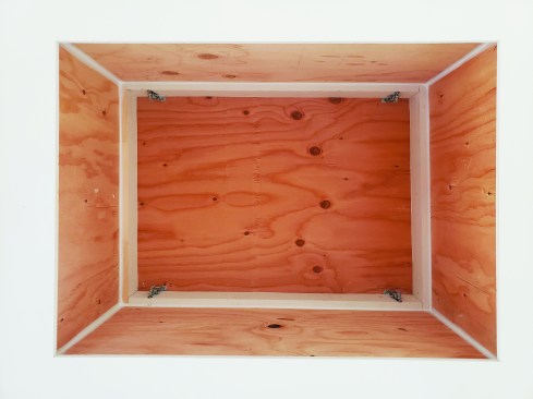

Viewed from below with the ceiling panel removed, the walls of the access extend far enough up to retain the blown-in

Viewed from below with the ceiling panel removed, the walls of the access extend far enough up to retain the blown-in insulation.
Multifunction component. In addition to providing access to the attic, the assembly shown below works as an insulation dam. In many of the high-performance homes I design, it is not uncommon to have 18 to 24 inches of blown-in cellulose in the attic, so the shaft portion of the attic access is necessary to keep the insulation in place. The four walls of this shaft should always be a little higher than the depth of insulation being retained.

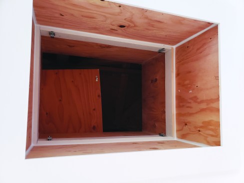

With the airtight panel in place and all the corners sealed, the access completes the air barrier of the house.
Because of its height, the attic shaft lets us incorporate two removable access panels, instead of just the usual single doorway to the attic. The first is the ceiling panel that you see from the interior of the house that completes the interior ceiling finish, closing off the attic shaft from view. A second air-seal panel is farther up the shaft of the attic portal—high enough so that the ceiling panel can be lifted and removed easily. The air-seal panel functions much the same as an exterior door on a house and should be thought of as an operable boundary element between the inside and the outside of the house. It should be fitted with rigid insulation per regional code requirements.
Building the assembly. In most houses with ventilated attics, I use the ceiling drywall below the attic as the air barrier. I think of the four walls of the shaft as simply that air barrier folded up into the attic. (As a cautionary note, be sure to consult your local building code for the required clearance dimensions needed for the access portal).

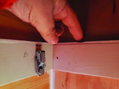

After framing the opening, we typically build the shaft out of 3/4-inch plywood. We seal the wall panels of the shaft where they interface with the ceiling drywall. In addition, we seal the corners of the shaft up to where we install a 1-by perimeter band that supports the actual air-seal panel, and we also seal the perimeter band to the walls of the shaft.
Compressible weather stripping on top of the 1-by perimeter band creates the air seal.

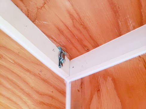

The perimeter band creates a solid shelf where the air-seal panel (also made from 3/4-inch plywood) can be pressure fitted. Typically, we install 3/4-inch-wide adhesive-backed, compressible weather stripping on top of the perimeter band. We attach the air-seal panel to the perimeter band via four spring-loaded latches (such as National Hardware N208-587 Lockable Catches). The latches let the panel fully engage with the weather stripping to provide a good air seal and to maintain near-perfect continuity of the air barrier.
Spring-loaded catches hold the airtight panel in place.
