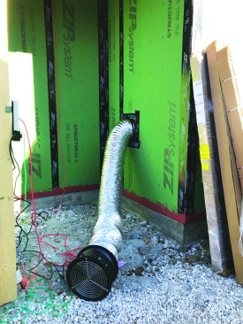

Using a Halloween fog machine ($30 to $40 on Amazon), the author and his crew pumped fog into the interior of a newly framed building. By pressurizing the house with a blower door, they were able to identify and seal myriad tiny leaks before those holes were buried in insulation. This allowed them to go from a tight 1.1 ACH50 (the initial test) to a very tight 0.35 ACH50.

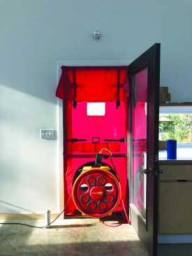

There are currently two popular blower-door makers selling in the U.S. market—The Energy Conservatory (TEC) and Retrotec. The author runs an older TEC model.
The HERS rater he often works with runs a Retrotec. Both work well, though there are numerous small features offered by each company that differentiate these products. In the author’s estimation, which one someone trains on first is usually considered the “best.”

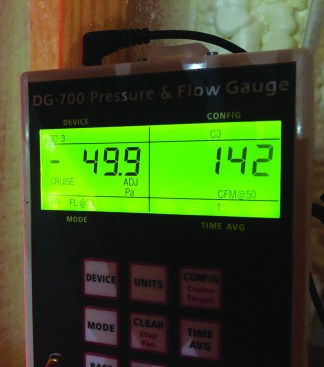

The TEC manometer is reading in CFM. The author prefers CFM, which more directly relates to the leakage level. He performs the calculation to normalize for house volume (ACH50) by hand. During a test, it can be difficult to dial in to an exact “50 Pa.,” given the sensitivity of the instruments, but 49.9 or 50.1 are both sufficiently accurate.

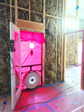

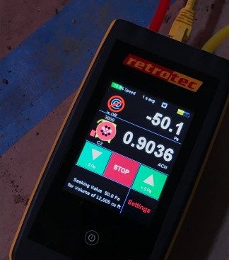

The Retrotec uses an added input for house volume to read out in ACH.

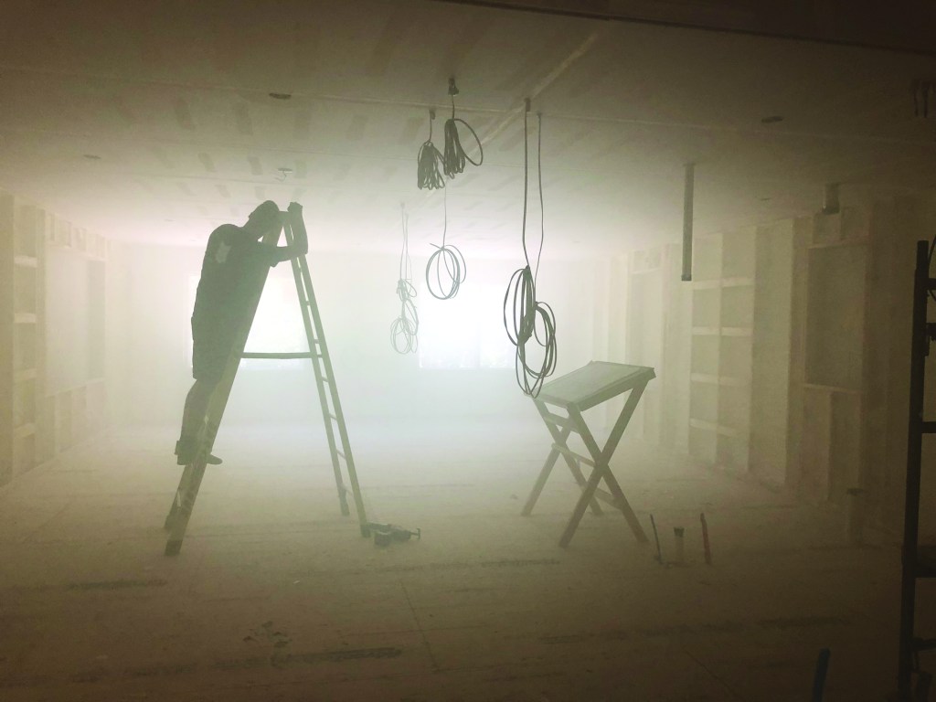

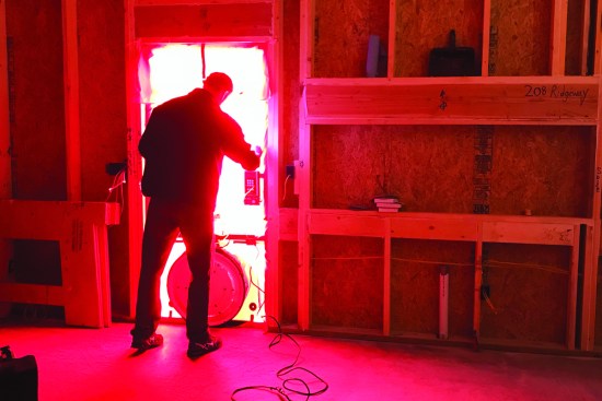

The process for verification is simple: We close all the windows and exterior doors, turn off any appliances like the furnace and water heater, turn off the clothes dryer, and shut the dampers and doors on fireplaces. Then we set up our blower door. It consists of a temporary (nylon fabric) door and a large, variable-speed fan that we install in one exterior opening, typically the front door. A small rubber tube connects a port on the fan to a manometer—an electronic device that measures air pressure. A second small tube connects to the manometer, and we position the end of this outside, somewhere protected from the wind. Then we crank up the fan’s speed, with the fan blowing out of the house to depressurize the home. (The fan can also be positioned to blow into the house, which pressurizes the interior of the home.) Because we typically run a depressurization test, the readout of house pressure on the manometer shows a negative pressure. It also shows a flow rate in CFM that gives us a measure of envelope leakage. In essence, the leakage rate is deduced from a comparison of the outdoor pressure to the indoor pressure.
Understanding the math is a little less straightforward. Most blower doors these days can be run automatically using software on a laptop that syncs up with the manometer. Once the baseline parameters of the blower door are entered into the system, a test can be run. That test will provide two data points. One shows that the home is depressurized to 50 Pascals of pressure different from the exterior air, which is the required testing pressure; and the second, a CFM number, shows the cubic feet per minute of air being drawn from within the home at 50 Pascals of pressure.
To get to an ACH50 number, you must calculate the cubic footage of the home. You can get as detailed as you like here. I generally measure the interior space without taking away for interior walls or furniture, for simplicity.
Not wanting to carry a laptop around to jobsites, I opt to run the blower door manually and do the math myself. I have even written the formulas on the back of my instruction booklet to easily refresh my memory. All I need is the volume of the home and the CFM number that is displayed on the manometer readout during the test (see photo, facing page) once the fan is cranked up and the reading from the fan shows the house is at (or very near) 50 Pascals:
Cubic Feet Minute at 50 Pascals (CFM50) x 60 = Cubic Feet Hour (CFH)
CFH / Volume of home (in cubic feet) = ACH50
As an example, this was the calculation for a recent build:
142 CFM50 x 60 = 8,520 CFH
8,520 CFH / 24,300 CF = 0.35 ACH50
This amount of air leakage is equal to an opening roughly the area of a dollar bill in 9,000 square feet of envelope area.
The math is pretty simple. Some blower doors will make the calculation in the manometer for you. My door doesn’t (it’s a few years old), but I don’t mind doing the math myself. It even helps me understand what I am testing because it forces me to think of the variables, such as the volume of air in the house and the rate at which the air moves. Otherwise, it is just a number coming out of a black box.
