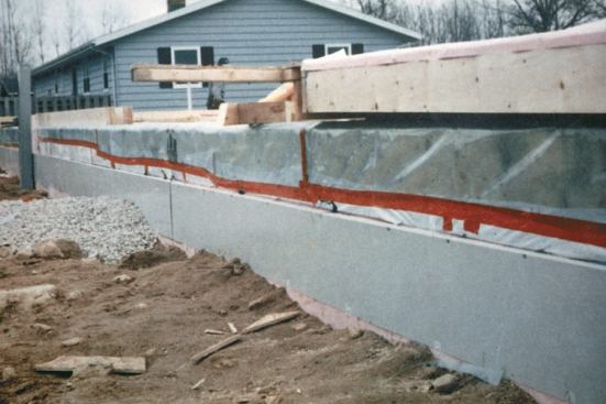

Most builders install a poly vapor barrier under their basement slabs. But it’s also important to include poly under the wall footings to prevent the foundation walls themselves from wicking up water. Eliminating this source of moisture lessens the chance of mold and improves indoor air quality. After my foundation contractor coats the exterior of the basement walls with dampproofing, I install 2 inches of extruded polystyrene foam from the footing to the mudsill. All of my basement footings have perimeter drain tile on the interior as well as the exterior. Finally, I backfill with 3/4- inch crushed stone up to 2 feet of finish grade.
To protect the rigid foam above grade, I use a tough fiberglass material called Ground Breaker, which comes in 50-foot rolls in widths of 12 and 24 inches. These panels are tough — I’ve never put a hole in one. The top edge of the material is fastened to the mudsill with 3-inch roofing nails driven through the rigid foam, while the bottom is kept in place by the dirt backfill.

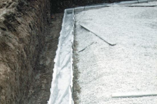

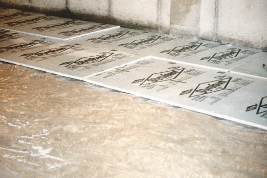

Our basement slabs are poured over 8 inches of 3/4-inch crushed stone covered Start the polyethylene air barrier under the mudsill and seal every seam by Steve Lentz with a layer of 6-mil poly. For the poly, we prefer a brand called Tu-Tuf — a high-density, cross-laminated white polyethylene. Since the poly under the slab is a vapor barrier, not an air barrier, there’s no need to tape the seams. Over the poly we install a layer of 1-inch rigid foam. If the basement is getting radiant floor heat, I increase the depth of the under-slab foam to 2 inches.

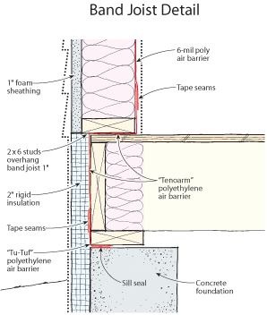

We frame our floor system so that the band joist is flush with the foundation, while the walls are framed to overhang the band joist by 1 inch. When the band joists are later covered with 2-inch foam, they end up flush with the 1-inch foam wall sheathing.

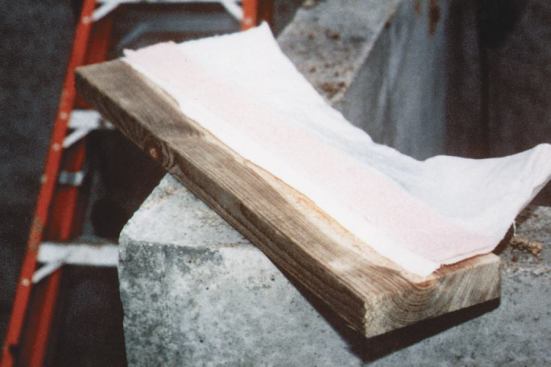

On my houses, the poly air barrier starts under the mudsill. We staple a length of 6-inch-wide Tu-Tuf polyethylene to the bottom of the sill before it is installed, with about half the width of the poly extending beyond the sill toward the exterior. Every seam gets sealed with Tremco or tape. I cut the 51/2-inch-wide roll of sill seal in half lengthwise before I staple it to the sill, because I find that the narrower 23/4-inch-wide strip squashes down better and provides a better seal. Once the sill seal is stapled over the poly, the sill is flipped over and bolted down.

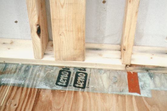

After the subfloor is nailed down and the lines are snapped for the exterior walls, we wrap the exterior of the band joist with poly. Since a band joist gets a lot of abuse during construction, we wrap it with Tenoarm, a tough 10-mil polyethylene from Sweden. Unlike Tu- Tuf, Tenoarm is transparent, so we can see the chalk lines through it where it laps onto the subfloor. The Tenoarm strips are about 16 inches wide, so they span the band joist and the 5 1/2-inch width of the bottom plate with at least an inch left for overlap. We seal the Tenoarm to the poly sticking out from under the mudsill with tape or Tremco, then fold it over onto the plywood subfloor.
Next, we extend the 2 inches of basement wall insulation up to cover the exterior of the band joist. On the inside, we insert a piece of R-19 fiberglass batt insulation up against the band joist in each bay. The 2-inch exterior foam keeps the band joist warm enough to prevent condensation on the poly.
We frame our exterior walls with 2x6s spaced 16 inches on-center, since 24-inch spacing doesn’t provide adequate nailing for siding. Once the walls are raised, the Tenoarm should peek out from under the bottom plate of the exterior walls, facing the inside of the house. On a two story house, the second-floor band joist is also wrapped on the exterior with Tenoarm. In this case, the Tenoarm extends from the interior over the top plate, up over the exterior of the band joist, and back onto the second-story subfloor.

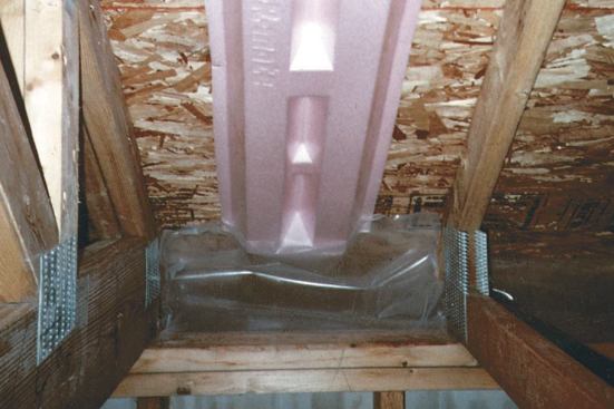

To be sure there’s enough room for attic insulation, I specify raised-heel trusses. To get the necessary R-value on a stick-built roof, where the rafters come down too low at the attic perimeter, I install several layers of rigid foam insulation between the rafters above the wall plates.
To prevent wind-washing of the attic insulation above the soffit vents, we install wind breaks between the attic trusses. These are scraps of 6-mil poly, housewrap, or Tu-Tuf, stapled to the wall top plate and the roof trusses.
