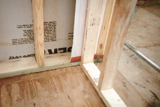

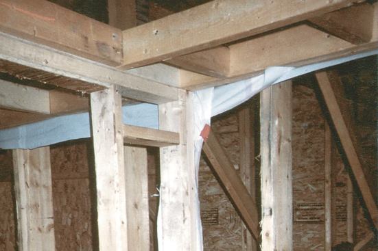

Once our walls are insulated, we install a layer of Tu-Tuf poly over the Insulweb on the inside of the exterior walls, sealing the seams with tape or Tremco. This layer is also sealed to the flap of Tenoarm sticking out from under the bottom plate. (We don’t continue the Tenoarm up the walls because it’s too thick to form neat inside corners.) Where partitions intersect exterior walls, we install a 2×6 or 2×8 backing stud as a drywall nailer, followed by a strip of Tu-Tuf, which is also taped to the Tenoarm flap.

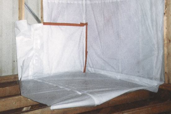

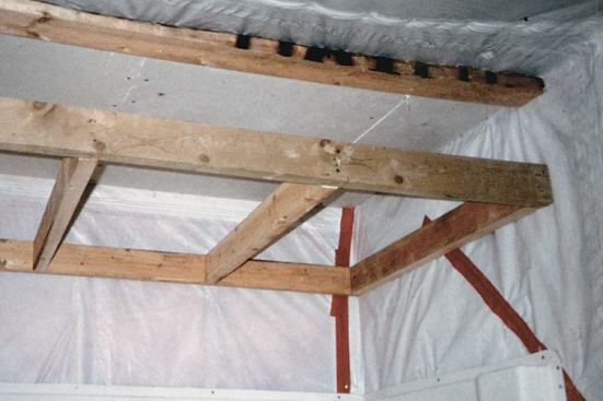

On the top floor, we prefer to install a continuous layer of poly on the entire ceiling before the partitions go up. To minimize damage to the ceiling poly, we carefully position the partition top plates against the ceiling joists and drive the bottom plates home with a sledge. Any accidental tears in the ceiling poly get repaired with tape.
Install carefully, then cut. Once all of the interior partitions are installed, I go to each second-floor room and cut up the ceiling poly. Considering the care with which it was installed, this may seem strange — but if I don’t cut it, I know the electrician will. I cut around the perimeter of the ceiling poly at three of the walls, roll up the plastic, and leave it hanging against the wall on the uncut side. I leave enough plastic at the perimeter of the room to give us something to tape to when it’s time to put the ceiling poly back up.

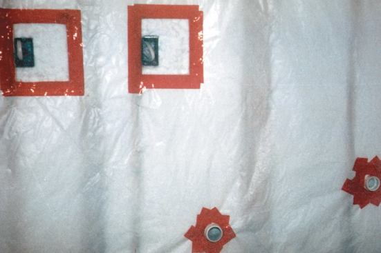

In a home with a bearing wall, where it’s not possible to install the ceiling poly in one piece, we install it room by room. Each partition needs to have a strip of poly above the top plate, and any penetration of the ceiling poly needs to be carefully sealed with tape or aerosol foam.

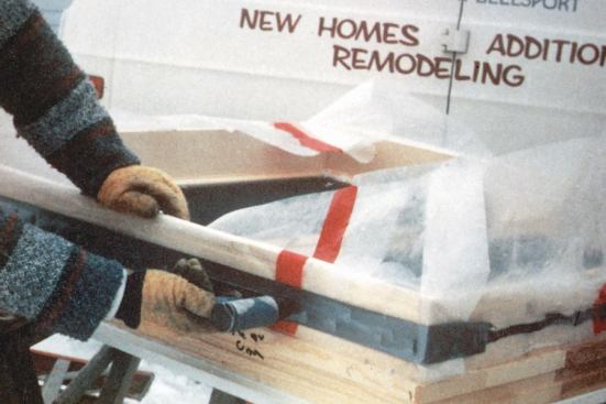

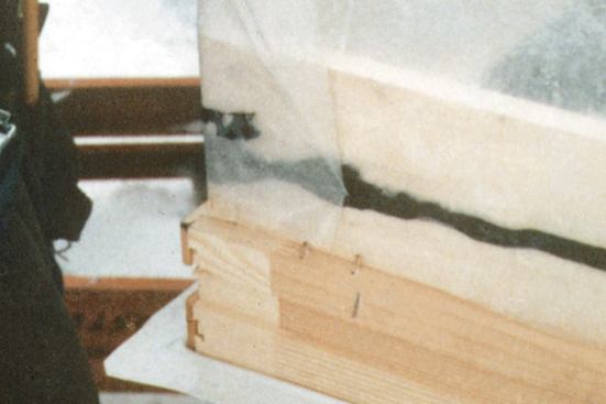

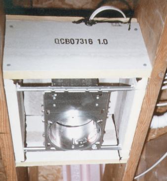

Ceiling-mounted electrical boxes. I stopped using commercially available “airtight” recessed can fixtures when blower-door testing showed that they leak like sieves. Now I use standard recessed can fixtures and install them in a site-built foam box made from scraps of 1-inch or 2-inch rigid foam with seams sealed with tape or Tremco. I size these boxes to provide at least 2 inches of free air space on all sides of the recessed fixture. We seal the ceiling poly to the edge of the foam box with Tremco. In the attic, we blow 22 inches of cellulose over the top of the box. We have never had a light fixture overheat using this system.

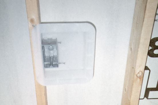

Another way to keep ceiling-mounted electrical boxes from penetrating the poly air barrier is to frame a secondary ceiling below the poly. A closet ceiling or the ceiling above a tub-shower unit can often be lowered to 7 feet or 7 feet 6 inches.
