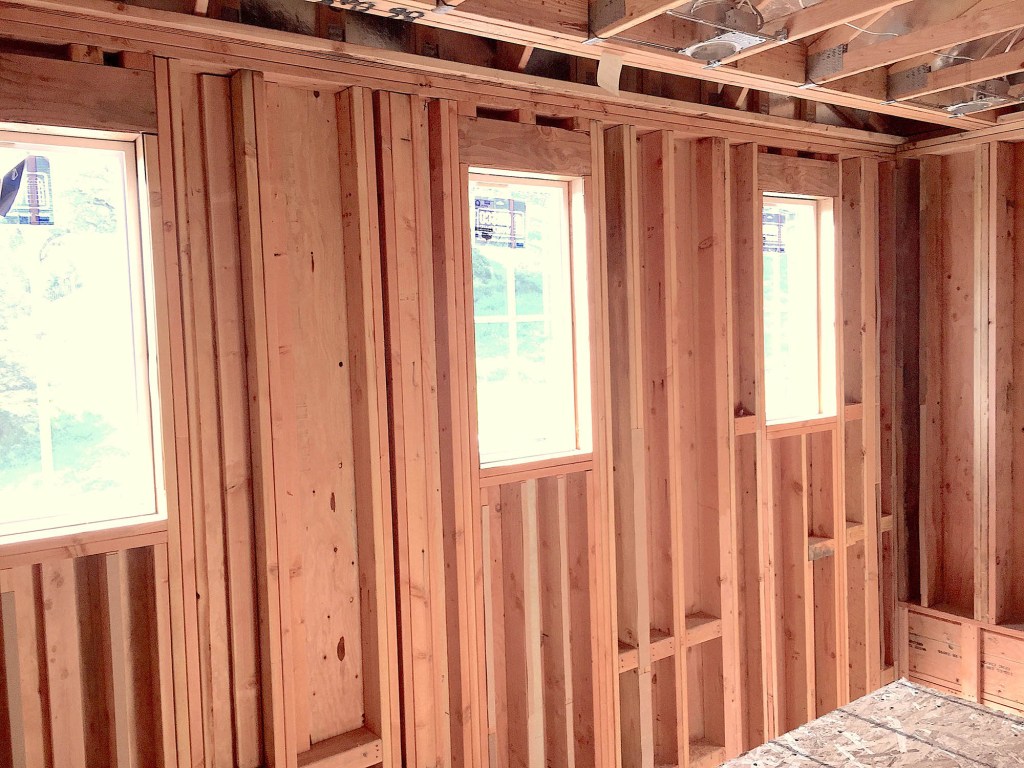

Over-framed walls like this lose a substantial amount of energy via thermal bridging. Exterior foam insulation overcomes much of this loss.
Steve Easley Over-framed walls like this lose a substantial amount of energy via thermal bridging. Exterior foam insulation overcomes much of this loss.
Continuous exterior insulation has advantages. First of all, it substantially increases the true R-value of walls at a fairly low cost. For example, adding one inch of R-5 exterior insulation raises the real (whole wall) R-value of a 2x4 wall with R-13 cavity insulation from just R-10.7 to R-16. Second, most homes have framing factors of 25% (meaning that the true R-value of 25% of the windowless walls is the R-value of the wood, or R-3.5). Exterior insulation reduces thermal bridging across the wall through framing members, and it keeps the sheathing warmer (which reduces the risk of condensation and mold growth on the sheathing).

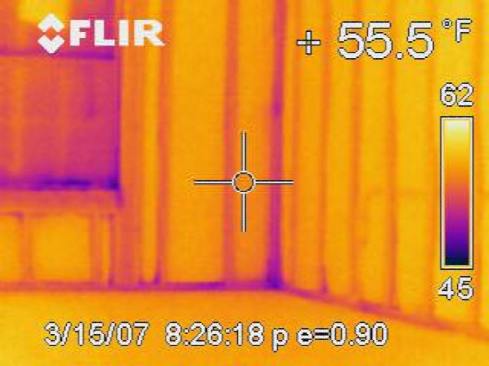

This infrared image shows the cold studs in a heated house on a winter day. Exterior foam insulation could prevent this source of heat loss.

Melted lines on a frosty wall show the heat passing through the wall at stud locations. Exterior foam insulation would make a difference.

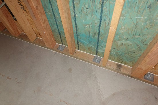

Good air-sealing becomes critical when walls are vapor-closed to the outside. Here, a builder did it right, as they have caulked the sheathing joint to the wall plate and the plate to the floor. (Yes, you need to do both.)
Steve Easley Good air-sealing becomes critical when walls are vapor-closed to the outside. Here, a builder did it right, as they have caulked the sheathing joint to the wall plate and the plate to the floor. (Yes, you need to do both.)
The good news is that because exterior insulation is outboard of the sheathing, that sheathing stays warmer. Warmer sheathing surface temperatures mean lower surface relative humidity, so the sheathing is less likely to dampen to the point that it reaches the threshold for mold growth. Even so, when you apply impermeable foam insulation to the outside of a building, you need to be fastidious about air-sealing before the insulation is installed so that air currents across the wall are minimized. (For more on this, see "Practical Air Sealing," Aug/18). In addition, it’s critical that the home is watertight before the cladding is installed.

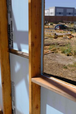

Here, foam insulation has been applied directly to the studs, with sheathing applied outboard of that.
Steve Easley Here, foam insulation has been applied directly to the studs, with sheathing applied outboard of that.
One option is to install the foam board first, then sheathe over it. That lets the sheathing dry to the outside. But if you build in a location where higher levels of wall bracing or shear walls are required, you’ll want to check with an engineer to make sure that the shear capacity of your sheathing is adequate. When sheathing is held away from the studs by insulation, its ability to resist racking forces is reduced.
