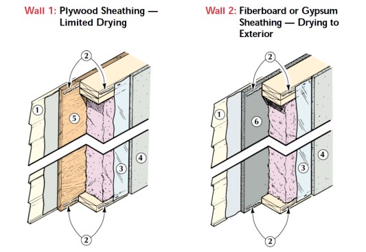

Both Walls:
  • The rain screen principle controls rain penetration when vinyl or aluminum siding is used. Building paper controls rain absorption into the sheathing. 1
  • Air movement is controlled with an air-flow retarder formed by using caulk to seal the exterior sheathing and the polyethylene on the interior to the framing. 2
  • The polyethylene sheet placed beneath the gypsum board acts as a vapor diffusion retarder. 3
  • Any paint or wall covering (permeable or impermeable) may be used. 4
Wall 1:
  • Uses impermeable, noninsulating sheathing (plywood or OSB). 5
  • Drying of the wall is limited, so framing and insulation materials should be dry at installation or permitted to dry before enclosure.
  • Also suitable for wood siding, using the barrier approach, in which all openings are sealed. (An alternative to the barrier approach is to use wedges or oval-head nails to allow air to move between pieces of siding, or to install the siding over furring.) All materials must be dry, and the siding must be back-primed and fastened according to the manufacturer’s recommendations.
Wall 2:
  • Sheathed with permeable asphalt-impregnated fiberboard or gypsum. 6
  • Drying is to the exterior

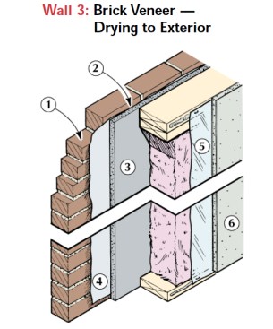

  • Brick veneer covers wood-frame wall. 1
  • A 1-inch air space between the brick and the woodframe assembly is a receptor for capillary moisture and absorbed moisture driven inward by solar radiation. 2
  • Drying is to the exterior, through permeable noninsulating sheathing. 3
  • The building paper must be continuous and well-fastened to prevent wind action from “pumping” moisture to the interior. 4
  • The poly sheet on the interior acts as vapor diffusion retarder. 5
  • Any interior finish (permeable or impermeable) may be used. 6

With a brick veneer (Wall 3), form the rain screen by creating a minimum 1-inch air space between the brick and tight fiberboard or gypsum sheathing. To allow inward air movement to equalize pressure, this air space must be clear of mortar droppings and should be open at the top; leaving open every other vertical mortar joint in the first course of brick at the base also lets in air, and provides weep holes for drainage as well. If you use a continuous layer of building paper to further tighten the sheathing, be sure to fasten it extensively to prevent flexing under wind action, which could pump moisture into the assembly.
To direct cavity moisture to the exterior through the weep holes, extend flashing at the base of the brick to the back of the rain screen cavity and place it behind the sheathing or building paper. Careful installation of flashing over window and door openings is also critical in all rain screen assemblies. Ideally, the flashing should be tucked behind the sheathing or building paper to direct rainwater to the exterior of the assembly.

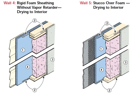

Both Walls:
  • Impermeable rigid insulation used as sheathing acts as a vapor diffusion retarder for vapor entering from the exterior during cooling periods. This limits potential condensation by raising the wall cavity temperature. Building paper is not needed, since the rigid insulation controls rain absorption and capillary suction. 1
  • Air movement is controlled with air-flow retarders formed by sealing the exterior sheathing and the interior gypsum board to the framing. 2
  • Permeable latex paint on the gypsum board permits interior vapor to enter the wall and then dry to the interior. No vapor diffusion retarder is needed on the inside of the wall. 3
  • Drying depends on several factors: 2×4 wall construction.
  • Interior relative humidity must not exceed 35% at 70°F during heating periods.
  • Cavity insulation must be limited to R-11, while the rigid insulation must be at least R-7. 4
Wall 4:
  • Rain screen principle controls rain penetration.
Wall 5:
  • Barrier approach controls rain penetration.
  • Exterior cladding is stucco over galvanized lath, applied over rigid foam sheathing. 5

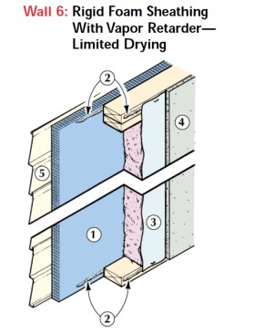

  • Impermeable rigid insulation used as sheathing acts as a vapor diffusion retarder for vapor entering from the exterior during cooling periods. The sheathing also controls rain absorption, and eliminates the need for building paper. 1
  • To control air movement, the exterior sheathing and the interior gypsum board are sealed to the framing to form air-flow retarders. 2
  • Insulating sheathing raises the wall cavity temperature and limits potential condensation.
  • The facing material on the cavity insulation acts as a vapor diffusion retarder on the interior. 3
  • Drying is limited, so framing and insulation materials should be dry or permitted to dry before they are enclosed.
  • Any interior surface finishes (permeable or impermeable) may be used. 4
  • Vinyl, aluminum, or wood-based siding may be used.
  • With wood-based siding, all materials should be dry during installation, and the siding should be back-primed and fastened according to manufacturer’s recommendation. 5
