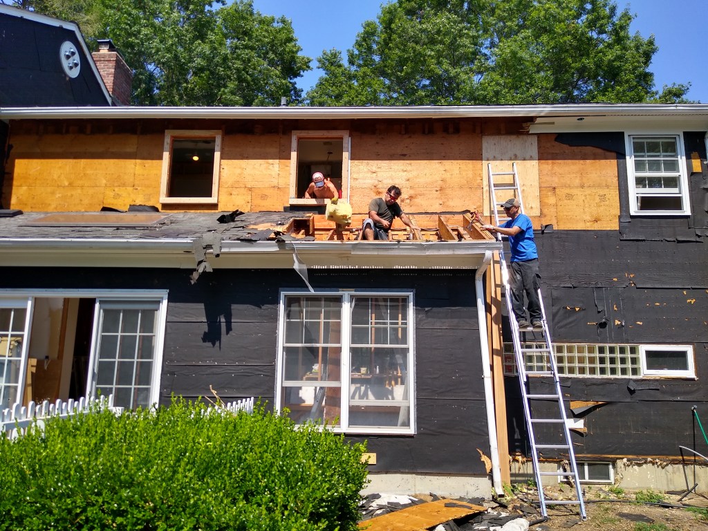

However, this was not a typical renovation. Part of the budget had been directed at a deep energy retrofit. We were contracted to move insulation from ceiling joists to roof rafters and add a sweater of continuous exterior insulation with high-performance windows and doors and extended eaves. The job also included ventilation systems, pressure-balanced rainscreens, air-sealing, air-sealing, and more air-sealing. My growing giddiness at the inspector’s request came from being able to justify the cost of a blower-door test; I was itching to confirm how well we had sealed this 1977, hilltop sieve.

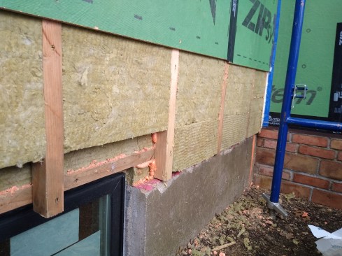

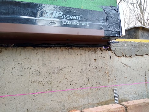

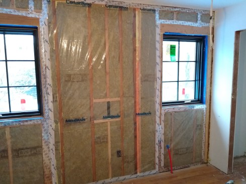

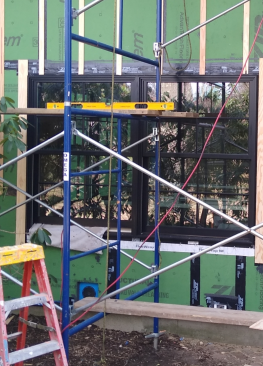

Liquid sealants and foam sealants. On this project, we used six products: On exterior nail holes, between sheet goods, and at wall-to-masonry transitions, we used Zip Liquid Flash, mostly in the 20-ounce sausage format. Around windows and doors, we used Henry Moistop Sealant (also available in the 20-ounce format). On framing penetrations like rafter tails and on interior framing bays and voids, Sashco Big Stretch and Dap Extreme Stretch did the job. For interior pipe and electrical penetrations, we used 3M Fire Barrier Sealant. Under sill plates on newly framed or repaired areas, we used Auralex StopGap Acoustical Sealant. We also leaned on low- and high-expansion foam sealants to fill large gaps before applying a waterproof seal.

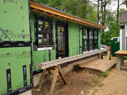

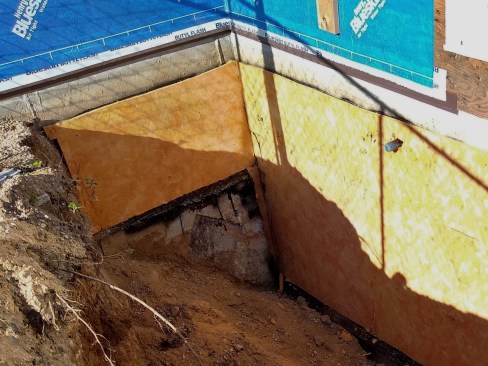

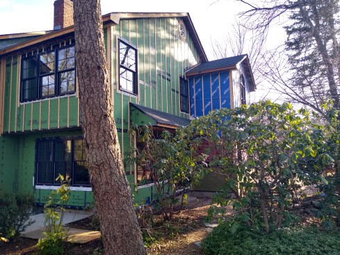

Weather-resistive barrier. Henry Blueskin VP 100 Self-Adhered Water Resistive Air Barrier Membrane. We used VP100, as it is waterproof and vapor open; much of the home needed to dry to the outside as tile, wallpaper, and millwork covered large portions of the interior. A peel-and-stick WRB, like Henry Blueskin, was ideal for steadfastly bonding irregular surfaces that the old house shell presented, where a staple-up WRB would be sloppy and hard to detail. Another desirable aspect of the Blueskin is the fact that fasteners self-seal when penetrating it. Our rainscreen install did not compromise the air/water-sealing strength of Henry Blueskin. Local availability was another factor: Henry products are a system with components like primer, caulk, and sealing tapes. Being able to dip into local stock is important.
Weather-barrier tapes including Blueskin WB, Vycor Plus, Zip Tape, and DuPont FlexWrap NF. We found that all these tapes adhered extremely well to the Henry Blueskin. We stayed with Zip Tape on the areas with Zip Sheathing, except the window sill pan—there we used a piece of clapboard siding to induce a slight pitch, over which we used Dupont FlexWrap NF. This is my go-to sill product, and it adhered extremely well to both the Zip and the Henry Blueskin. FlexWrap stays slightly wrinkled, allowing drainage channels under the lower flange of doors and windows.
The photos and captions in the slideshow above highlight the critical steps of bringing this home from a leaky sieve to 1.2 ACH50 (the building code requires 3 ACH50). The HERS inspector had never seen a home without an envelope of spray foam do so well. Though I wish we had done a blower door test on the front end of the project and knew the extent of the improvement, it’s great that the inspector gave us the imperative to test out, verifying that we had a tight shell in which to build the rest of the systems for this deep energy retrofit.
