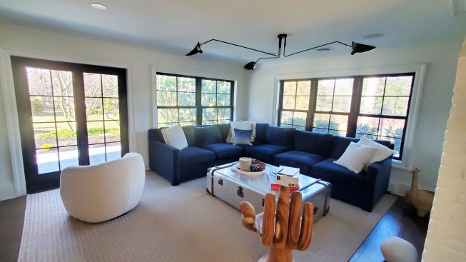

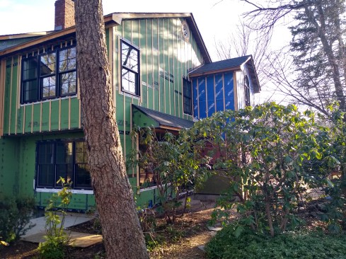

The project's new design included 50 double-hung, four casement, and three fixed arch-top windows, three entry doors, three sliding patio doors, and one massive double entry with sidelights.

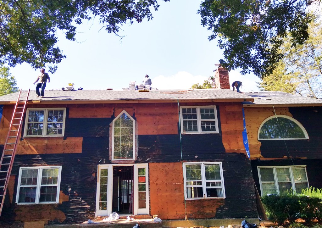

On the project we began coverage of in “Deep Energy Retrofit: Air Sealing” (Mar/23), we were aiming for efficiency within the boundaries of geometry, aesthetics, and budget. The owners had their preferences and the village architectural review board had to approve their desired look and materials. The nearly 5,000 square feet required 50 double-hungs, four casements, three fixed arch-top windows, three entry doors, three sliding patio doors, and one massive double entry with sidelights. A ton of glass, and a ton of potential air leaks.

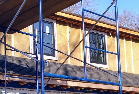

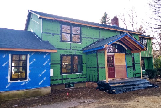

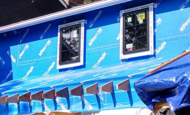

These Weather Shield Signature double-hung windows are integrated with the proper tape for the application—Zip Tape on the right and Blueskin WB Tape on the left. You can see the DuPont FlexWrap NF peeking out under the lower flanges.

In my area, the framers generally install the doors and windows. On my jobs, however, even if a framer is involved, my crew always handles the door and window installation, to avoid what Hauser has experienced. “Builders generally sub out their window install to the framers. They are aiming for speed and cost,” he says. “We often find no back caulk, improper flashing, no shims, and roofing nails that are too short. This is also true for the high-end market. We try to inform the client directly how the windows should be installed at the front-end.” Installation is what I have control over, and this is where we make certain the only shortcomings of a door and window are built-in, not induced by installation negligence.
Before installing the windows and doors, I watched the manufacturer’s installation training video and asked my rep a few questions. There was nothing dramatically different from any flanged window installation. I did bend up and braze a few lead-coated copper drip caps for a few of the single windows that may see rain; the doubles and triples came assembled with an integral drip cap.
To promote drainage, we made all the rough openings 3/8 inch taller than the call-out to accommodate a piece of cedar clapboard wrapped with Tyvek FlexWrap NF. We glued and stapled the clapboard to the sill framing, then wrapped it with the FlexWrap. This allowed us to make a continuous sill pan going about 6 inches up the sides. The rippled texture of FlexWrap is a built-in drainage plane; if water intrudes, it can drip under the lower flange and out. Smoother stretch tapes also work for sill-pan applications but require plastic shims to be installed under the lower flange to allow water intrusion to rectify to the outside. On rigid, aluminum-clad windows, I found the rippled tape reduces the need to worry about an extra step.
On the exterior, we used Henry Moistop Sealant on the upper and side flanges; on the bottom flange, only the nail holes were given a dab of sealant, allowing an opening for water drainage. After plumb and level was established and any shims added to support the bottom of the window, we filled every nail hole, making sure the roofing nails penetrated into the framing a minimum of 1 1/2 inches. Top and side flanges were detailed with a weather barrier tape.

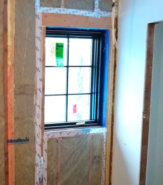

We used a closed-cell-polyethylene foam backer rod and caulk to seal the units from the inside. I have often seen insulation companies using low-expanding foam (not on my jobs), but this is not best practice, and I have also seen a lot of voids and failures. A flexible caulk is most effective and most commonly recommended by window manufacturers. On this project, we used Sashco Big Stretch and DAP Extreme Stretch. Sealing the window on the interior—the conditioned side of the window, protected from ultraviolet light and harsh weather extremes—allows the seal to last the life of the unit. After sealing the windows and doors and allowing the caulk to dry, I did a quick inspection, adding sealant if needed. Later, as we prepped for trim, we adhered the extension jambs with DAP Big Stretch and filled the void between the jamb and framing with low-expanding foam, further blocking leaks and adding R-value.
Impeccability in the installation of door and window units is more critical than in the air-sealing process for opaque walls. I made certain to remain involved with every unit’s install, as this is the most critical step in keeping a home airtight. Once we had established process and installed a few units, we gained momentum and moved quickly with prep through install. Every manufacturer and style window may have a different installation process, so I always check the resources available before any install. Even a great window, improperly installed, can lead to poor performance. I now also make sure to look at a sample window if a client has locked in a specific brand that I am not familiar with. This extra effort allows me to see if there are any obvious design flaws that need extra attention during install. I then research installation process and pitfalls; the internet is an amazing tool for learning from others’ mistakes.
