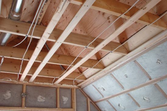

Our walls and ceilings are insulated with blown cellulose. There are no settling problems with cellulose as long as it’s installed to the proper density. We handle vapor diffusion by using vapor-retarder paint on the interior walls.

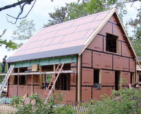

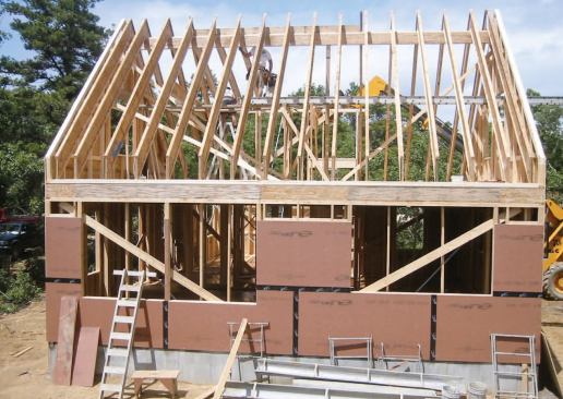

Good air-sealing is crucial for a high-performance home. These homes have a fully delineated air-sealing path from the foundation slab to the roof ridge. It includes gasketing at the base of the sheathing and spray foam around windows and doors, but for the most part the air barrier is provided by the Zip System, which consists of 4×8 sheathing panels with specially designed protective tape to seal the joints. You simply install the panels, tape the seams, and you’re done. Our carpenters really like this sheathing. It installs like plywood or OSB and is an excellent air barrier when the seams are taped. We have used it on every home we’ve built in the last four years.

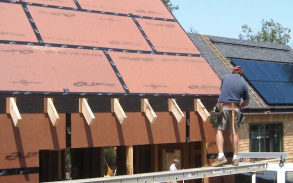

The key to getting the most from this approach is to make sure there are no interruptions in the air barrier. We do this by framing each home without overhangs at the soffits or rakes. After the Zip sheathing is in place, we have a sealed box with no protrusions. We then apply the overhangs. This adds time to the framing process, but the result is a very tight air barrier.
Note that at the roof, the air barrier is the outer surface of the roof sheathing. These homes are designed and built with “hot” roofs – that is, there is no structural ventilation. In our experience, good insulation and air-sealing will keep excessive heat and moisture out of the roof system, so there’s no need for vents. In fact, we’ve used this roof system for 30 years; it wasn’t part of the code until recently, but long ago we convinced our local building inspectors of its effectiveness. We have never had performance or moisture problems with hot roofs.

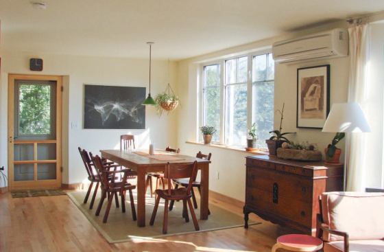

Heating and cooling are provided by a Daikin RXS24DVJU single-zone air source heat pump. It’s a ductless split system with an outdoor compressor and a single indoor unit. A conventional home would be more likely to use a three- or four-zone model with indoor units in each bedroom, but these small, high-performance homes can be conditioned with a single indoor unit.
Installing one indoor unit instead of three or four provided enough savings to offset the cost of the HRV. Natural convection is sufficient to carry heat to all the house’s rooms, unless the occupants turn the heat way down or keep doors closed. In these homes, we addressed those situations by installing electric radiant ceiling panels for supplemental heat in the bedrooms. Based on past experience, we expect that some homeowners will never use these radiant panels.
