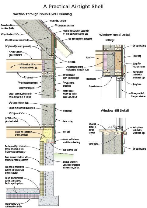

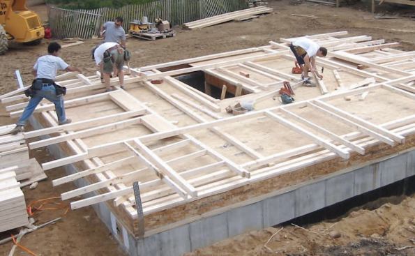

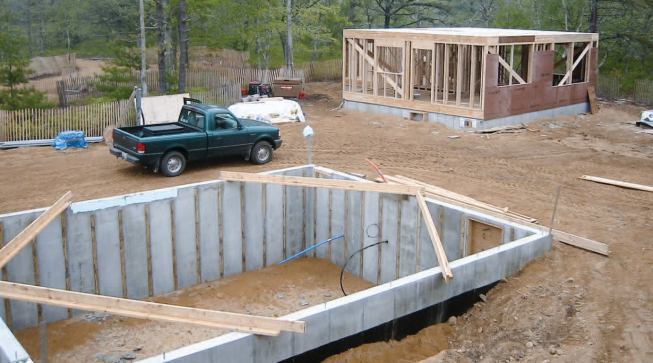

Like most homes in our area, these have poured concrete foundations and full basements, but the construction and insulation methods are different. Customarily, fiberglass batts are stuffed between the first-floor joists, and the foundation walls are left bare; this results in poor insulation and air-sealing and creates a damp basement that’s prone to mold and mildew and requires the use of a dehumidifier all summer.
We use 3 inches of foil-faced polyisocyanurate rigid foam on the inside of the foundation walls and 4 inches of extruded polystyrene beneath the slab, creating what one of our crew refers to as “an R-20 bathtub.” (In more recent projects, we’ve used Type 9 expanded polystyrene under the slab, because its global-warming contribution is a fraction of that of extruded polystyrene, due to the blowing agent used during its manufacture.)
To hold the wall insulation in place, we fasten dovetail-shaped 2-by battens to the inside of the foundation forms, spacing them at 2 feet on-center. The beveled edges hold the pressure-treated battens securely in the concrete after the forms are removed. The rigid foam is fastened to the battens with screws and Plasti-Grip washers.
The ground moisture barrier consists of Tu-Tuff plastic sheeting (Sto-Cote Products, 800/435-2621) installed on top of the polystyrene before the slab is placed. The wall insulation is installed before the slab is poured, creating an uninterrupted insulation plane and air barrier in the basement. At the top of the foundation wall, sill seal and gaskets connect the top of the foam to the framed wall’s air barrier.
Double-Wall Framing
After years of experimentation with a variety of approaches, we have settled on cost-effective wall and roof assemblies that meet our insulation standards (R-31 walls and R-49 roofs) and minimize thermal bridging – and that our carpenters and other tradespeople are comfortable with.

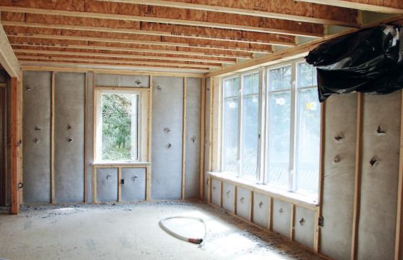

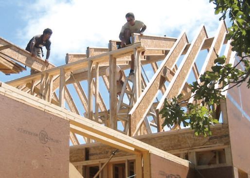

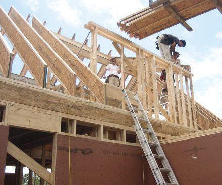

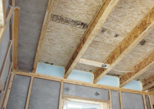

We use double 2×4 walls with a 2 1/2-inch space between the inner and outer walls, and 14-inch wood I-joist rafters. Everything is framed 2 feet on-center. The double walls minimize thermal bridging because of the space in the middle, and the I-joists do so because their webs are so thin. The sheathing and air barrier are provided by 5/8-inch-thick Zip System panels (Huber Engineered Wood, www.huberwood.com).

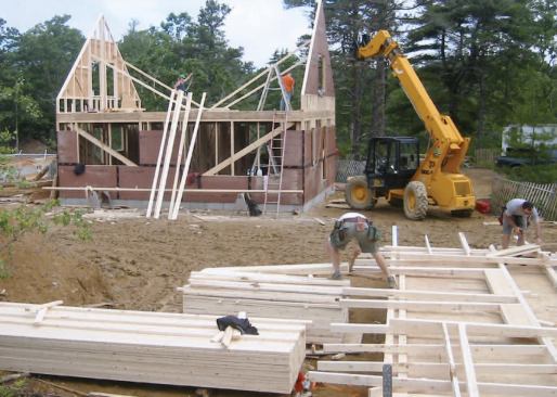

Our framers speed up the process and reduce job-site waste by having the supplier precut all studs, joists, and rafters – including the plumb cuts. This also reduces overall material use, as the lumber company uses the smallest amount of stock possible to get the lengths needed.
There are some details to consider with double-wall framing. For example, if you frame square openings around deep windows, you decrease the amount of light getting into the room. We solve this by splaying the sides of the openings at 45 degrees. Rather than trying to put trim around the entire opening, we install wood sills before installing the drywall, which is finished to the window jambs. When the drywallers are finished, so is the opening.
Another issue is how to make a secure, stiff connection between the inner and outer walls. We do it by aligning the studs in both walls and nailing the bottom plates in place, then adding plywood gussets to the sides of every other pair of studs near the top of the wall.
