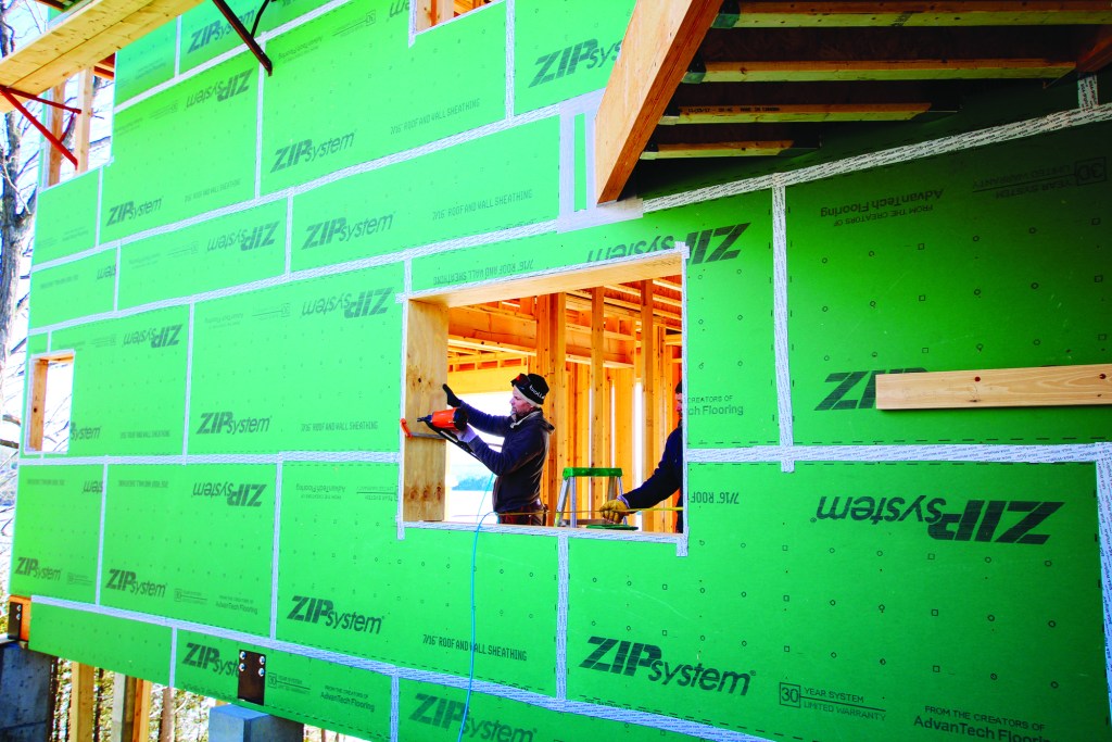

The OSB-sheathed double stud wall had limited drying in the outward direction, and in this cold climate, posed a risk of condensation.

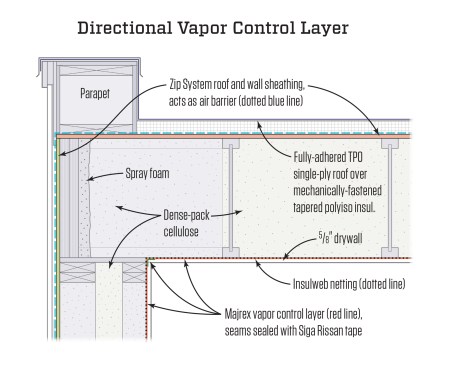

The double stud walls, sheathed with Zip System OSB panels, are 13 inches thick, and the unvented low-slope roof is framed with 18-inch-deep wood I-joists. Wall and roof cavities are both insulated with dense-blown cellulose. The roof also has another 1 to 4 inches of polyiso under the TPO membrane roofing.
In this example, where outward drying is constrained (especially for the roof), we’ve chosen to set up reliable drying to the interior. To do this, we installed Majrex directional vapor barrier membrane on the walls and ceilings, with the directional drying face pointed toward the interior.

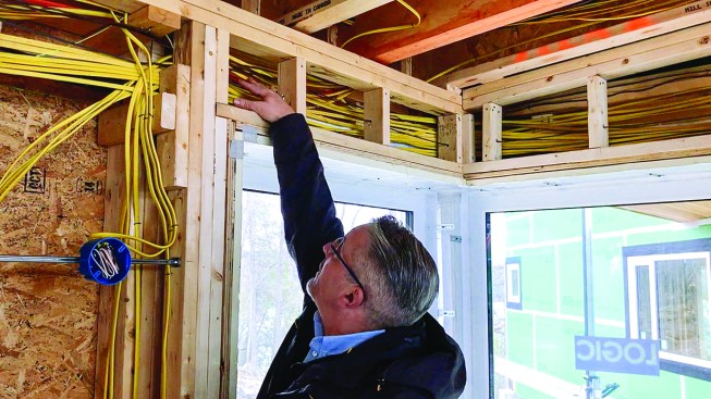

Some of the external wall cavities were cluttered with wiring, meaning that a careful (and inspectable) insulation job was critical to performance.

The Directional Vapor Control Layer
For this application, we needed a variable vapor control material that permits good inward drying in summer, but slows the outward vapor drive in winter. Either Intello (from ProClima) or Majrex (from Siga) will perform in this way, as will MemBrain (from CertainTeed). For this project, we chose Majrex.

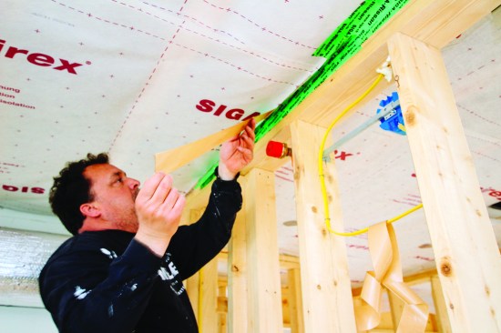

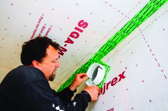

Carefully installed, Majrex controls vapor diffusion as well as air transport of moisture, but it’s only as good as the installation details. With any moisture-control strategy, it’s critical to control both air transport and diffusion of vapor, and to avoid discontinuities in the materials. The good vapor control achieved by this fabric could be compromised if we allowed air-driven moisture to bypass the control membrane. So we covered every inch of the interior, and we were careful to tape-seal around every outlet, every light fixture, and every penetration of any kind, as well as along the floor and the ceiling.

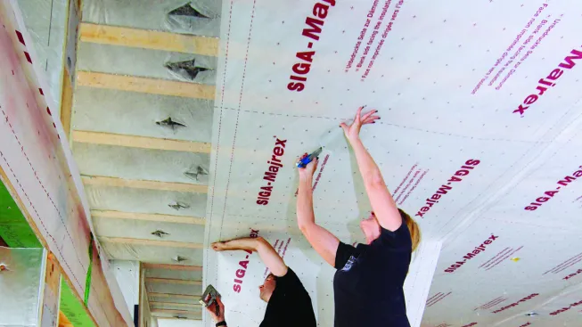

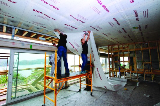

The crew stapled up directional vapor barrier material after the cavities were blown with insulation.

Care was taken to seal all the seams at wall-to-ceiling intersections ...
Care was taken to seal all the seams at wall-to-ceiling intersections …
... as well as around fixtures and wall penetrations.
… as well as around fixtures and wall penetrations.
