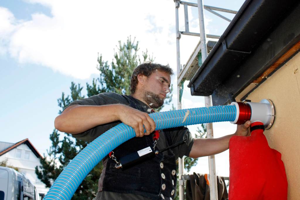

This photo from German equipment maker X-Floc shows the company's dry injection system for cellulose insulation in action. The back-pressure relief valve allows air to escape so that insulation can be uniformly delivered and compacted, while the red filter bag contains dust.

But what if those approaches are too complicated, or not feasible? German manufacturer X-Floc, a supplier of cellulose blowing equipment, has a solution: a cellulose injection head with its own air-pressure relief outlet, built into the nozzle at the end of the hose, complete with filter bag to keep the living space dust-free during the operation. With this adapter, you can get good, uniform insulation density even in a tightly sealed cavity.
Energy consultant Peter Yost got a chance to put the equipment through its paces in a demonstration setup at the shop facilities of American Installations, a full-service insulation firm based in western Massachusetts. “The built-in passive ventilation for the cavity gives you the ability to handle the air that is being expelled from the cavity, and it provides a more uniform product,” American Installations partner Wes Couture told Yost.
Yost posted his observations and some demonstration videos on the BuildingGreen website (see: “Installing Insulation With the X-Floc Ventilated Dry Injection System,” by Peter Yost). “The demonstrations show how the X-Floc dry injection system achieves a uniform cavity fill with cellulose,” wrote Yost. “Does the way the insulation fines fill cracks mean that the wall insulated with this installation system achieves significantly greater airtightness? I think the answer to that question depends on the results of future air leakage testing.”
