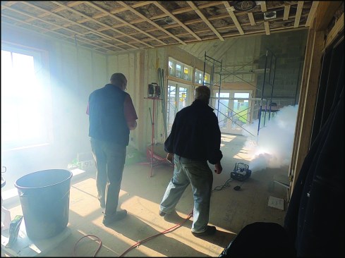

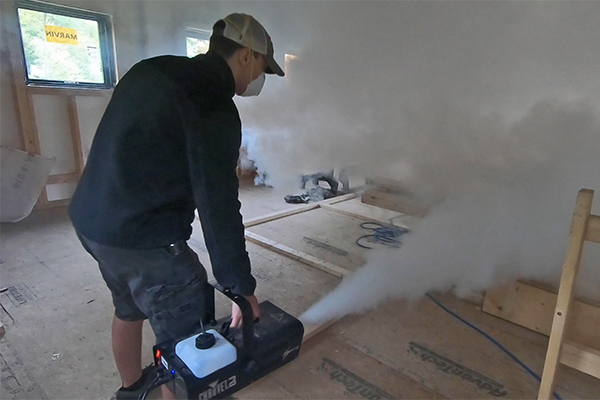

To begin a “smoke check,” the authors fill a home with dense fog produced by a high-volume theatrical fog machine.

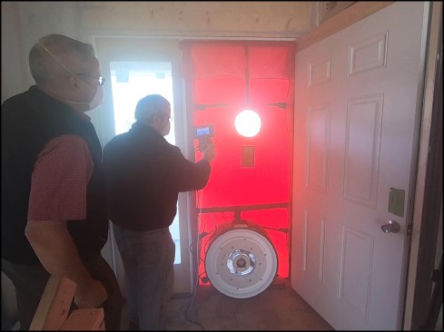

To perform smoke checks, we use a theatrical fog machine. We first fog a home’s interior, then set up a Minneapolis Blower Door to pressurize the home and push the fog to the exterior through any open seams or gaps. This pressure test helps locate what we refer to as “areas of opportunity”—a last chance to easily tighten up the home’s air barrier prior to drywalling and installing the exterior cladding. Putting the effort in to track these down can often add up to hundreds of cfm worth of leakage reduction. (See the video, below.)

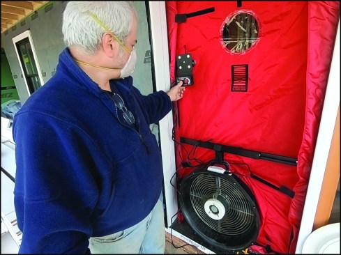

With the blower-door fan blowing inwards, co-author Chris West starts to pressurize the home, pushing the fog to the exterior.

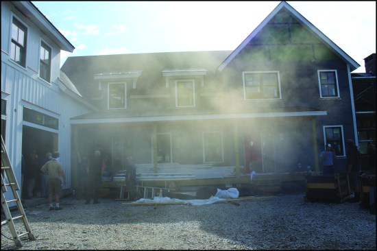

Starting out, we set up the blower-door assembly with the fan oriented to blow inwards. We then filled the entire home with “smoke” using a high-volume theatrical fog machine. The machine burns a special fluid to create the fog, which is innocuous but has a faint odor. It took about 20 minutes to fill the entire 4,500-square-foot home. We then pressurized the house with the blower door to push the fog out through the home’s primary air barrier and inspected the home’s exterior perimeter for air leakage.

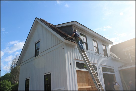

With the building pressurized, fog could be seen escaping from two doghouse dormers at their roof-to-wall junctures.

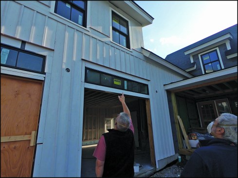

We could see smoke coming out a pair of second-floor doghouse dormers along the rake edges of their roofs. Dormers are somewhat notorious; because they are framed above the roofline, they are difficult to air-seal and small air leaks are common. More noticeable was the smoke emanating from the double-hung windows located at the second-floor living space above the garage (double-hungs are known to be less airtight than casements or European tilt-and-turns). The three windows were identical, but one of them was leaking more than the other two. The builder’s crew broke out their ladders and determined the smoke was leaking from around the window’s frame and not from its taped-off flanges. The window manufacturer was notified about the leaky unit.
Co-author Jim Bradley points to smoke leaking from double-hung windows in living space above the garage.
After checking the window openings and dormer framing, workers determined that the window units themselves were leaking.
Blower door test. With the smoke check completed, we can turn the fan around and depressurize the house to find our baseline ACH rating numbers for the client, which turned out to be 1 ACH50, well under the code maximum airflow of 3 ACH50, negating the need for another test.
With the smoke test completed, the authors depressurized the home and performed a blower door test.

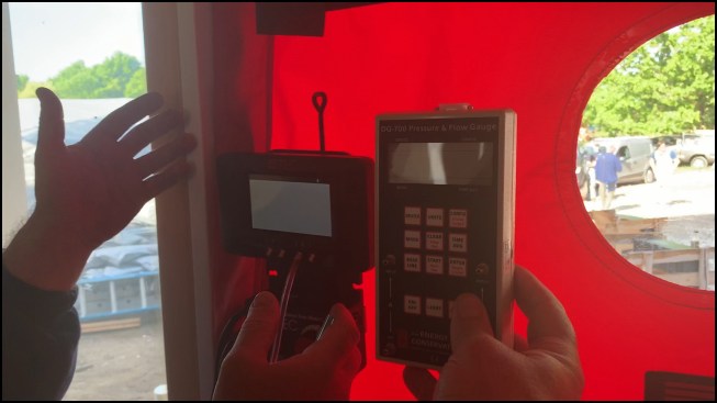

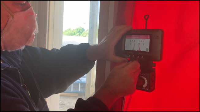

As an aside, we now use a TEC DG-1000 Pressure and Flow Gauge manufactured by The Energy Conservatory to calculate a home’s ACH rate. We’ve found its new DG-1000 manometer much more intuitive than its old workhorse DG 700 model. A high-resolution touchscreen graphically shows you such items as what size rings you need on the blower door fan, and what pressure taps to hook the red and green diagnostic tubing to, depending on the airflow-measuring task. TEC also has an app available that enables you to sync your smartphone to the manometer, which allows you to operate the DG-1000 remotely—it’s a big step up from the older model.
The authors used a new TEC DG-1000 manometer—here compared with an older DG 700 manometer—for the blower door test.
The DG 1000 is much more intuitive, graphically showing where to connect red and green diagnostic tubing.
