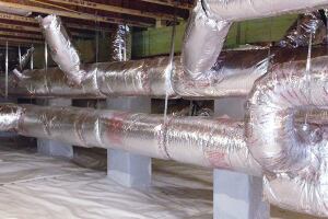

Most crawlspaces are vented to the outdoors, but over the past decade, encapsulating the crawlspace (as shown in the first photo) has gained favor among builders of green and energy-efficient homes. It’s often seen as the best way to eliminate the moisture problems that can result from vented crawlspaces. But what do you do about the air down there?

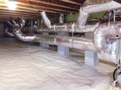

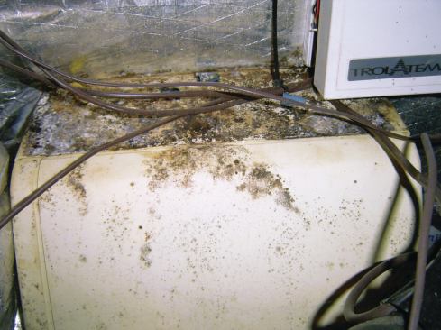

Slideshow photo #3 was taken at a house that was only a year or two old. Although the home builder had installed closed-cell spray foam insulation in all of the above-grade walls and in the attic, he left the crawlspace vented to the outside. The result was mold growing on the HVAC system.
Conclusion: Unless you’re in a dry climate, venting the crawlspace to the outside is your worst option. It is absolutely your worst option in humid climates. And it’s probably also the worst option in most climates if the HVAC systems and ductwork are located in the crawlspace.

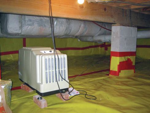

4. Install a dehumidifier
In this method, you use a standalone dehumidifier for the crawlspace. (Again, we’re talking here about encapsulated crawlspaces only; although some people try to do it, you can’t dehumidify the whole outdoors.) This method is controlled by the conditions in the crawlspace, not in the house above, so it will do the best job of keeping the crawlspace dry.
Brad Brinke of The Crawlspace Co., in Virginia Beach, Va., responded to my question about this topic on the Energy Vanguard Facebook page: “We have a very good track record with the dehumidifier here in Virginia. We install a humidistat and fan system to help the dehumidifier operate efficiently. We tried using supply air from the home and it did not work.”
If you want dry air in your crawlspace, a dehumidifier is the way to go. Yes, they do have drawbacks: You have to buy additional equipment; they require maintenance; and if the drain fails, you may have a bulk water problem in the crawlspace.
If it’s a small crawlspace, a standard dehumidifier that you can buy for $200 to $300 may be sufficient. For medium to large crawlspaces, however, it’s best to go with a more robust model, such as the ones made by Therma-Stor. The company’s “Santa Fe” line (see photo, BB PLS LOCATE) is made for basements and crawlspaces.
Conclusion: Although more expensive, installing a dehumidifier is the best method for treating the air in an encapsulated crawlspace.
