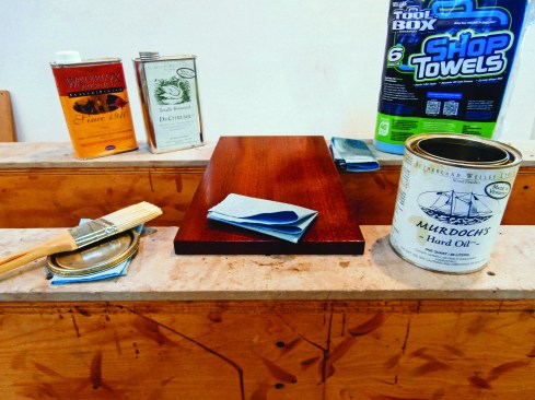

For applying all oil finishes, he brushes on a thick coat, lets it soak in for several minutes, and then rubs it out with blue shop towels, which don’t leave annoying lint behind.

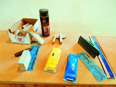

I do my hand sanding with colored rubber blocks sold under the name “Preppin Weapon” (Time Shaver Tools; timeshavertools.com). They are available online and from supply catalogs. They hold a quarter sheet of paper, using a quick-change clamp that never fails.
For detail work (for example, getting into tight corners of a profile or rabbet), I spray the back of a sheet of sandpaper with a multipurpose adhesive and stick it to a block of wood or MDF. I trim the edges flush with a utility knife.

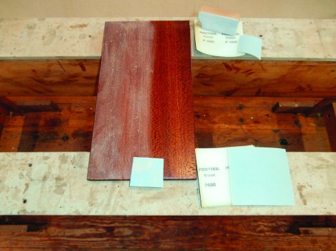

I use foam-backed 400-grit and 600-grit pads for sanding between coats of finish. This sanding is done by hand and should be done with a soft touch. That allows me to catch any small defects; it is a quality-control step that also prepares the surface for the next coat.

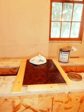

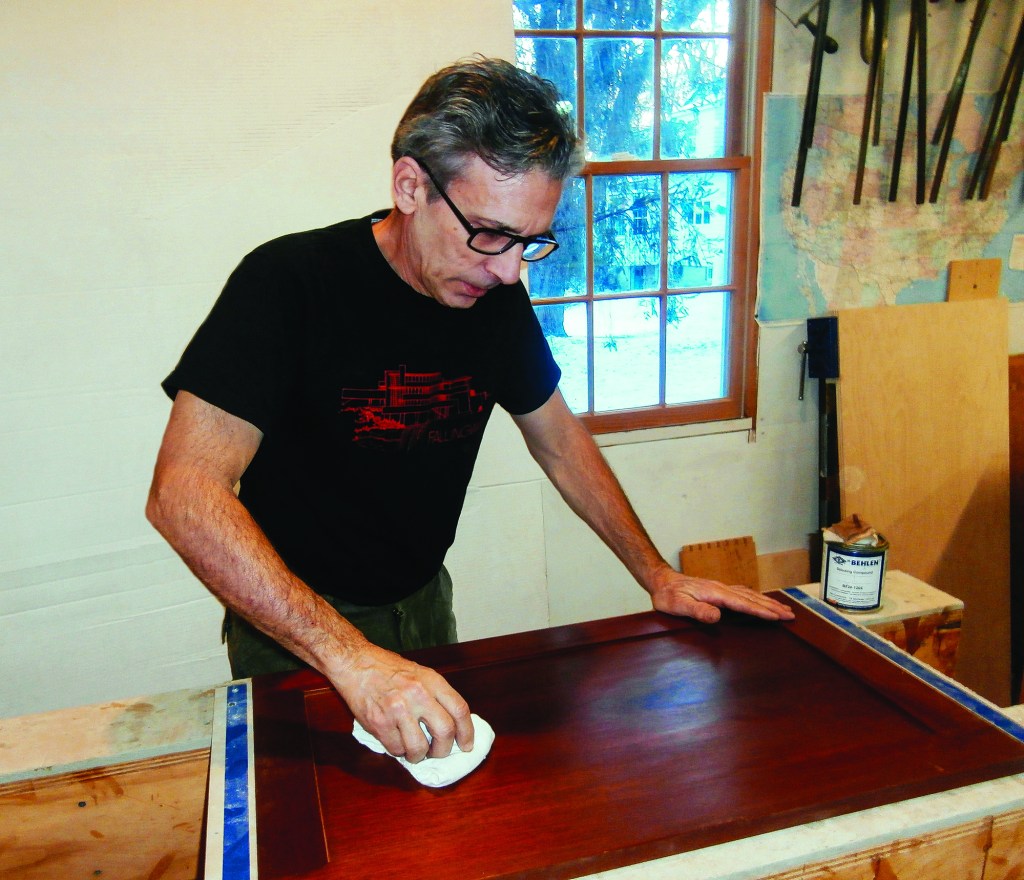

To speed up the filling of open-pore woods, a grain filler can be used. It may seem like a huge, time-consuming step in the finishing process, but it actually ends up saving time. Without it, you’d have to apply multiple coats; and even then, in most open-pore woods, you would not achieve that flat, mirror quality that is the mark of an excellent finish.
Grain filler creates a mirror-like surface reflection because of the extremely fine-ground silica (glass) in the filler. I use Behlen Pore-o-Pac natural filler and add the company’s master color pigments to match my wood. (Woodworker’s Supply is one source for Behlen products.)
Pigmented Behlen filler acts a little bit like a stain, in that as you rub it into the pores, it helps to even out the color. True staining, however, is an entire topic unto itself. Suffice to say here that if you need to stain the wood, you must do it before the filler step. I rarely stain my projects with oil-based pigmented stains. There are other ways to enhance the natural color of some woods with chemicals that react with the natural tannins in the wood. You can find references to these compounds in the books listed at the end of this article.

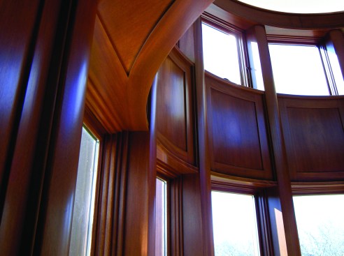

For large panel jobs, or for ceilings and walls done in T&G, try not to fall into the trap of installing all the woodwork first and then sanding, staining, and finishing it. Clearly, it’s easier and faster to work in a shop or in another protected location at ground level rather than trying to stage the area on site.
The panels in my August 2016 article, “Curved Paneling for a Circular Room,” were all filled and finished in my shop. After the install, I only had to fix nicks and scratches and fill nail holes, whereas sanding and finishing a job like that in place would have taken weeks. My goal on most projects is to be on and off the site as quickly as possible.
To achieve the flat, mirror-like sheen that is the mark of an excellent finish, the author filled the open pores of this mahagony with a grain filler before applying four coats of Murdoch’s Hard Oil and then rubbing out with Behlen’s Deluxing Compound. All the woodwork was prefinished before installation on site.

I lean heavily on tung-oil-based finishes for a lot of the work I do. I typically use those produced by Sutherland Welles (sutherlandwelles.com), which has a complete line of polymerized tung-oil finishes. Polymerizing is a cooking process that helps speed up drying. (Most people know about boiled linseed oil, which is similar.) I avoid pure, or raw, oils because the dry time can be a nightmare.
I generally use Murdoch’s Hard Sealer or Murdoch’s Hard Oil; both are from Sunderland Welles, and both are mixtures of tung oil and resin. The nice thing about the Murdoch’s line is that it uses a citrus-based solvent instead of mineral spirits. If you have to finish a room in an existing house, the homeowners will appreciate this citrus base.
Completely read the label directions on any finish you purchase. Sutherland Wells has excellent one-page PDF instruction sheets for all its products.
Waterlox is another brand of oil-resin mix. This one uses a linseed- and tung-oil mix with phenolic resins, and while I don’t use it as often as the Sunderland Welles oils, it performs well. I also use sealer and the oil-urethane top coat made by General. This is the least expensive of the three that I use; it is a good choice when you have large areas to finish on a limited budget.
With all these finishes, you should brush on each coat, wipe it off after letting the oil penetrate for 5 to 15 minutes, and then rub the surface bone dry. For the wiping off and rubbing, I use blue shop towels. They are widely available; I often use the ones made by Sellars, which are sold at Lowe’s. Another brand is Scott’s Paper, which is available on Amazon and from a number of large auto-parts and retail outlets. Blue shop towels are a huge modern improvement because they are lint-free, unlike 100% cotton white t-shirts cut into squares, which is what I used to use.
The great advantage of wiping oils is that you are able to speed up the dry time by rubbing. The surface does not attract dust particles that otherwise would fall to the surface during the dry time. Be aware that wiping oils do not have a flattening agent. If you lay on the final coats without wiping them dry, you get a high sheen. You can cut this sheen using the French polishing techniques to be explained later, but it takes a lot of elbow grease.
Typically, I lay down at least three coats. On surfaces, such as kitchen countertops, that need an extra layer of protection, I suggest brushing a satin tabletop varnish as the final coat over three or four coats of oil.

While preparing sample boards, the author sands between coats of clear finish with foam-back 400- and 600-grit pads (the ones above are from Festool).

On almost all projects, plan on making sample boards to show your clients exactly what they will get. Making them is time-consuming, but it can’t be avoided. I take advantage of these sample preparations to work out any problems with the particular wood I am using, so that I am confident with all the steps required to achieve my final finish. Make notes on the boards. Pick the three best and present them to your client.
