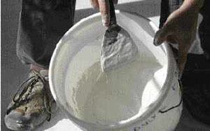

On a small job, I can’t afford to put on a layer of ready-mix joint compound and then wait for it to dry overnight, so I use a powdered setting-type compound for the first two coats. A standard setting-type compound, such as USG’s Durabond (800/874-4968, www.usg.com), is all but impossible to sand; I use the lightweight version, Easy Sand. Despite the name, this compound is nowhere near as easy to sand as the ready-mix variety, so I wipe the joints carefully.
Easy Sand comes in a range of setting times, from five minutes to five hours. I keep a bag each of the 20-minute, 45-minute, and 90-minute versions in my truck. That way, if I just have to patch a hole, I won’t have any downtime between coats; but if I’m finishing the whole room, I won’t have the mud going off in the pan before I’m done.
Strictly speaking, those printed set times are not terribly accurate, because the setting process is temperature-dependent; if you want the compound to cure faster, just use hot water; if you want to extend the working time, spread the mud out flat on a hawk, rather than leaving it packed tightly in a pan. The setting times are, however, a good gauge for when it’s safe to recoat. The mud doesn’t have to be dry enough to sand, just hard enough not to be disturbed by the application of the next coat.
I mix setting compound with cool water in a clean bucket using a D-handle drill and paddle mixer. Adding the powder to the water works better than doing it the other way around.
In my experience, you need just over an inch of water in a 5-gallon bucket to mix a bag of setting compound. I stir the compound until all the lumps are out and the mixture has approximately the same consistency as a thick pancake batter.
