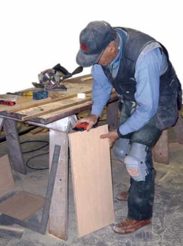

Edging in the field. There are often messy spots where the particleboard core is exposed. This might happen when a piece has to be ripped on site or when a shelf or cleat runs partway across the wall. I handle this by edge-banding the exposed area in the field. Instead of heat-sensitive material that goes on with a heat gun or iron, I use a peel-and-stick edging called Fastedge (FastCap, 888/443-3748, www.fastcap.com). The back is coated with a pressure-sensitive adhesive, which sticks very well and is much easier to apply than traditional edging materials.
The manufacturer also sells a handy pressure roller for pressing peel-and-stick edging onto the surface, and a dual-blade trimmer for cutting it flush to the edge of the melamine. Trimming is necessary because edge bands are wider than the thickness of the material they are designed to edge. These tools make the job so easy to do, there's no reason to ever leave an exposed edge unfinished.
The author uses peel-and-stick vinyl tape to edge areas where the particleboard core is exposed. Here, he uses a dual-blade trimmer to cut the tape flush to the face of a melamine shelf. This trimmer also works on wood veneer edging.
I can buy a 250-foot roll of the maple-pattern Fastedge for approximately 30 cents per foot. Iron-on edging is about a nickel less per foot, but the peel-and-stick is so much easier to use, it trumps any difference in cost.
