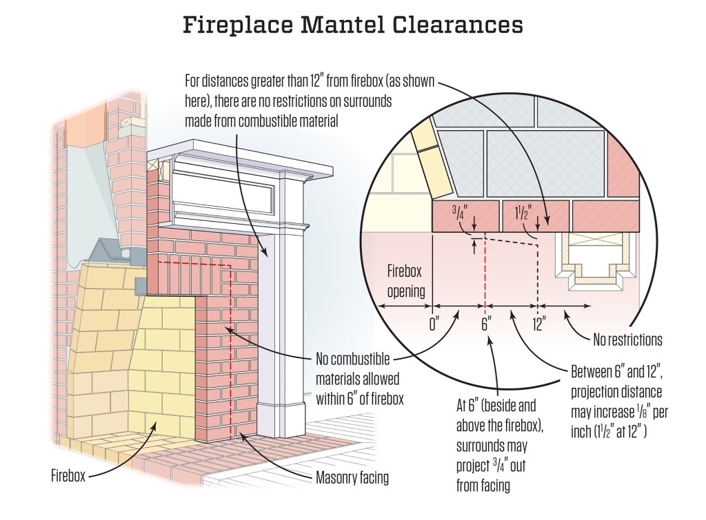

Traditional masonry fireplaces. For standard masonry fireplaces, fireplace codes are in Chapter 10 of the International Residential Code (or local versions, such as the Virginia Residential Code, that are based on it). Section 1001.11 “Fireplace Clearance” of the IRC (2018 edition), Exception 4 states the following:
“Exposed combustible mantels or trim is permitted to be placed directly on the masonry fireplace front surrounding the fireplace opening providing such combustible materials are not placed within 6 inches (152mm) of a fireplace opening. Combustible material within 12 inches (306mm) of the fireplace opening shall not project more than 1/8 inch (3mm) for each 1-inch (25mm) distance from such an opening.”
I think of these clearances as three areas: From the firebox opening to 6 inches out, no combustibles are allowed; from 6 to 12 inches away, you can put thin wood (at 6 inches, only 3/4-inch-thick stock is allowed, gradually getting thicker to 1 1/2 inches at 12 inches away from the opening). Beyond 12 inches, combustibles of any depth are allowed. Clearances are the same at the top and the sides (see illustration, top, or use the link below).

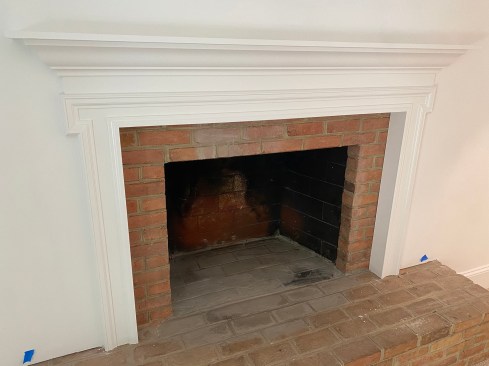

Some mantels have legs that project out 2 inches or more from the wall. To meet code, those legs have to be at least 12 inches away from the firebox opening. On the fireplace shown in the photo below, only 8 inches of brick is showing on the sides and top, however, while the wood trim of the contemporary-style surround is about 4 inches thick. To meet code, the surround’s thickness would have to be 1 inch deep or less at 8 inches from the firebox (because we gain 1/8 inch per inch as we move from 6 to 12 inches from the firebox).
The modern-style mantel shown above does not meet code because the side trim projects roughly 4 inches out from the masonry facing within 8 inches of the firebox opening.
