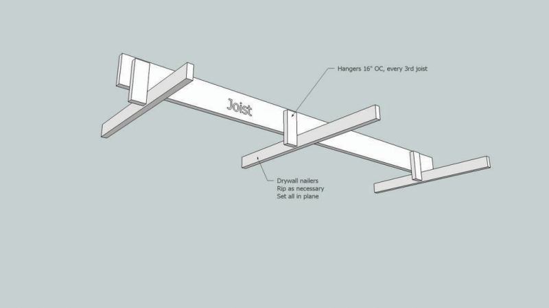

This ceiling system suspends nailers from 2×4 hangers placed 16 inches on-center on every third joist.
dgbldr, Michigan
Say you want to frame a basement ceiling for drywall. The joists are not in plane and you need to drop 3 to 4 inches anyway to clear ducts, pipes, and other stuff sticking below the joists. No soffits, just one flat ceiling. What’s your favorite method for framing the ceiling quickly and accurately?

dgbldr
Pretty much what we do. Just scouting for better techniques. Using the subfloor as reference is an interesting idea, but a decent laser is cheap enough so I don’t know if there is anyone out there without one.
We simply set the bottom of the hangers at the laser plane and then install the nailers flush with it (see illustration).

Dick Hackbarth, PE, St. Paul, Minn.
I’d do what you show in [your drawing]. Set a laser level 2 or 3 inches lower than you want the bottom of the nailer 2x4s, then use a 2- or 3-inch spacer block held under the 2×4 to locate its bottom elevation to nail it off.
dgbldr
Too complicated. What we do is set a plane laser to the final plane we want and leave it on. Then we go around the room and nail up the hangers so the bottom edge just touches the laser beam. Then it’s a simple matter to nail up the long pieces flush with the bottom of the hangers.
By the way, a rotary laser is not necessary. A 180-degree laser against a wall will cover the whole room.
Dick Hackbarth, PE
Just remember that the nails in the short hanger blocks are loading the blocking in tension parallel to the grain, near the end of the block to boot, a very weak nail-loading orientation. So, watch the end distance in your nailing. From that standpoint, 3/4-inch plywood might be better for the hanger blocks.
Then, a second consideration, the design load of the ceiling system shouldn’t be a hanger-loading problem, but there isn’t anything to make this look like a light hung ceiling. What if someone hangs a swing or chin-up bar with a few lag screws from what they think are floor joists? One or two hangers and a spanning 2×4 might have to take that load.
