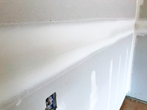

Here's the goal. The most common level of drywall finish is Level 4, shown here, in which seams and corners have been taped, then coated (along with fasteners) with two coats of joint compound, and sanded with a fine-grit paper to remove imperfections. If the room will be painted with anything other than a flat paint, the author recommends a Level 5 finish, which includes a skim coat of joint compound applied over the entire surface.

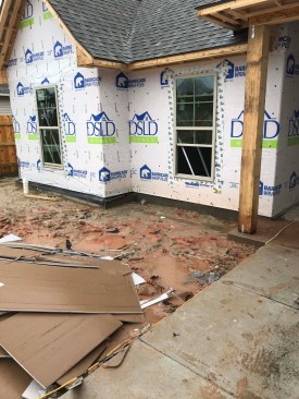

It’s not just the conditions for the crew; think about conditions for the materials, as well. Controlling the temperature, humidity, and airflow before, during, and after doing drywall work is also a huge factor and one of the best ways to ensure the lasting quality of finished drywall.
Wet, rainy conditions can lead to damp interiors. If the interior is not conditioned before installing the drywall, the chances for a lot of fastener pops and seam cracks are high.

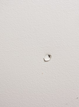

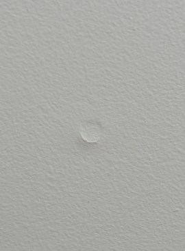

Screw pop happens when the screw head pushes out from the drywall surface and the compound coating along with it. But the opposite is also possible. If not enough compound is used over the screw indentation, a slight depression will show in the drywall surface. It’s also possible for the framing or drywall to expand after taping is finished which can pull the screw in slightly and cause an indentation.
There are many things that can cause these fastener pops. One of the most common is hanging the drywall when the framing is too wet. As the wood dries, it shrinks and pulls away from the drywall. Misaligned and twisted framing can also contribute to fastener failure.
Another common cause is having a screw is set to proper depth, but without pulling the drywall tight to the framing. If the drywall ever gets pushed tight to the framing, the screw head will pop. Any fastener that misses or is not securely anchored into the framing member may work loose over time. If you miss, don’t leave the screw in place.

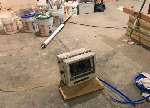

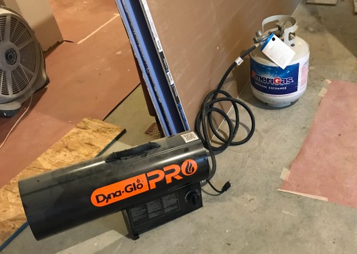

Propane heaters add moisture to the air, so salamanders are a poor choice to run when trying to dry out the shell or to speed up the drying time of joint compound.
Electric heaters not only will warm the work space but also will help dry the interior.
One of the byproducts of combustion is water vapor, so running propane heaters in a dried-in space will warm it up but won’t dry it out. Use electric heaters, fans, and dehumidifiers to dry the space.

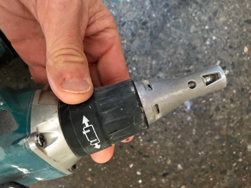

To minimize nail pops,  adjust the depth of drive so the screw is set just below the face with breaking the paper (about 1mm).  When driving the screw, keep the drywall tight to the framing.
Screws should penetrate into the wood framing 5/8 inch; longer is not necessarily better. (Nails, if used, need to penetrate the framing a least 7/8 inch.) I typically use 1-1/4-inch (32mm), coarse-thread screws for both 1/2-inch- and 5/8-inch-thick drywall, and 1-inch (25mm), fine-thread screws when fastening drywall to steel studs or resilient channel.

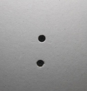

The top screw is driven properly, but the bottom screw is overdriven and has broken the paper around the screw head.
Don’t use too many screws. For walls framed 16 inches o.c., place screws every 16 inches along studs, no more; every 12 inches for 24-inch-o.c. framing. For ceilings, space fasteners every 12 inches along joists for both 16- and 24-inch-o.c. framing.
When properly set, a screw should not damage the drywall core or even tear the paper face. The screw head should be set about 1mm below the drywall face. If a screw is set too deep, the panel is more likely to pop loose.
Underdriven screws are obvious, and easy to detect. Just run the taping knife over the screw before applying compound. If you hear the knife click when it hits the screw head, then the fastener has to be set deeper. If you try to hide an underdriven screw by coating with more compound, you’ll end up with a bump of compound that will look really bad.
With an overdriven screw, the fastener breaks through the paper face of the drywall, creating a much weaker connection than an underdriven screw. Often an overdriven screw shows up right away because the panel is loose. Overdriven fasteners typically are corrected by the taper when he does his pre-taping inspection (see “Prepwork Before Taping,” Aug/19). A worse case is having this weak connection pop when subject to even minimal structural movement or expansion and contraction of the building materials.
The most important thing is adjusting the screw gun to the particular person and the particular situation you are in. A stronger, more aggressive person needs a different adjustment than someone who may not push on the gun as hard. As the driver bit gets worn, the adjustment needs to change; attaching 5/8-inch drywall (which is harder than 1/2-inch) will require changing the adjustment. It’s a fine line between driving the screws not deep enough—just right—and too deep.

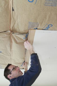

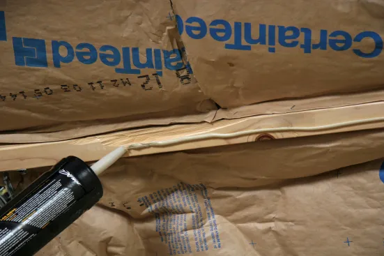

I prefer to use adhesive, as well. It’s not a must but does improve the job and limits the number of problems common to fastening drywall. I also do it to reduce the number of fasteners. With adhesive on each stud or joist, the number of fasteners needed can be reduced by up to 75 percent. An added benefit is that the adhesive strengthens the structure by increasing the panel’s tensile strength by up to 100 percent, and its shear strength by up to 50 percent.
One way to cut down on the number of fasteners is to secure the drywall with an approved ASTM C557 standard drywall adhesive.
When using adhesive, apply a 3/8-inch-wide bead to each framing member to within 6 inches of the edge of the drywall. Install fasteners on 16-inch centers along the perimeter of each panel immediately after hanging it.
In some cases, adhesive is required (for an interior shear wall, for example). If this is the case, remember to let the inspector know beforehand that you’ll be using adhesive so they can schedule an inspection in progress. Otherwise, take photos to back up your assertions. Increasingly, photos are accepted by the building department.

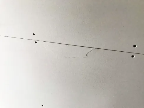

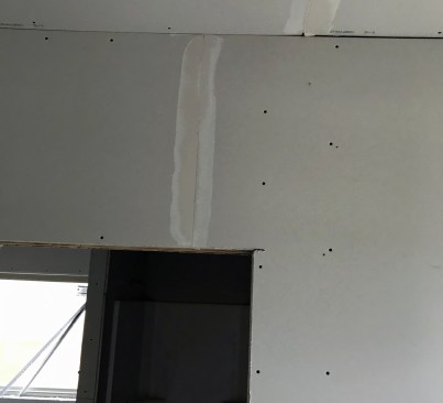

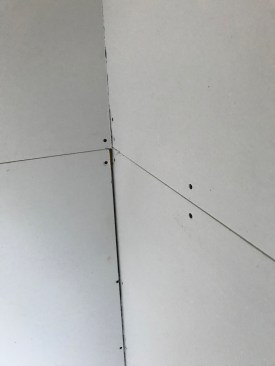

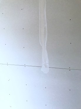

MF: One of the most common is installing panels so the butt end aligns with the edge of a window or door opening. This is a rookie mistake; it seems plausible for layout, but the butt joint will crack the tape if there is shrinkage in the header. Wood shrinks more across its width, so the wider the header, the more likely this will happen. The crack can also appear below a window, too. Butt joints are very vulnerable to cracking.
This butt joint is OK, but just barely. Note that all the butt joints have been prefilled with setting compound.
The way to prevent this is to not place seams close to the edge of opening. Place the sheet so the panel covers the corner, and the butt joint falls somewhere in the middle of the the opening, then cut out drywall in the opening. The joint can be any way in the opening, but should be no closer than 7 or 8 inches from the corner.
Butt joints anywhere on the wall are often problems because they don’t start out as a recessed seam. They basically start as a bump that needs to be blended in properly.
I float all my butt joints between studs and create a recessed joint with what are popularly called “rock splicers.” With these, don’t secure the butt end of each drywall panel to the framing. Instead, let it fall in between studs or joists.

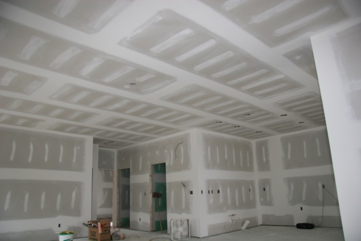

The best way to handle them is by “floating” butt joints between joists or studs and securing them to beveled backing boards that create a recessed seams.
On finishing jobs, I don’t always get to hang the drywall and have to deal with butt joints that land on the studs and joists. In these cases, I will prefill butted seams, using a setting compound. Prefilling is also needed for any large gaps and for any repairs.
Any large crack (over 1/8-inch) or void needs to be filled with a setting compound. This prefill should cure before taping.
Prefilling butt joints with a setting compound prior to taping will help stablize the joint.

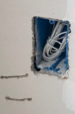

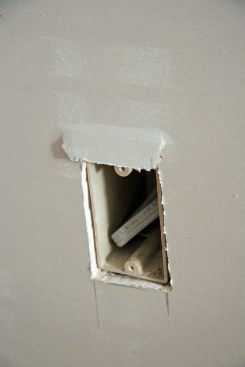

Overcuts and blowouts at electrical boxes are common problems. The cover plates really don’t cover much more than a 1/4-inch gap. The tapers will usually catch these while taping, but to help them notice, I like to circle the box and point out the area that needs to be patched.
The cutout for this electrical box is overcut in the lower left corner. This and the gouges from sloppy handling of the cutout tool will need prefilling, tape and two coats of finish to fix.
Cut-outs have to be precise. Undersizing the opening will lead to blowout like this that will  have to be cut out and the large void prefilled with setting compound before tape and finish.
Fixing a blowout requires tape embedded in compound and a couple of finish coats to conceal. I always encourage people to take their time and be careful cutting out with the drywall router. A mistake will cost the finisher at least four minutes per mistake.
Broken edges need to be repaired (the broken area cut out and the void prefilled with a setting compound) before taping and finishing the seam.

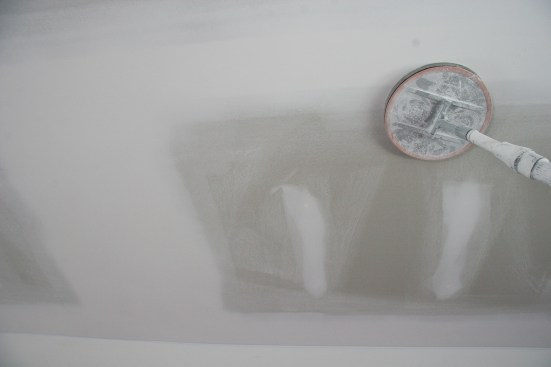

JLC: How about sanding? We often see ridges telegraphing through the paint where it looks like the mud wasn’t sanded enough.
M.F.: Under sanding is common over screws in the face of the drywall. Just the indentation has to be filled and then sanded flat so that there is not any buildup of compound around the screw head. There is a smear of mud between fasteners that occurs on the second and third coats, but not a build-up.
When sanding all edges of the compound should be sanded so they blend into the surrounding surface (no unfeathered edges).
Oversanding can certainly happen, too; it creates concave seams or exposes the tape, which is especially common on inside corners when not enough mud was applied in the first place. Because lightweight compounds are preferred for the finish coats nowadays (these compounds are softer than the traditional heavy-weight compounds), you should never use coarser than a 220 sandpaper grit. 220 grit will minimize scratches in the compounds and won’t rough up the paper face.
