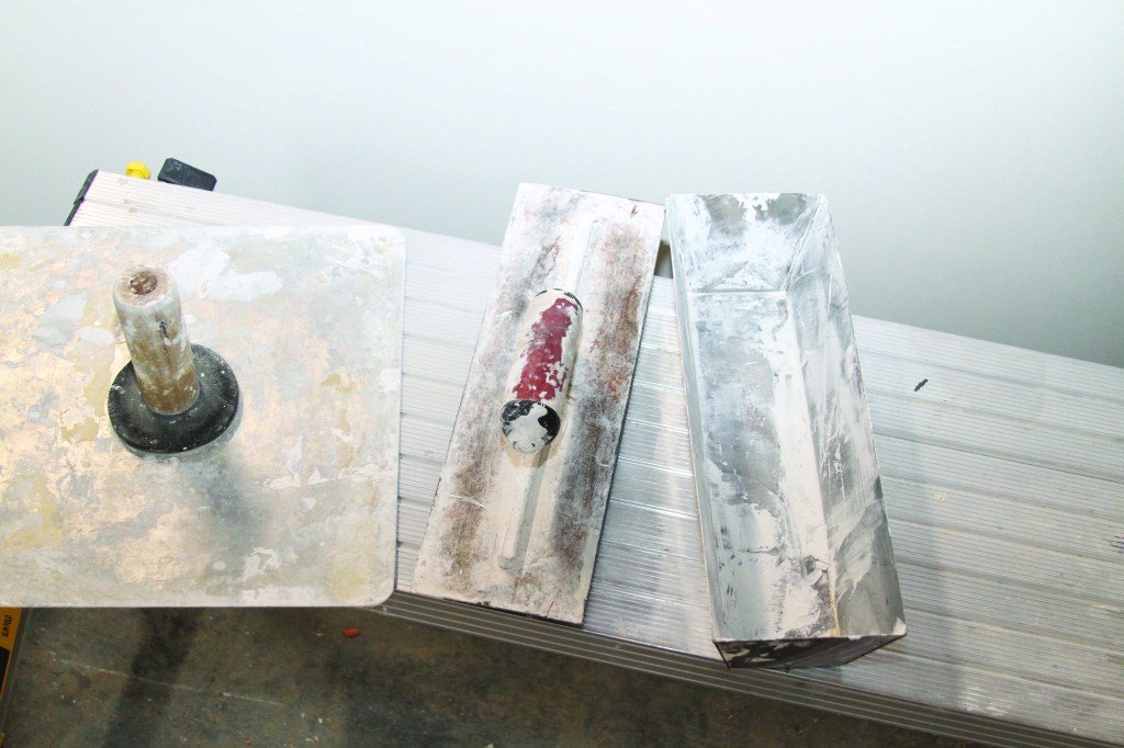

Taping tools. There are basically two tools needed to embed the tape—one to hold the compound and the other to apply the compound on the wall and embed the tape.
There are three options for holding the compound. A mud pan can hold quite a bit of compound, and its edges work well for removing compound from a taping knife. Because it is shaped like a bread pan, even thin compound won’t end up on the floor; a pan is a must when you’re working with thinner compounds.
A hawk can also hold a lot of compound, even more than the average pan, but it takes experience to hold a hawk so the compound doesn’t run off. The compound can’t be too thin or it will. The edges are used for removing compound from the taping knife.
A large, 12- or 14-inch drywall trowel can also be used to hold the compound, but of the three options, it holds the least amount of mud, and thin compound will run off the edges. Because the trowel holds less compound, a person using a trowel generally makes sure the compound bucket is always close at hand. The one benefit that a trowel has is that it can be used to smooth out compound that is applied with the taping knife, if the need arises.

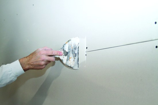

Taping knives come in different widths, typically from 3 or 4 inches to 10 or 12 inches wide. For the first coat, I use a 5- or a 6-inch taping knife to apply compound over the seams.
Getting mud on the seam. The basic technique I’ll describe is for beveled seams—the long edges of a sheet of drywall. The drywall sheets should lightly butt each other. Any gaps that are wider than 3/16 inch between two sheets of drywall should be prefilled with a setting compound and allowed to dry before you begin to tape out the seams.
The author uses a 6-inch knife for the first coat, applying a healthy 1/8-inch-thick bed of compound on the seam.
When I’m ready to tape, I grab a taping knife and remove some compound from my container by pushing the knife under the compound, and then twisting the knife over, cutting the compound off against the side of the pan or the surface of the hawk or trowel.
On the first pass, I spread the compound over the seam. With the knife blade centered on the seam, I guide the knife along the seam at about a 20-degree angle from the drywall surface. Grabbing more compound, I make the next pass. My goal is to leave an even layer about 1/8 inch thick over the seam. This is thicker than compound manufacturers say you need, but at this initial stage, you want plenty of mud on the wall so you don’t end up with dry areas under the tape. The excess mud at this stage will get forced out from under the tape later, as I will explain.
I apply the compound over the entire length of the seam, up to about 20 feet long. I work multiple seams in my immediate area, applying mud on the entire length of each seam before I begin to embed the tape.

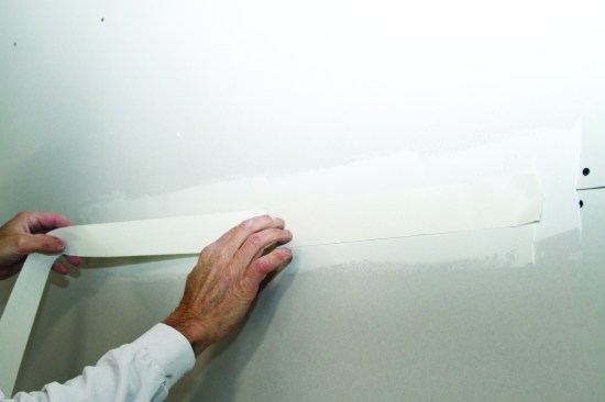

Embedding paper tape. Once the compound has been applied, center the tape over the seam. For efficiency, I keep a tape reel on my belt and roll it out from there. This saves me from bending down to grab the roll off the floor and from hunting around for it.
He coats the entire length (up to about 20 feet) before rolling out the tape and gently pressing it into the mud every 18 inches or so to keep it in place.

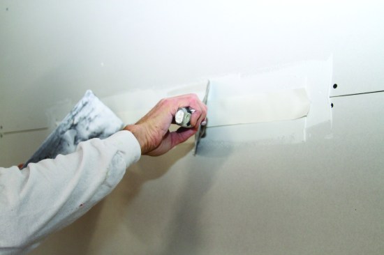

I press the end of the paper tape into the compound with my hand at one end of the seam, and as the tape is pulled off the reel and centered over the seam, I press it lightly into the compound every 18 inches or so to hold it in place. The tape has to be kept tightly pulled as it is centered over the joint. Once the end of the seam is reached, the tape can be cut. I do this by pushing the edge of the blade tight into the compound with my taping knife, then pulling the tape across the blade, tearing it crisply.
All paper tape is pre-creased so it can be used in corners as well as over seams. It works well for flat seams, too, but you want to place the tape so the crease creates a valley, so to speak, rather than a peak. (If the end of the roll of paper tape sticks out of the bottom of a reel, the tape will be pulled off the reel with the correct side—the back—facing down into the compound.) If the tape gets embedded backwards, the center of the tape could ridge out slightly after embedding, which may be difficult to conceal later when you’re applying the finish coats.
With the tape positioned over the seam, the author draws his taping knife along the length, holding the knife at a steep 60-degree angle while pinning the tape in place with the trowel he uses to carry compound.
He tests the embedded tape; if it leaves a dimple, not enough mud has been forced from the back of the tape.

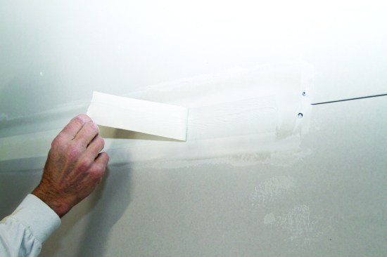

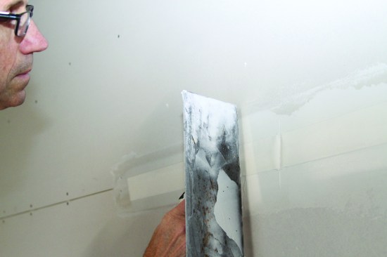

Once the paper tape is positioned over the seam correctly, it has to be embedded into the compound. Start at the center, regardless of the length of the seam, and draw the knife along the tape towards one end, holding the blade and handle at about a 60-degree angle to the wall. This steep angle makes it easier to apply the necessary pressure to properly embed the tape. But even so, it requires a lot of pressure to pull a knife along the tape and force excess compound out from behind the tape. To avoid pulling the tape along, I hold it in place with the corner of whatever tool I’m using to hold compound (in photos 4 and 5, I’m using a trowel, but the corner of a hawk or pan also works).
You can also peel back the end of the tape to inspect: There should be an even layer no more 1/16 inch thick.
One way to test whether the tape is embedded properly is to tap on the embedded tape with a finger or the edge of a trowel. The surface should not dimple enough to wrinkle the paper or cause a visible indentation. If I’m concerned about removing too much compound, I’ll lift the end of the tape to inspect the amount of compound left behind. I want an even layer no more than about 1/16 inch thick. Leaving too much compound behind can make seams difficult to conceal later because the tape may form a slight ridge.

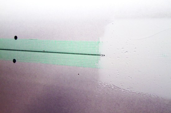

Fiberglass-mat tape. When finishing tapered seams, I prefer mat tape because it is so easy to embed and I am confident in its strength. It gets embedded into seams in the exact same manner as paper tape, using the same heavyweight all-purpose joint compound. However, fiberglass-mat tape is easier to embed because the mat is porous, making it easier to force excess compound out from behind the tape. You can freely apply plenty of compound over the seam and not worry about working too hard to smooth it out, eliminating the likelihood of dry areas behind the tape. The only precaution is that mat tape cuts a lot easier than paper tape, and you need to be careful not to apply too much pressure with a taping knife, otherwise you can damage the tape.

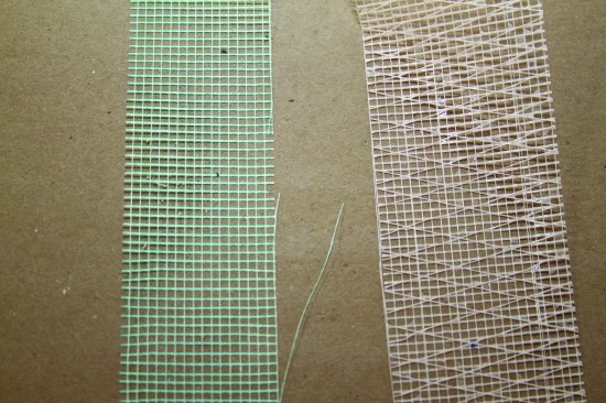

Fiberglass mesh tape. There is a wide variety of fiberglass mesh tapes on the market. Some have very close fiberglass strands, while others have strands that are quite wide apart; there are even different weaves available. As far as I know, all varieties are self-adhesive.
Fiberglass-mat tape gets placed into joint compound the same way as paper tape. It is easier to embed with a knife after placement because the mat is porous.

Fiberglass-mesh tape is a different animal. There are different varieties, including different weaves.

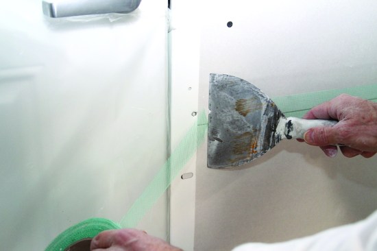

Drying-type joint compounds are not recommended for most fiberglass tape. With drying type compounds fiberglass tape has been known to split along the center of seams. You should use a setting compound. The setting compound is mixed to the same consistency as the drying-type compound. There is no need for a fast setting time; the main goal of a setting compound is to strengthen the seams. But, of course, if the taper wants to apply the first finish coat earlier, there is no detriment to using a faster setting compound.
All fiberglass-mesh tape gets applied over a dry seam. This can save time because it eliminates the step of pressing the tape.
With mesh tape, you just roll out the self-adhesive tape, pressing it into place over the seam by hand or with a taping knife. At the end of each seam, the tape can be cut, either with the taping knife or with a utility knife. The mesh tape gets embedded when it gets covered with joint compound. I typically apply this compound with the same 5- or 6-inch-wide taping knife, firmly pressing the compound through the tape. A trowel or knife can then be used to remove the excess and smooth out the remaining compound. Because the tape just has to be coated, the same tools you use to apply the tape are kept in hand, speeding up the process.
All mesh tapes should be coated with a setting compound, not a drying compound. Mesh tape is more resistant to stretching and can leave fine cracks at the tape edge when a drying compound dries and shrinks.
Mesh tape offers several advantages over paper and fiberglass-mat tape. The main advantage is speed. Using mesh tape as I just described is typically faster (at least for hand-taping) than embedding paper or fiberglass-mat tape. You can tape over all the seams in an entire room before applying any compound. Taping and mudding become two separate steps, and you eliminate the step of pressing the tape into the compound to force out the excess mud, which saves a lot of time and effort.
Using fiberglass mesh tape also greatly reduces the likelihood of any blisters under the tape. A tape blister is a small dry area under paper tape that may not be noticeable until a finish coat is applied over the tape. The area will then show as a blister-like spot.
