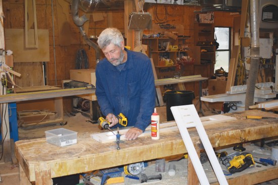

Pilaster Assembly

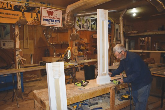

I started by pocket-screwing together the two poplar frames that make up the front of each pilaster, using the vertical and horizontal layouts from my story pole as a guide. To build out the pilasters to a 2-inch depth, I added 1 1/4-inch-wide returns cut from 1-by stock behind each stile. I wanted to make the joint between the stiles and returns virtually seamless, so I first glued the returns to the back of each stile, holding them in place with a few 23-gauge headless pins. Then I drove pocket screws spaced 5 or 6 inches apart to tighten up the joints. During assembly, I let the edges of the stiles overhang each return piece by about 1/16 inch, so after the glue dried, I flush-trimmed and sanded the joints. It takes a little more work, but the result is an almost invisible joint.
The author used pocket screws and glue to join the stiles to the rails when fabricating the frames for the pilasters.
Then he added 1 1/4-inch-wide rippings inset slightly from the frame edge, which he later flush-trimmed with a router.
Next, I stapled 1/4-inch-thick plywood panels to the back of the frame (paint-grade 1/4-inch plywood scrap is almost always available in my shop, but any flat material that takes paint well will work here).
When cutting the WOBB002 band mold to finish the panel detail, getting the mitered corners just right can be tricky. I have found that it works best to put the short pieces at the rails in first, then fit the longer ones at the stiles. For perfect miters, the secret is to take your time and not cut each piece for a fit that ends up being too tight, even if it means several trips to the saw. I fastened the molding in place with the headless pinner.
Finally, I ripped the WOBM001 7 1/4-inch-wide base profile down to 5 inches and wrapped the molding around each pilaster for the base detail.
After fastening the panels to the frame and adding the panel mold, he installed base mold, which he ripped to a 5-inch width.

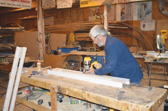

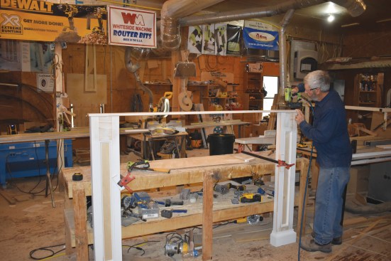

To assemble the unit, I started by clamping both pilasters to my worktable, with the spacing between them based on the measurements recorded on my story pole. Then I joined the pilasters together with a 2 1/2-inch-wide ripping on the flat, sized so that it would be long enough to project 1/4 inch wider than each pilaster. Before pinning the ripping to the pilasters, I eased its front edges and ends with a 1/4-inch-diameter round-over bit.
For the frieze below the mantel-shelf assembly, I used a length of WindsorOne 1x8 trim, orienting it vertically and cutting mitered returns at each end so that it would line up with the front and outside edges of the pilasters—basically set back 1/4 inch from the ripping. I like to use the WindsorOne products for this purpose because they are always straight and flat. To join the 1x8 vertical frieze to the 2 1/2-inch-wide horizontal ripping, I used scrap 1 1/4-by-1 1/4-inch rippings for blocking, then added some vertical blocking to support the top mantel shelf.
Next, the author clamped the pilasters to his work bench following the firebox dimensions marked on his story pole, and joined them together with a 2 1/2-inch-wide ripping with a bullnose profile.

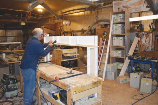

Then he fastened a vertical 1x8 with mitered returns to the assembly, along with blocking that would later support the mantel shelf.
I continued to build up the frieze, wrapping the 1x8 with a layer of WOBM001 base molding ripped to a 5-inch width. I aligned the ripped edge with the top edge of the 1x8, so that the molding profile is upside down.

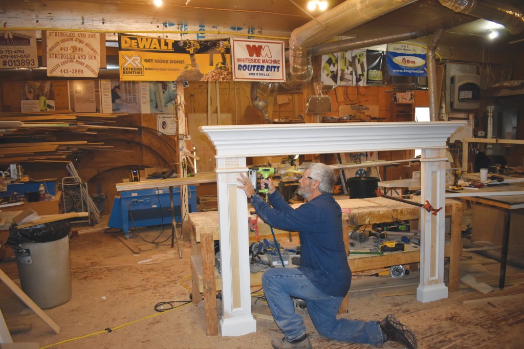

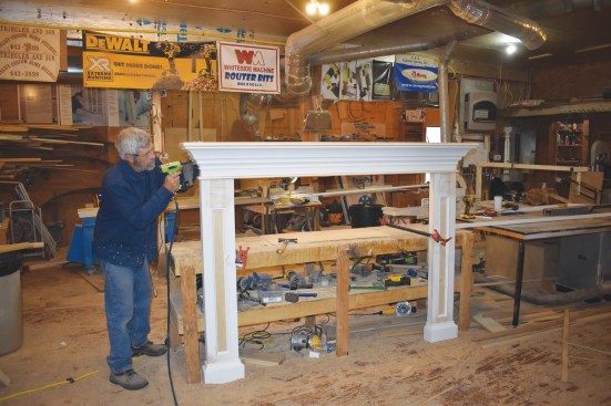

When assembling the mantel shelf and crown molding trim detail, I started by joining the mitered corners of the crown together on a worktable with wood glue and headless pins. Then I took the final measurements for the mantel shelf from the crown detail, sizing the shelf so that it would be 2 inches longer and 1 inch wider, which would create a consistent 1-inch reveal above the crown. I cut the shelf from 5/4x8 stock, then rounded over the edges and ends with a 3/8-inch radius bit before nailing the shelf in place. Then I pinned the crown assembly in place, a sequence that seems to provide a better fit than installing the shelf last.
To build out the frieze, the author wrapped the vertical 1x8 with base trim ripped to a 5-inch width and turned upside down. He then preassembled the crown detail, using its dimensions to size the mantel shelf.
The author cut the mantel shelf from 5/4x8 stock and gave it a bullnose profile prior to installation. Then he pinned the crown molding assembly to the shelf and frieze.

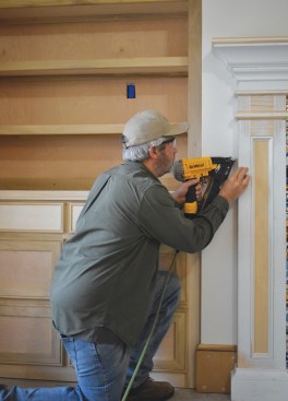

Installation
Installing this prefabricated mantel on the jobsite was super easy. First, I made a pair of cleats out of 5/4-inch stock sized to fit inside each pilaster while offering a little room both side-to-side and up-and-down for adjustment. After determining exactly where the mantel needed to be located on the wall, I attached the cleats to the wall framing with construction adhesive and finish nails.
Next, I checked to see if the floor was level. When it isn’t, I start by setting the pilaster on the high side first, holding it up off the floor with an appropriate spacer if the finish material in front of the fireplace has yet to be installed. Then I set a long level on top of the mantel shelf and shim up the low side (if there is one).
To install the mantel, the author fastened mounting cleats to the wall with nails and construction adhesive. After making sure the mantel shelf was level, he then drove 15-gauge finish nails through the pilasters into the cleats.
Finally, I simply nailed through each side of the pilasters into each cleat with a 15-gauge finish nailer, before turning the mantel over to the painters for final finishing.
