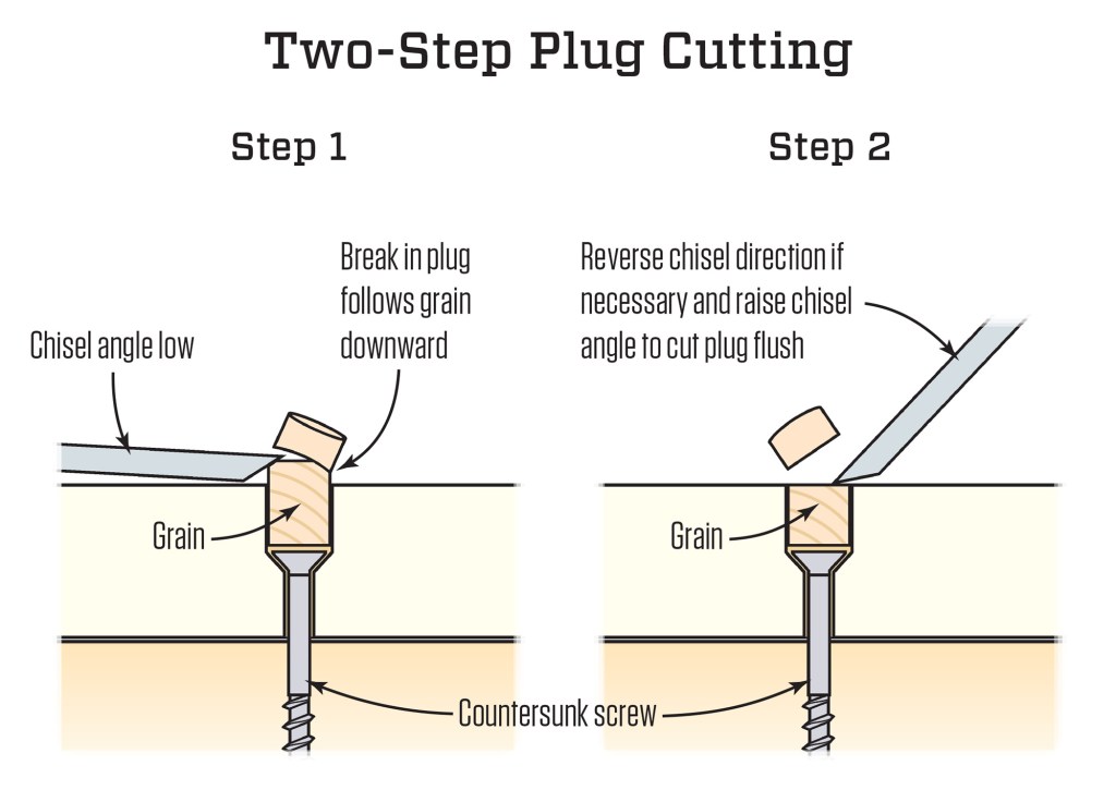

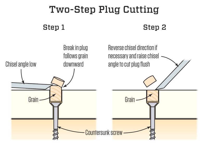

Make the first pass of the chisel with the blade slightly high and note which way the grain of the plug breaks. If it breaks down and away from you, reverse the chisel direction for the final pass.

Once the plug is driven into the hole, I use the largest, sharpest chisel that I have to trim the plugs (I often use a large slick). The idea here is that the weight of the larger chisel helps to carry the blade through the plug with minimum impact. I keep the flat side of the chisel facing up (see Two-Step Plug Cutting, above) and start with the handle close to parallel with the work. That puts the cutting edge slightly above the finished surface. After the first cut, I look at the plug to see if it has broken off at an angle. If the break is slanting down and away from me, I reverse the direction of the chisel to complete the cut. This keeps the plug from breaking off below the surface.
When I need to remove a plug that has broken off below the surface of the board, I simply drive a coarse-head drywall screw into the center of the plug. When the tip of the screw hits the screw in the hole, it keeps spinning and augers the broken plug out of the hole.
