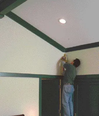

Like many carpenters, I always thought there was no good way to install crown molding on a cathedral or vaulted ceiling. For years, I would just shake my head whenever anyone suggested it. “Nah,” I’d say knowingly, “that never looks good.” Most of the time I got away with that, but occasionally customers insisted, and it was always a struggle. But I kept my eyes and ears open for a better method, and in the last few years I’ve discovered several, each of which has advantages and disadvantages.
No matter which of these methods I use, the back of the crown molding installed on the horizontal runs must first be ripped with a new shoulder or foot bevel to follow the sloped ceiling or the wall. Sometimes both angles must be modified (see “Ripping a New Bevel Angle,” below). If you fudge the inside corner using just one size of crown, you sometimes have to rip both the top and bottom bevels; if you use two sizes of crown, you only have to rip the top.

Using Transition Pieces
When two pieces of molding — like casing, chair rail, or baseboard — meet at different planes, a triangular transition piece often solves the problem. But that solution for vaulted ceilings never dawned on me until JLC Live presenter Mike Sloggatt suggested it about a year ago at a show. Opinions vary on this technique. Some people think that corner transitions don’t look good because of the extra miter in the crown molding at every corner. But I like the technique: The additional lines emphasize the molding profiles, like running three-piece crown around bull-nosed corners or breaking crown around end blocks on a mantelpiece (Figure 4).

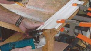

If all those angles and miters are too confusing, pendants might be the right alternative (Figure 7). I like making pendants, and I like the way they look, especially in homes with abundant moldings. But many homeowners (and lots of other carpenters I’ve heard from) think they look cheesy. Still, I have yet to find a better way to handle an outside corner in a room with a cathedral ceiling.
Figure 7.Pendants can provide a point of termination for crown molding and eliminate the need to join a rake run with a horizontal run (top). The author makes pendants from scraps, mitering four pieces together using spring clamps, glue, and pin nails (bottom).
Pendants are easy to make, and they don’t require a lot of molding. I typically make them from the pieces of waste that are left after installing crown in all the easy rooms. The first step is cutting the miters to exactly the same size. I’ve used a pencil mark on the base of my saw as a stop guide, but clamping a repetitive stop to the extension wing is a more reliable way to ensure that every piece is identical. After assembling the pendants, I make the base blocks 1/4 inch wider than the widest part of the pendant, which provides a perfect reveal line.
For small pendants, I rip down a block of 4×4 until the reveal is right, then cut the block to match the slope of the ceiling. For large crown molding, I make the block from pieces of 1-by with mitered corners.
