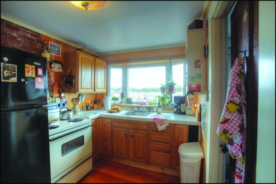

Before. Last renovated in the 1990s, the existing kitchen had full-size appliances, a tile countertop, and stock cabinets that left an open space on one side that was barely usable.

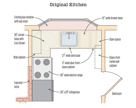

The most prominent feature—and the biggest challenge of this kitchen—was a large bay window that took up the lion’s share of the biggest wall. Below the window, the existing cabinets consisted of a 36-inch Lazy Susan in one corner with a 27-inch sink base and a 15-inch drawer base next to it. A narrow door-front cabinet and an odd, unfinished, leftover space completed that wall. Wall cabinets included a stock two-door cabinet on one flanking wall and a vintage glass-front metal cabinet that Laurie had rescued from a friend’s trash on the opposite wall.

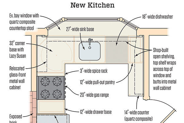

As I began to sketch out the layout for the new kitchen, I started by reducing the footprints of the full-sized appliances and replacing them with more compact versions. A 24-inch refrigerator would replace the existing 30-inch model, and the stove would shrink from 30 inches to 20 inches. I reduced the Lazy Susan to 32 inches and kept the 27-inch sink base. As a result, I gained space for a 12-inch drawer base between the stove and fridge, a narrow pullout spice rack on the other side of the stove, and an 18-inch dishwasher next to the sink. To make use of the other blind corner, I had just enough space for a 12-inch pull-out pantry cabinet. Enclosing the fridge would allow for extra storage above (see plan, below).

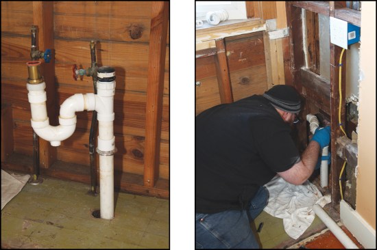

Adding a sink vent. Just after ordering the cabinets, we brought in a plumber. The first thing he pointed out was an S-trap with an air admittance valve on the kitchen sink drain. Adding a dishwasher would require a new, properly vented sink drain. But with the window in place, the drain would have to travel below the window and into an adjacent wall shared by a bathroom in order to be vented properly.

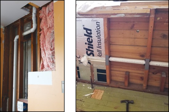

After stripping the window wall and the bathroom wall back to the framing, the plumber was able to run the drain through the floor, and the vent up into the attic. I took care of drilling the hole in the roof and installing the boot and final length of vent pipe.
The existing sink was unvented, with an S-trap drain (above left). The plumber installed a new P-trap drain (above right)…

…which he vented through a shared bathroom wall (left), before the open walls were insulated (right).
