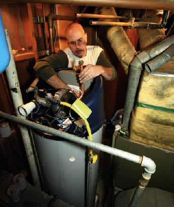

In my 30-plus years as a plumbing contractor, I’ve replaced countless water heaters. Our company, which works in the San Francisco Bay area, installs three basic kinds: conventional gas models, tankless models, and — increasingly — condensing storage heaters. Customers who want to save energy nearly always ask for a tankless water heater. That’s no surprise — tankless heaters have been getting a lot of media coverage and are the only efficient heaters most people have heard of.
In most cases, however, we recommend condensing storage heaters to our replacement customers, because they are arguably more efficient than tankless models and — when used to replace an existing heater — frequently less expensive to install. For homeowners, switching from a conventional heater to a condensing model is not a big change. If they consume the same amount of hot water as before, they’ll have lower gas bills and run out of hot water less often. Switching to a tankless heater, by contrast, requires some lifestyle adjustments: The homeowners will have to wait for the heater to produce hot water and they won’t be able to get it at very low flow rates (see “Is a Tankless Heater Right for the Job?”).
In this article, I’ll discuss condensing storage heaters and how they’re installed. Since natural gas is the primary fuel in our region, I’ll be describing gas-fired models, many of which can be field-converted for propane.
