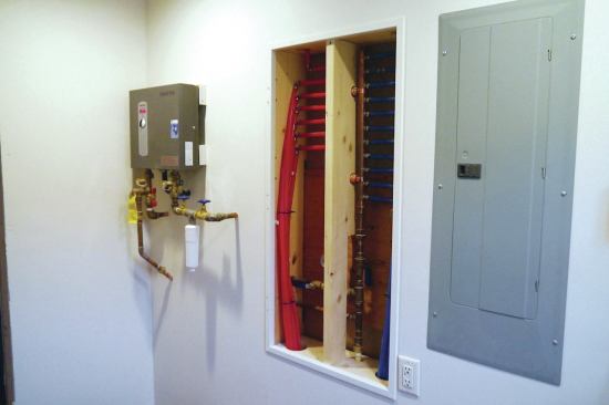

At an energy trade show, I saw and instantly fell for a Stiebel Eltron electric on-demand water heater. Made in Germany, it was compact, easy to install, and required no through-the-wall penetrations or second fuel source.

I would have neither of those problems. My house was new, with a 200-amp service, and the distance between the electrical panel and the heater would be 6 feet. A plumbing manifold would separate them.

I chose Stiebel Eltron’s Tempra 24 Plus model, which has a dial to adjust water temperature between 86°F and 140°F and a digital screen that allows users to read the setting. The whole unit measures just 16 5/8 inches wide, 14 1/2 inches high, and 4 inches deep.
The Plus series also has a proprietary Advanced Flow Control, which maintains the set point temperature but slightly reduces the water flow when demand is greater than the unit can handle—no more sudden blasts of cold water. The company’s lower-priced standard Tempra model has the dial temperature adjustment but not the LED screen or the Advanced Flow Control technology. In addition to the unit, I installed a Watts (watts.com) LFTWH-FT-HCN Service Valve Kit with purge ports that allow regular cleaning to remove scale buildup; the hot-water side comes with a pressure relief valve.

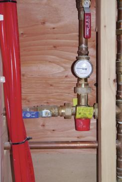

Since scaling is a potential problem with any tankless water heater, I doubled up with an Aqua-Pure AP430SS Scale Inhibition System (aquapurefilters.com), which uses a consumable water-treatment canister as a continuous method for minimizing scale. Local code requires a mixing valve—or anti-scalding valve—set to 120°F or lower, which I plumbed just before the manifold.
I’m not a big fan of plastic manifolds, so I modified a 7-port closed-end Sioux (siouxchief.com) copper manifold by replacing the intake PEX barb with a brass union, and I ran rigid copper pipe from the water heater to the manifold. Generally, when plumbing, I like to isolate replaceable components with unions and ball valves to facilitate future servicing and replacement.

The electrical wires, tank, plumbing valves, and fittings all reside in close quarters. To facilitate installation, I stood the tank off the wall with 2×4 cleats. Since I prefer threaded fittings, close nipples allowed me to squeeze all the parts together.
The challenge came in creating leak-free connections. The Environmental Protection Agency mandated that all plumbing fittings be lead-free after Jan. 1, 2014. The lead component in the old fittings had actually made the brass or bronze more malleable and therefore Teflon tape wrapped around threads typically resulted in a watertight connection. The absence of lead in the new ones and the preponderance of low-quality Chinese fittings led me to seek another solution.
I found it in Oatey’s Great White Pipe Joint Compound With PTFE (oatey.com). This white paste “greased” the connection, allowing me to make two to three more complete turns than I could with Teflon tape, assuring me a leak-free connection. I now use it for all threaded connections: brass, copper, iron, chrome.
To run the hot-water lines from the manifold to my appliances, I used AquaPEX, which is made by Uponor (uponor-usa.com) and is a PEX-A tubing that’s more flexible and therefore easier to bend than PEX-B. Crimp fittings and stainless steel crimp rings completed my installation. Shutoff valves were placed at each appliance, with no ball valves at the manifold. I protected the tubing with nailing plates wherever an errant drywall screw could easily puncture it.

My initial impression of electric tankless water heaters is very favorable. For less than $1,000, I was able to purchase the materials (heater, service valve kit, scale inhibition system, electric cable, and fittings) and one hour of my electrician’s time to install the Tempra 24 Plus. That does not include my time to hang the unit and plumb the valves nor the time to run the PEX—all of which I estimate to be an additional four to six hours. A comparable propane installed tankless system would run $3,000 or more.
My utility room is centrally located and all runs to water appliances (sinks, dishwasher, clothes washer, showers, and the like) are short, keeping tubing lengths to 25 feet or less. Hot water arrives quickly: One shower with a home run distance of 16 feet yields warm water in less than 10 seconds and 120°F water in less than 30 seconds. An in-line dial thermometer shows that the outgoing water temperature is within 2 degrees of my set point. I have no stand-by losses (which can consume 15% to 20% of kilowatt hours used) nor am I heating water to a higher temperature than my set point in order to account for stand-by losses.
This system is very quiet; there’s no boiler roaring awake to heat my water, no rumblings from a propane tankless heater—only the sound of running water when I need it.
Because my house has a crawlspace, I plumbed the pressure relief valve with rigid copper tubing to an outside wall, hiding the outlet behind a 4-inch screened dryer vent. Next time, I’ll use 3/4-inch PEX-AL-PEX tubing, which will allow me to zigzag between framing members without fittings.
