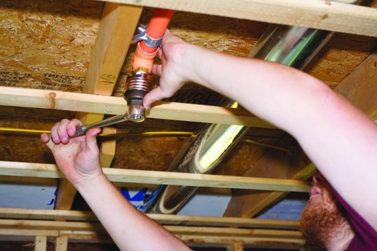

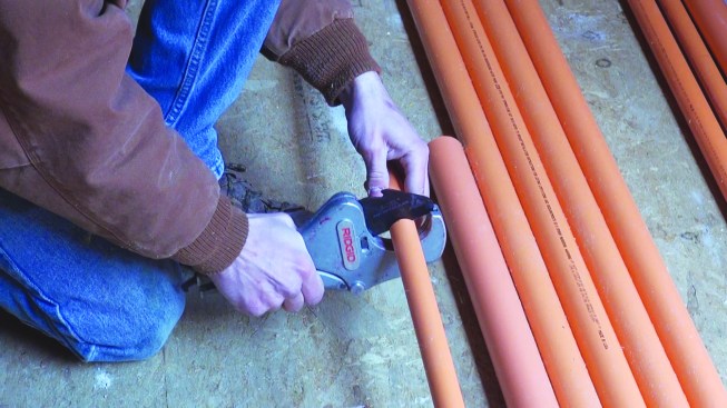

The CPVC piping shown on these pages is only one of a half-dozen or more permitted materials, but it’s widespread because of its versatility, affordability, and ease of use. Above, an installer cuts the tubing with hand shear.

There’s a lot of choice in the world of fire sprinklers. Industry standards require piping and sprinkler heads to meet certain test conditions, but the list of materials that can pass those tests continues to grow. The old standby, steel pipe (commonly called “black iron”), is still popular among sprinkler contractors, but the less-costly CPVC (chlorinated polyvinyl chloride) pipe, recognizable by its bright orange color, is widespread. Another plastic piping option, cross-linked polyethylene (known as PEX), has also made inroads in the market. Copper tubing is permitted too—although it’s expensive, copper is sometimes preferred for exposed conditions where some people find it more visually pleasing than other choices.
Black-iron pipe has the advantage of familiarity for old-school sprinkler contractors, and it has a high bursting strength that suits it for situations where a high-pressure fire-department connection on the exterior of the building is required. It’s also very rigid, which helps where you need a stiff, strong connection to the building. But it’s relatively hard to cut compared with plastic tubing, and it requires the ability to tool threaded connections onto lengths of pipe.

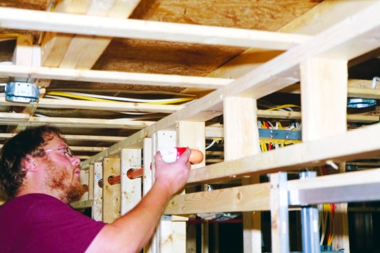

He applies a thick coat of solvent cement to the inside of a fitting.

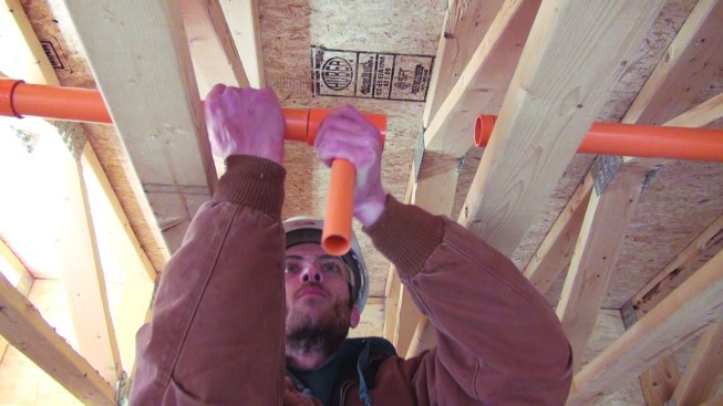

Then he jams the end of a pipe into a prepared fitting.

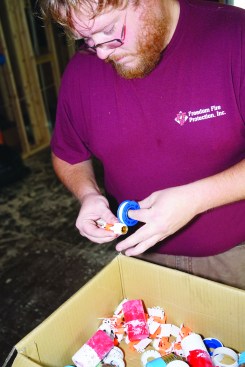

CPVC, by contrast, is easier to cut and join. But there’s a significant caveat: The plastic material is sensitive to chemical interactions with other materials—a vulnerability that the industry has learned the hard way, through failures in the field.
Nowadays, suppliers warn about a range of potentially damaging interactions. On the website of Lubrizol, the maker of Blazemaster CPVC pipe and fittings, you can find a long list of incompatible products that includes anti-microbial coatings for steel pipe, 11 different kinds of caulk, 14 different firestopping products, five leak detector fluids, six mold cleaners, two mold inhibitors, a vinyl-coated pipe hanger, four kinds of pipe tape, 20 different thread sealants, and one brand of waterproofing. Putting any of these products in contact with the sprinkler pipes could lead to degradation and leaks. So, too, could exposing the pipe to the UV radiation in sunlight.
To make a CPVC pipe joint, both of the pieces to be attached need to be smeared with the solvent adhesive. Above, the installer applies a medium-thick coat of adhesive to the inside of the fittings.

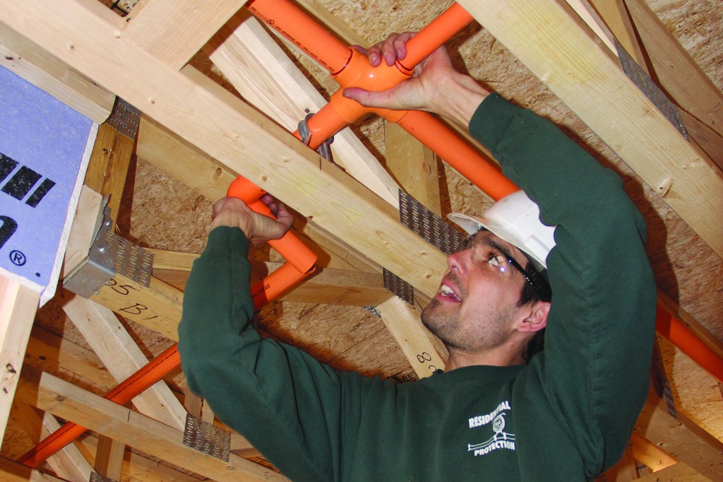

He jams the pipe into the fitting until the pipe bottoms out against the fitting.

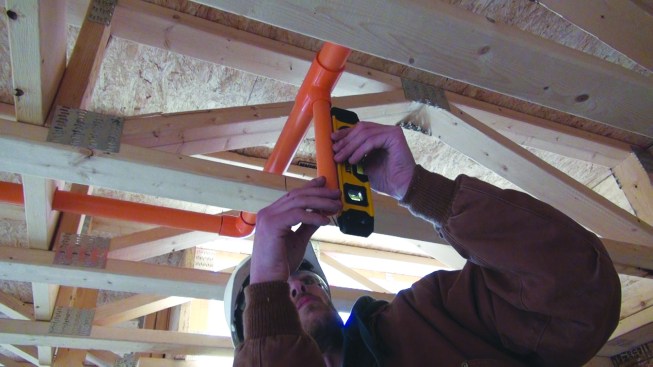

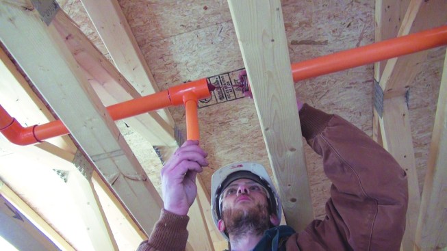

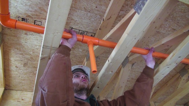

The pipe is checked for plumb.

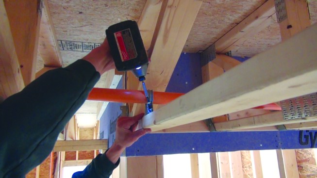

Adjustments to pipes should be made immediately, before the adhesive sets. The installer secures the pipe to the framing with a connector. Pipes need to be restrained against uplift from water pressure in the event that a sprinkler head activates.

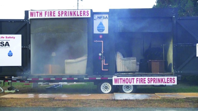

Here, a fire-department side-by-side demonstration in Brunswick, Maine, shows the effectiveness of residential fire sprinklers in suppressing a fire in a pair of simulated rooms. A fire in the right-hand room (with no sprinklers) reached deadly flashover in a little over two minutes.
A sprinkler head in the left-hand room ceiling activated in about one and a half minutes after ignition, effectively suppressing the fire. Damage to contents in the unprotected room was far more severe than in the protected room. More importantly, in an actual fire, the sprinkler would have given building occupants precious moments to escape.
