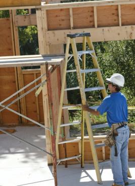

I started off by reminding everyone that the safety rules we always practice were still in effect. We have standard operating procedures for ladder safety and cord safety, for making sure there are no holes in the deck that someone could trip on or fall into, for keeping the site cleaned up, and so forth. The crew knows these rules because they’re in our safety manual and we’ve discussed them at previous meetings.

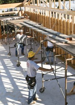

Since we had set up scaffolding — complete with railings supported by outriggers — along the building’s outside walls, the men working at the ends of the trusses would be covered by our standard safety program. But we needed alternative procedures for the men working the peaks of the trusses, and these were methods I had devised for this particular situation. I stressed to the guys that understanding and sticking to this plan — even though it wasn’t in our printed safety manual — was critical to everybody’s safety that day. The actual components of the plan were the other four items in my outline.
