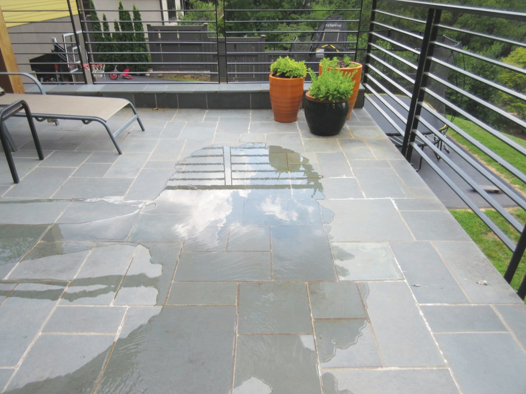

A. Frank Woeste, P.E., professor emeritus at Virginia Tech, responds: Historically, structural designers and builders have assumed that a design slope of 1/4 inch per foot (1:48) is sufficient to prevent ponding action, thinking that the installed roofing system will maintain at least a 1:48 slope in-service as required by some roof covering systems. However, in many cases and for different reasons, ponding on limited areas of low-slope roofs is common. That’s due to roof deflection, which over time can cause water to collect in some areas of a roof where the design slope for drainage is not adequate, and in fact changes from a “positive” drainage slope to a “negative” slope (see photo below).

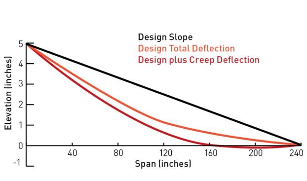

As shown on the vertical axis of the graph below, the 1/4-inch-per-foot design slope results in the left bearing being 5 inches above the right bearing. The span of 240 inches is depicted along the horizontal axis of the graph. The straight black line represents the slope (1:48) of the 2x10s prior to any type of loading. This slope matches the “design slope,” which is normally communicated to the joist or truss designer by the construction drawings or a specification.
Modeling predicts that design loads plus creep deflection will cause 2x10 joists with a 1/4-inch slope per foot over 20 feet to have a negative slope within the last 4 feet of the lower bearing point.
Modeling predicts that design loads plus creep deflection will cause 2×10 joists with a 1/4-inch slope per foot over 20 feet to have a negative slope within the last 4 feet of the lower bearing point.
Depicted by the orange curve, the Design Total Deflection was calculated based on 20‑psf live load plus 20-psf dead load, for total load of 40 psf. The range of the vertical axis is minus 1 inch to plus 5 inches. If any part of the joist deflection curve goes below zero (or minus in the graph), pooling or ponding is the natural outcome during a rain event.
For the study case and 40-psf total load, the slope of the framing provides “positive drainage” along the entire span. However, when the roof experiences design loads, the actual roof slope is greater than a 1/4 inch per foot on the left bearing and less than 1/4 inch per foot on the right bearing location. This graphic demonstration shows that the “design slope” communicated on drawings or specifications is different from the “actual slope” of a constructed roof assembly that experiences in-service loads.
The Design Total Deflection plus Creep Deflection is depicted by the red curve to represent the potential total deflection in-service. The deflection values were calculated by adding the estimated in-service creep deflection to the Design Total Deflection values. Note that for the span between about 160 and 240 inches, the red deflection curve collects water, having a negative slope from the right bearing for about 4 feet.

Limited long-term testing of engineered components revealed a creep factor above 2.0. Given the uncertainty of the initial and in-service MC cycles of the lumber as well as actual stress levels in-service, I believe a factor of 2.0 is a reasonable creep factor to use for assessing the ponding potential of low-slope roof framing. The Design plus Creep Deflection curve (red) was based on a creep factor of 2.0, meaning the initial dead load deflection was doubled.

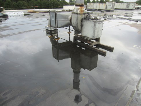

In addition to the design slope specification, it is critically important for builders, contractors, and design professionals to include the position and footprint of the HVAC equipment on the roof in the construction plans, including the weight of each unit (see photo below). Being that some component suppliers may not use an ample “creep factor” in their deflection analysis, an alternative might be for the specifier to artificially increase the weight of the HVAC units by a selected creep factor, at least 1.5 or 2.0, and to specify the larger HVAC weight on the plans. This approach would reduce the in-service stress level for the impacted framing, thus automatically reducing the amount of expected creep deflection in-service. A point to remember is that it’s the “sustained load,” or dead load, that drives creep deflection.
Roof deflection caused by the weight of mechanical equipment that wasn’t accounted for in the original design can lead to ponding.
Scott D. Coffman/courtesy Construction Science and Engineering
