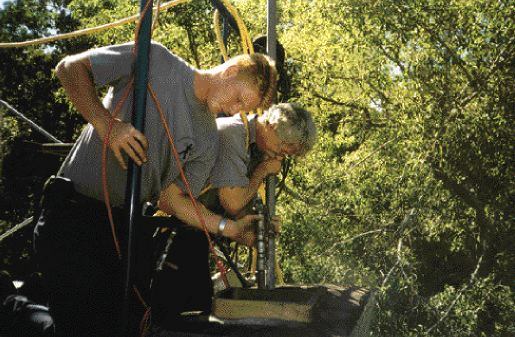

The other approach uses tubular inflatable formers that are centered in the chimney before a more fluid flue-liner mix is pumped into place around them (Figure 2).
Figure 2.Relining a chimney with inflatable formers and pumped liner mix is a cost-effective way to provide safe, properly sized flues for existing fireplaces, wood- or coal-burning stoves, and oil or gas appliances. The poured liners are rated for direct contact with combustibles, eliminating the need for costly framing modifications.
The formers are vibrated as the mix is poured, causing the mix to fill voids and gaps in the masonry. Once the mix has set up, the formers are deflated and withdrawn. The smooth-surfaced round flues that result are much more efficient than the typical square or rectangular tile-lined flue.
This is the method we use, because it's the best option for the large, multi-flue chimneys common in our area. The system I use is called Golden Flue, which is based in Rutherford, Va. (800/446-5354, www.chimneys.com). I like this system because the company is based relatively close to my area, which simplifies getting technical and logistical support, and because I feel that the mix-pumping system is better than others I have looked at.
