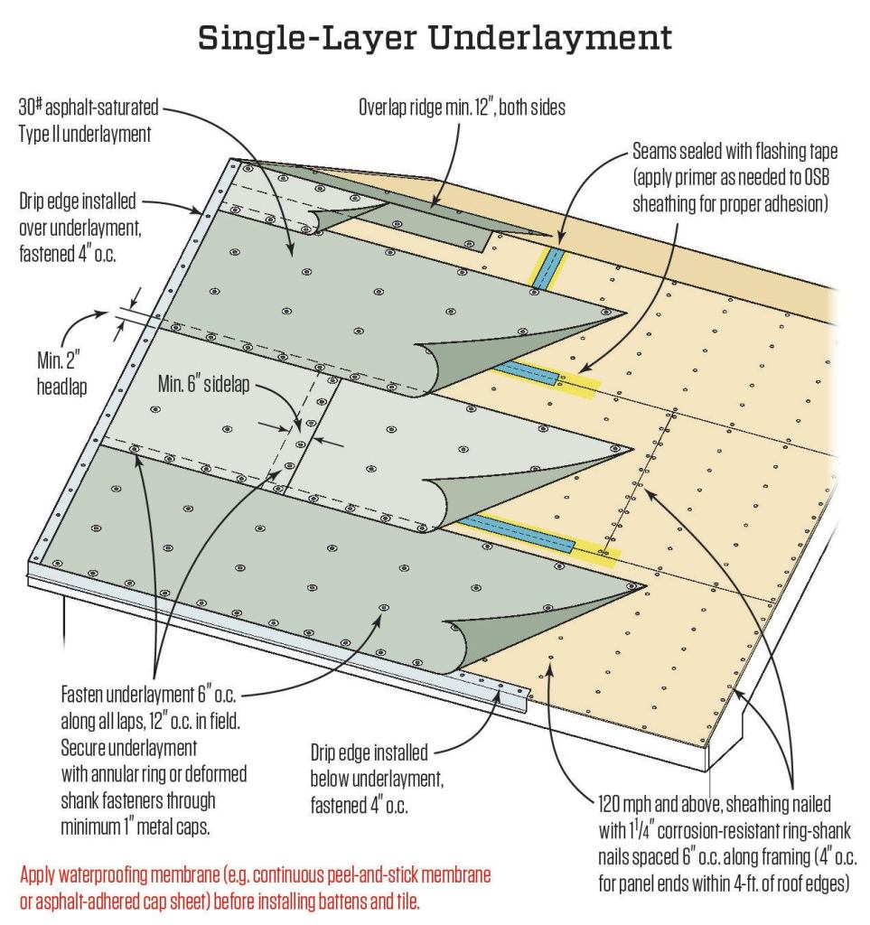

Sealing the Roof Deck
For a complete waterproofing system, first seal all seams in the roof deck, using one of the following techniques:
Minimum 4-inch-wide peel-and-stick tape applied over all joints in the roof deck, topped by roofing felt (shown at right). Depending on the surface texture or the amount of wax in the panels, OSB may need to be primed before application of any self-adhered material.
Retrofit spray foam. An alternative to peel-and-stick tape, a closed-cell spray foam can be applied to all panel joints from the attic side.
Properly attached synthetic underlayment with all seams taped. Synthetic underlayments generally last longer, are lighter, and shed water better than felts. Specs for fastening, headlaps, and sidelaps vary by product; manufacturer installation instructions must be followed.
To complete the waterproofing system, a waterproofing membrane—such as a continuous peel-and-stick membrane or a 90-lb. cap sheet adhered with hot asphalt—needs to be applied over the underlayment system shown at right.

While concrete and clay tiles are durable, it’s the underlayment—in concert with flashings—that actually provides the waterproofing. In high-wind regions, it’s not enough to simply tack down felt. The goal is to seal the roof deck against wind-driven rain, and the underlying materials need to hold their own in the event some tiles get blown off the roof.
Continuous peel-and-stick. The simplest way to seal a roof deck is with a continuous layer of self-adhering “peel-and-stick” underlayment applied over the entire roof deck. As simple as this seems, it might not be a good idea. When applied directly to the deck, peel-and-stick usually cannot be removed for reroofing without damaging the sheathing. For this reason, some jurisdictions don’t permit peel-and-stick to be applied directly to a roof deck. (Note: If it is allowed in your jurisdiction and you are reroofing over an existing layer, check with local code. Installing a second layer of peel-and-stick over the existing layer may be permissible, provided laps are offset between the existing and new layers.)
Single-layer underlayment. The default system is a single-layer underlayment over a sealed roof deck, as shown in the illustration above. To make this a complete waterproofing system, the joints in the roof deck must be sealed with peel-and-stick flashing tape or with spray foam from the attic side (see “Sealing the Roof Deck,” above). And over the top of the underlayment, full sheets of self-adhering waterproofing membrane, or the cap sheet for a built-up roof, must be installed. (When completed, the underlayment serves as a bond breaker that allows for roof demo prior to future reroofing.)
Underlayment material. Standard 30-lb. felt is common, but is far from the best choice. Felt has extremely limited tear-resistance, making it vulnerable during the installation of tile. Tile is heavy and difficult to handle gingerly enough to avoid abrasion. Felt also has limited UV resistance (maximum 30-day exposure).
A synthetic underlayment will provide a big jump up in quality. Synthetics are made with polypropylene, polyester, or fiberglass—all of which provide much greater tear and abrasion resistance than felt. Synthetics are also relatively impervious to UV exposure and can often be left to weather for months. And because synthetic underlayment rolls are generally wider and longer than rolls of asphalt felt, application is often faster (see “Do Synthetic Underlayments Make for Better Roofs?” Jan/13). Of course, synthetics cost two to four times more than felt (depending on thickness and other properties of the specific product), but they also carry warranties of at least 25 years.

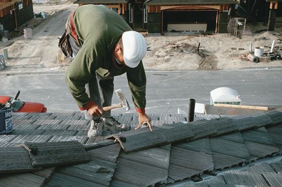

Securing tile. Two fasteners per tile will provide the required uplift resistance for a 130-mph wind zone. Hot-dipped galvanized, ring-shank nails (minimum 10d, or .121 inch, with a 5/16-inch, full-round head) or minimum #8 course-thread screws fit the bill. Nails and screws must penetrate the roof deck or batten by at least 3/4 inch.
In a high wind, the most intense uplift pressures on roofing are along eaves edges and along hips and ridges. Mortar-set tile, or mortar-set hip and ridge tile, is typically not permitted in high-wind zones—only an approved 2-part foam tile adhesive or mechanical fasteners are. Often a combination of nails or screws, hurricane clips or twist-wire connectors (see illustration above), and two-part foam for securing overlapping tiles is the fastest and most reliable system.
