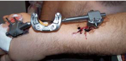

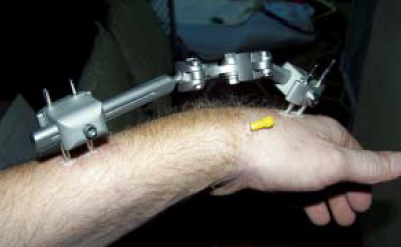

Just a 4-Foot Fall
My misadventure happened late last year while I was working on a new porch ceiling. I was no more than four steps up my stepladder when one of the ladder’s back feet worked its way to the edge of the porch and slid off (I hadn’t yet installed the railing).
Though the drop was only 4 feet onto grass, I didn’t want to tangle in the ladder, so I jumped back, away from the edge, and landed outstretched on the porch on my left side and arm.
Immediately, my left arm went numb; as I got up I could see my forearm was bent in a new shape and looked about an inch shorter. But it wasn’t until I took off my toolbelt — one-handed — that I realized some arm bone was stuck in my sweatshirt at my waist. I knocked on the door and asked my client to take me to the hospital.
When I finally spoke with an orthopedic surgeon at the ER, I explained through clenched teeth just how important it was to have my arm back quickly — I was still figuring I’d get a cast on and leave before lunch. But he told me I had a compound ulnar fracture (the bone sticking out below my wrist) and multiple distal fractures of the radius, along with a dislocated wrist.
In addition, the ulnar (or funny bone) nerve had damage; within a few days I would discover I couldn’t move my fingers laterally, or grip with my thumb and forefinger.
A cast was indeed possible following surgery, but only after several days of waiting for the swelling to subside.
However, if I could live with a few extra scars and an odd structure called an “external fixator” attached to my arm, the doctor was willing to reassemble my wrist and set the bones right away.
The fixator was a jointed metal beam clamped to pins screwed into solid bone on my arm and hand; it rode a few inches above my arm. It proved to be a huge conversation starter, particularly since I had to keep the incisions exposed, with all the metalwork and sutures and swelling out in plain sight.
Luckily, there was drafting and design work to do that I’d been putting off, so I was able to get back to productive — though one-handed — work on the computer later that same week.
Since the fixator allowed some forearm rotation (the screwdriver motion), I tried to keep my arm moving as much as possible during my convalescence, using some stretching and strengthening exercises I found on the Net.
Still, I wasn’t able to move my ring finger and pinky at all. The pinky stuck out laterally from my hand and kept catching on door frames, and I couldn’t even squeeze toothpaste. For a while, my doctor thought that perhaps the ulnar nerve had been severed, which would mean five to six months for regrowth and recovery.
After only 39 days, the fixator and pins came off, and the doctor made another large incision on the inside of my wrist to determine the cause of the continuing ulnar palsy. Fortunately, it was scar tissue (which was removed) that was pinching the nerve, not a severed nerve. Afterward, I continued with my exercises, slowly gaining strength and feeling in my hand.
As I write this five months later, my hand and arm function is almost normal, although a few odd conditions — an old broken middle finger that now locks closed when I make a fist (I have to use my other hand to snap it back straight); my inability to get my wedding ring back on; and my five suture scars — serve as reminders of my 4-foot fall.
So what did I learn from my $26,000 tumble from such an insignificant height?
To check my ladder each time I climb it, and to wear the right shoes — I had been wearing gardening slip-ons, and I think they contributed to my fall.
But most important, I learned to be more respectful of all construction activities, not just the ones that seem dangerous.
Forrest McCanless is a designer and general contractor in Oxford, Ga.

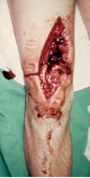

Knee a Poor Substitute for Sawhorse
by Mark Parlee
While framing an apartment complex, I was in the process of cutting plates for closets, but my mind wasn’t really on the job. I was going through a divorce at the time and was supposed to leave around lunchtime for a child custody hearing.
Outwardly, though, I was in cutting mode: I’d grab each board from a stack of 2-bys, prop it on my knee, and quickly cut off the marked ends.
Clearly I was operating on autopilot, because as I brought my saw down to make a cut I missed the 2-by altogether. Instead of plunging into wood, the spinning blade plunged full depth into my leg, leaving a 2 1/4-inch-deep, 8-inch-long kerf clean through my kneecap, through leg muscle, and into bone.
I don’t remember feeling any pain at first, but I do remember worrying about ruining my favorite pants and wondering how many stitches it would take to sew up my leg.
When I looked up and saw the stunned face of my boss, then looked back down at the injury, I realized that stitches wouldn’t be an option, and that the pants were the least of my worries: My leg was opened up so wide I could have put my fist in the gash.
The wound required two surgeries — one to clean it up and another a couple of days later to stitch everything back together once it was clear there was no bone infection — plus a long period of recuperation.
Then I began physical therapy. I spent 100 painful 21/2-hour sessions just trying to break up scar tissue and regain my leg’s range of motion. When I was able to start riding a bike, I worked my way up to 100 miles of roadwork a day to help heal and strengthen my leg and regain flexibility. After seven months, I was able to go back to work.
Since then, I’ve recovered virtually normal function in my leg. And while I admit that I still occasionally prop a 2-by on my knee, you can be sure that I now remain completely focused on what I’m doing when I’m using my circular saw.
Mark Parlee owns Parlee Builders in Des Moines, Iowa.

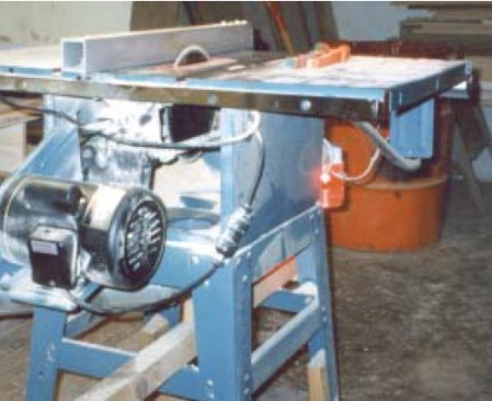

Vanity Thumb
by Bill Wise
For more than 50 years, I’ve built custom cabinetry in my basement workshop, and while I’ve made my share of stupid mistakes, none have resulted in a serious injury — until recently.
I’d just finished making the final cuts for a piece of furniture that had gone through a number of client revisions, and I decided to clean up some of the sawdust while the vacuum system was still running.
My table saw has a shelf under the blade with a pan for the vacuum collector, but some sawdust always clings to the pan and needs help getting to the collector’s center hole.
Thinking that the saw was off, I reached in with my left hand to clear the sawdust, felt a strange sensation, and quickly jerked my hand back out of the pan. My thumb was almost completely sawn off at the joint; it was held in place only by a 1/8-inch-wide piece of skin attached to my index finger.
I’ve always worn hearing protectors when running shop machinery; in this case, I’d forgotten to switch off the saw, and with my earmuffs on I couldn’t hear that it was still running. I was lucky I didn’t cut my entire hand off.
My wife, a registered nurse, was on the first floor when I shouted out, “Let’s roll! I’ve sawn my thumb off!”
After his accident, the author equipped his table saw with a clearly visible running light; now he knows if the saw is on even when he’s wearing hearing protection. Note the absence of a blade guard between the underside of the saw’s blade and its dust-collection port.
While she ran to get the car started, she told me to stop in the bathroom and wrap the thumb in a wet towel. Then we were off to the emergency room at the nearby teaching hospital, where she’d worked for 18 years.
Not 20 minutes after the accident, I was getting anesthesia as the doctors prepared to reattach my thumb.
Today, three years later, almost no one notices that my ‘vanity thumb’ is about 1/4 inch shorter than my working thumb; the color is fine and the nail is normal. It doesn’t bend except as a fixed unit on that side of the palm, and it has limited feeling.
It’s not very strong, either; since both tendons are connected just below the fixed thumb joint, it doesn’t grip effectively.
I still work in my shop. But because most shop machines don’t have an “on” light to indicate that they’re running, I have equipped all my equipment with clearly visible, red-bulbed porchlight-type lamps wired into the power switches.
Bill Wise is a retired electronics technician and a lifelong woodworker in Winston-Salem, N.C.

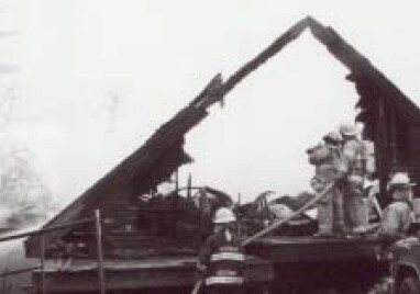

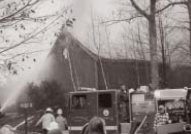

A Devastating Fire Caused by Oily Rags
by Steve Malcom
It was about 2 a.m., just before Thanksgiving, when I got a call from the alarm company indicating that there was a problem in one of our company buildings.
These calls usually turn out to be irritating false alerts, but this time, the alarm was real: Our custom paint and finishing shop was on fire and the fire department was already on the scene.
When I arrived 15 minutes later, most of the building was in flames. Apparently, one of our employees — despite the availability of approved containers — tossed a handful of oily rags into an open trash can, where they spontaneously combusted and started the blaze.
Fortunately, nobody was hurt and the fire department prevented the blaze from spreading to our other buildings and to the neighboring woods.
But our paint shop was totally destroyed. This same building had housed our design department and provided storage for many of our tools, including expensive items like laser levels and portable generators.
It had also contained a variety of specialty hardwoods we’d been saving for just the right application.
Everything was a total loss.
This experience taught us something besides the obvious. Yes, it’s important to dispose of solvent-soaked rags in a sealed container designed for that purpose and to continually train employees in matters of safety.
But it’s equally important to make sure your insurance coverage is kept up-to-date.
Our insurance settlement covered only about half the cost of rebuilding and replacing our lost equipment; it took more than a year to get our building rebuilt and get back to where we were — a painful lesson both personally and economically.
Now we review our coverage regularly with our agent and make necessary adjustments to our policies as our business grows.
Steve Malcom owns Boothbay Homebuilders in Boothbay, Maine.
