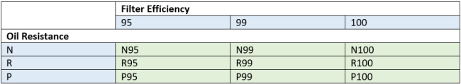

The term “N95” is used often when it comes to disposable respirators, however many people don’t fully understand its meaning. The “N95” is a rating that’s derived from the National Institute for Occupational Safety and Health (NIOSH) classification system for particulate filters, which includes disposable respirators as well as filters for reusable respirators. This rating system uses three letters and three numbers: N, R, and P, along with 95, 99, and 100. Combining a letter with a number gives you a rating that tells you the filtering media’s resistance to oil and its filtration efficiency. Here is a key to help decode those letters and numbers:
Letters – Resistance to oil mist
• N - Not resistant to oily mist
• R - Resistant to oily mist
• P - oil Proof
Numbers – efficiency against certain particles
• 95 – filter provides at least 95% filtration efficiency
• 99 - provides at least 99% filtration efficiency
• 100 - provides at least 99.97% filtration efficiency
For example, a disposable respirator that’s labeled “N95” is NIOSH-approved to be at least 95% efficient at filtering out certain solid dusts and liquid mists that do not contain oil. A P100 is NIOSH-approved to help filter at least 99.97% of certain solid particles and liquid mists, as well as those containing oil.
