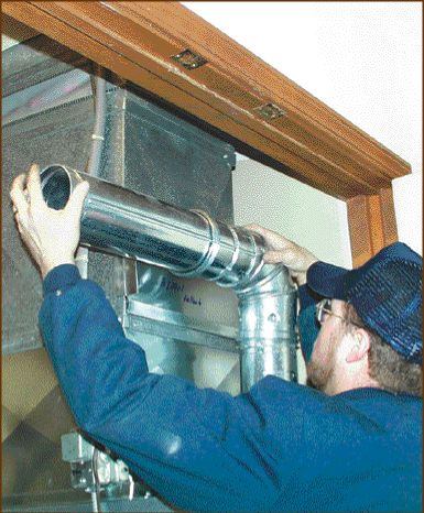

Most furnaces, boilers, and water heaters going into homes today are not super-efficient “sealed combustion” or “direct vent” units. They are mid-efficiency “atmospheric-vented” appliances that use a regular vent or chimney, relying on natural buoyancy to carry the hot gases up the flue and out at the top.
But compared to yesterday’s 65% efficient units, modern 78% to 83% efficient, naturally vented appliances keep more heat in the house and send less heat up the flue — and that makes things tricky. The cooler the flue gas, the weaker the draft and the greater the risk of back-drafting.
Cooler exhaust also increases the risk of condensation and corrosion in the vent. Gas burner exhaust is mostly carbon dioxide and water vapor, and in modern systems, that moist mix enters the flue at a temperature not far above its dew point of 140°F. If the moisture hits a cool surface, or just takes too long to reach the top of the system, it’s likely to condense — and because the vapor contains trace amounts of oxides of nitrogen, the condensate is a weak nitric acid solution that can corrode masonry or metal (see Figure 1).
Condensation in gas flues is acidic and can attack vents and chimneys. Telltale white deposits and rust are signs of corrosion (top left), which can perforate vent pipe and allow fumes to leak (top right). Chimneys are especially vulnerable: Acidic condensate eats through tile flue liners (bottom left) and destroys brick masonry (bottom right). It takes 50,000 Btus to heat a masonry chimney above the dew point of gas appliance exhaust, while only 125 Btus are needed to warm a B vent flue.
If vents and chimneys get wet only occasionally and dry out quickly, damage isn’t likely. But systems that get wet and stay wet can corrode badly, and fast. To minimize “wet time,” modern vent systems have to be sized just right — large enough to handle the exhaust but small enough to warm up quickly, so that any condensation will dry up before the equipment shuts down and the flue won’t stay wet between cycles.
Material choices affect vent function, too. Masonry chimneys that take a lot of heat to warm up and uninsulated single-wall vent pipe that allows excessive heat loss have limited usefulness with modern gas equipment. For the most part, those old materials are being replaced by insulated double-wall B vent, which warms up quickly and has an aluminum inner lining to resist corrosion.
Even with modern vent materials, the rules for designing and sizing vent systems are complicated. With modern systems, the old “common sense” rules of thumb can be a recipe for failure. In fact, following the latest rule book religiously isn’t always enough. To make sure the system works the way the installer intended, a trained technician should use combustion and draft testing instruments to check each installation against the manufacturer’s specs.
