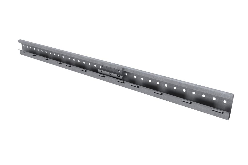

The Ultimate Clip is Nichiha’s improved installation system for its fiber cement Architectural Wall Panels. Comprising a starter track and a single 26-inch clip style, the system simplifies installation over previous versions which required users to choose from multiple clip styles and sizes depending on installation factors. Creating a built-in rainscreen with a 10mm air space to drain moisture and dry the wall, the Ultimate Clip system improves the system’s wind rating by up to 83%. Only two clips are needed per 6-foot panel in basic installations. Users can work with Nichiha engineers to customize the system as needed for various installations. Miami-Dade approval is pending. nichiha.com
