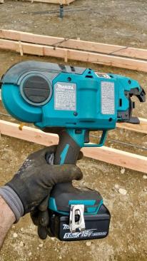

Makita XRT01ZK 18V LXT
This gun uses #3 wire to make three ties in under 1 second. You can tie two #5 bar or four #4 bar, so this is perfect for residential construction. There are two modes for tying, single or continuous. We leave it in single unless we are tying a matt of bar, then about as fast as you step on, around, or between bars, you can tie. The tool weighs under six pounds and has a belt clip.
The Makita LXT rebar tier operates off of the company's 18-volt battery platform.
One advantage of this gun is that it runs on Makita’s popular 18-volt battery platform; if you have other Makita tools, the batteries are all interchangeable. With the Max gun, we have only one battery, which doesn’t work on any other tools and takes about 45 minutes to recharge.
Rebar tyers in general can be prone to misfiring if you don’t use the right wire, or if dirt and water get into the gears. We only buy Max wire, which we use in both the Makita and Max guns, so a misfire is rare. We learned the hard way not to buy the cheaper wire you can find on Amazon. Even the Makita wire that came with the gun made the motor sound like it was bogging down compared with Max wire. Since our local Whitecap stocks Max wire, we just buy that.
The Makita LXT has a plastic cover to keep moisture and dirt out of the tying mechanism.
If it gets damp at all (which happens often here in the Pacific Northwest), we make sure to blow out the gears. Taking this a step further, Makita uses a transparent cover over the wire wheel to protect it from the weather and dirt. While I’ve heard from a few guys on Instagram that they had trouble with their gun, the Makita gun has been good to us over the last year and a half (at one point, it showed an error code and I had to send it in to get it fixed). On Amazon, the Makita gun costs $2,000.

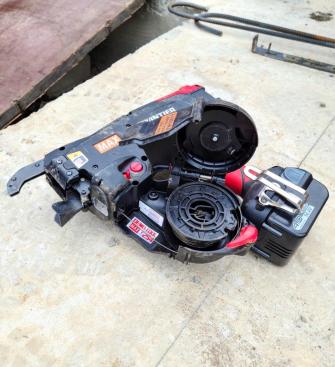

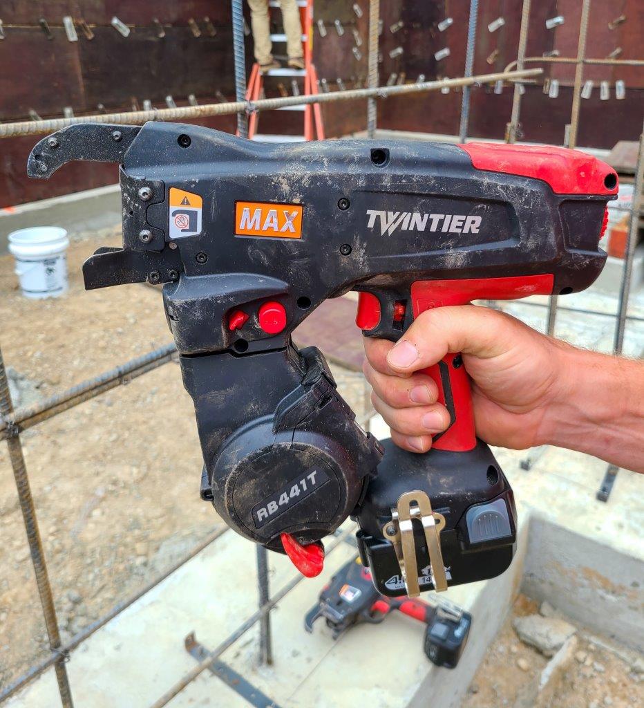

Max has been producing rebar tying guns since 1993, with the Twintier being the latest iteration. I was blown away at how fast and compact the new gun was when I saw it at the International Builders Show last year, and I recently had the chance to use it on a basement foundation we were forming.
The MAX Twintier can tie up to #7 x #7 rebar.
The Twintier is definitely faster than previous versions of the Max gun and about twice as fast as the Makita (to see the difference, check out this slow-motion video, which is shot at about 5% speed at 240 frames per second).
The Twintier uses a special wire because of the “dual feeding” mechanism, so its essentially tying two wires simultaneously. And while it seems counterintuitive, the gun actually uses less wire to tie the same amount of rebar as the earlier Max gun and the Makita gun – about 120 more ties with this gun per roll compared with the other two. I actually got irritated trying to run it out of wire, because it just kept going and going. The rolls for the Twintier cost about $8.39/roll ($0.033 per tie) and for the other guns, $5.59/roll ($0.043 per tie), so it is a little less money per tie and faster. The larger jaw will tie up to a #7x#7 (7/8” x 7/8”) rebar and will work just fine with two #4 x two #4.
It's easy for even an inexperienced crew member to tie rebar together neatly with either the Makita or MAX rebar tying gun.
One of the big improvements that MAX made to the gun is that it is better sealed than the older RB397 that we bought in 2014, so that the wire rolls aren’t open to the elements. The tool is very light and compact, weighing just 5.6 pounds. You can buy the Twintier online for $2,700.

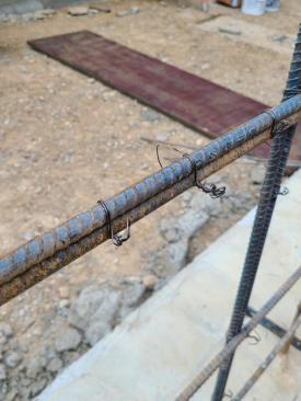

Really Worth the Price? When our engineer makes site visits, he stresses how important it is to tie bar in a clean way, exactly per his specifications. But often, it’s the lowest-paid guy who is tying the rebar (which is how I started), so I know from experience that it may not end up being the straightest or best job. A gun makes it much easier to get it right. According to Max’s promo literature, it is 5x faster to use their gun than to tie by hand, which is true for our crew because we aren’t professional iron workers. These tools are fast, and the Twintier is crazy fast.
We had a young guy working with us on the job this summer who had never been on a jobsite before, but with this tool he could tie 3x faster than me on his second day of work. Granted, I don’t tie fast compared with a lot of guys (well, most), but my point is that a starting wage earner with an expensive gun is more economical than a high dollar guy who’s still not as fast as I would be with a gun.
Sure, professional rod busters are fast at hand tying, but it takes thousands of hours to get that way and takes a physical toll. Tying bar faster means less wear and tear on a body, so it is an investment. I know what when I get tired, quality goes down, so having rebar tied in straight lines, with the right spacing means I’m going to pass inspection, including from the engineer who comes out and pulls a tape to make sure the foundation will perform as designed. Right now, we are often one to two weeks out on inspection, so how much does it cost to fail due to sloppy rebar work? One of our rules of thumb is that each day lost on the schedule adds three days to the job. Besides all of that, when the inspectors know you do a clean job, they will be easier to deal with. They ask us how we get these clean little bows you can see in the pictures.
