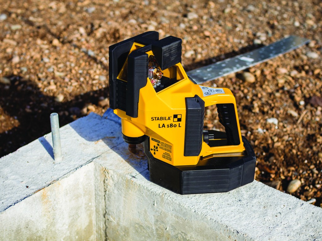

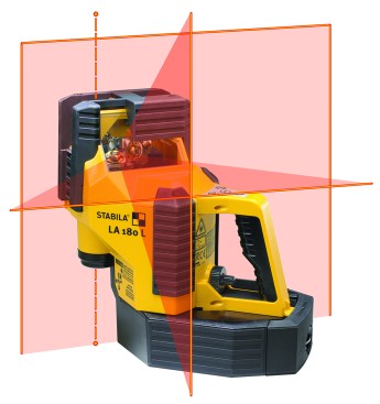

This goofy-looking laser shoots three plumb lines and one level line. Two of the plumb lines fan vertically 180 degrees from each other, and the third plumb line is perpendicular to them. There is also a plumb dot that shoots down and up, which helps align the laser when you’re shooting square. Each of the lines pulse, so they can be used with any detector up to 328 feet away. But the LA180L also comes with a special REC410 Line RF (radio frequency) receiver—and this is where this product gets interesting.

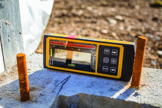

A smart receiver and many lines. The REC410 Line RF receiver communicates with the LA180L via radio frequency to auto-align it for square. A groove below the level vial shows the marking position.

Once it’s aligned, I can also use the up/down arrows on the receiver to move the laser. This is helpful when we are compensating for out-of-square conditions and want to quickly know how much an adjustment of one leg will affect the other. Here’s an example: Sometimes, we have to adjust one side of the mudsill so that it will hang over the foundation wall. Ordinarily, we’d then have to re-square to find out how much this affects the other leg. At that point, we might find the other leg is too far out. But with this laser, I can check quickly without all the tapes, and so on; all I have to do is walk over and check each leg with the detector. There is no re-squaring, because the unit is always square and it instantly adjusts.

There are a couple of things about this laser that I found a little clunky. One is that while the shape of the laser makes it easier to fit into corners, it also makes the unit a bit cumbersome and awkward to place in some scenarios. It works best on a level surface plenty large enough for the base and is sometimes precarious on the edge of a stem wall foundation. Stabila does make brackets ($150 each) for that application, but they add expense. The second quibble is that because of the shape of the unit, it’s awkward to handle when you’re replacing batteries (it takes D Alkaline; a rechargeable battery kit is sold separately for $100). It’s easy to change them, but doing so puts the unit off balance, so you have to set it down gently.
