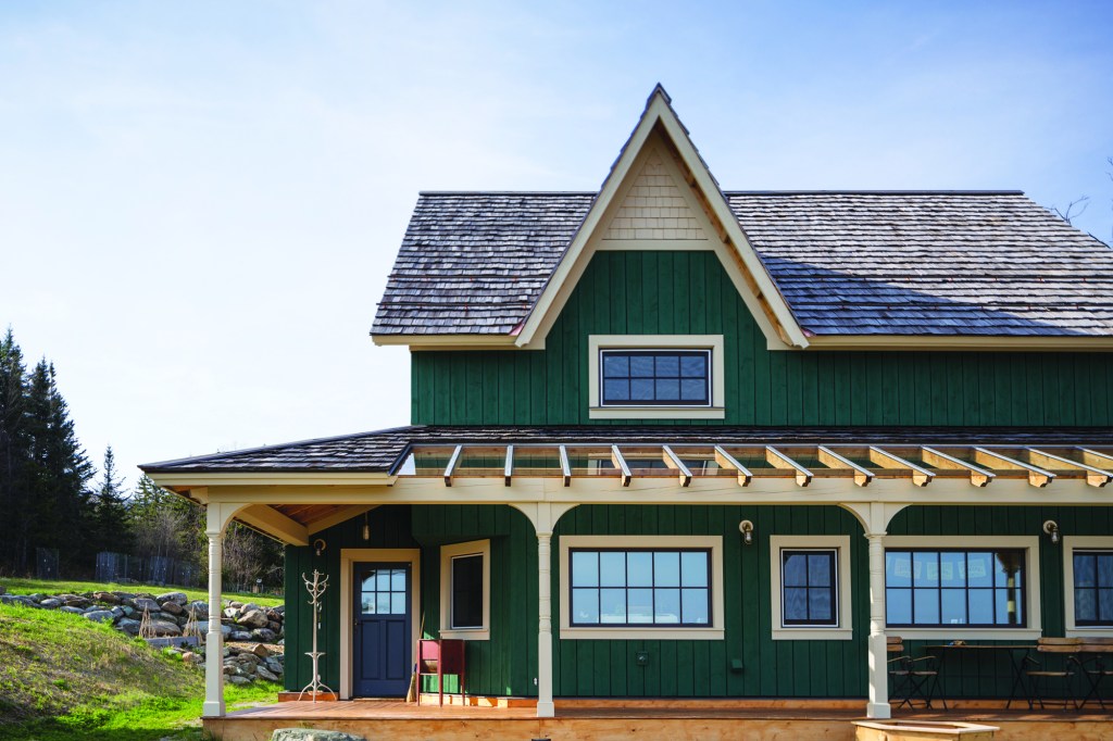

At $303 per square foot, this 1,650-square-foot Middlesex, Vt., off-grid, foam-free
house sequesters 600 kilograms of CO2.
Photo courtesy New Frameworks
At $303 per square foot, this 1,650-square-foot Middlesex, Vt., off-grid, foam-free house sequesters 600 kilograms of CO2.

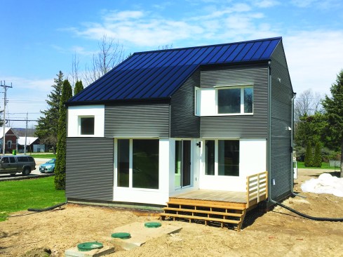

Built by Chris Magwood’s Endeavour Centre in Clarksburg, Ont., this 1,100-square-foot zero-energy house cost $254 per square foot and stores 24 tons of CO2.
Photo courtesy Endeavour Centre
