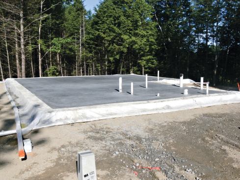

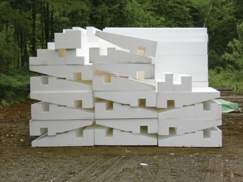

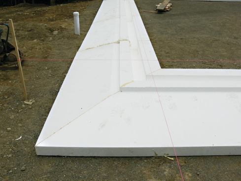

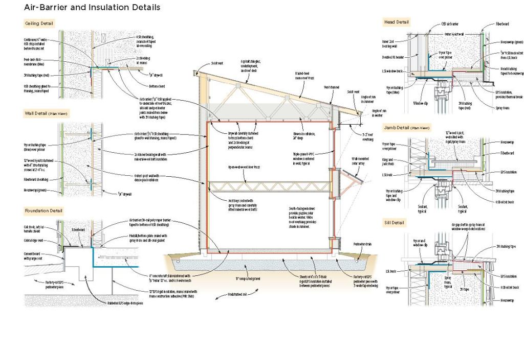

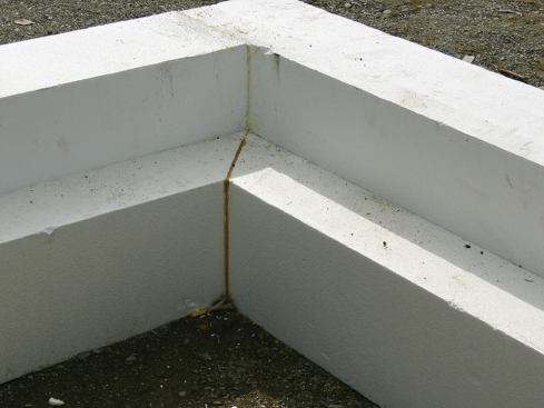

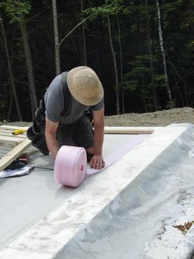

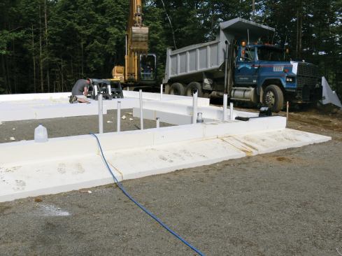

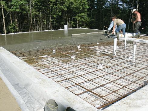

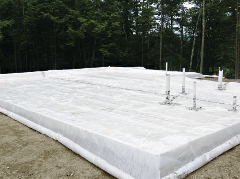

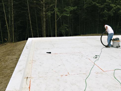

To achieve the Passive House goals, we had to superinsulate every assembly on all sides of the house - foundation, walls, roof. The 8-inch foundation sits on a foot-thick polystyrene insulated-form system. The walls are "hybrid" assemblies, with an inner 2x4 bearing wall and a foot-thick outer structure built with wood I-joists and insulated with dense-pack cellulose. The conventional vented-attic truss roof has a 2-foot raised heel to accommodate deep-blown cellulose.
We also had to eliminate thermal bridging where these building elements meet, which we did by extending the exterior insulation to cover the ends of framing at joints and intersections.

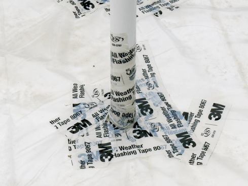

And, finally, we had to make sure that the entire building envelope was meticulously air-sealed .
