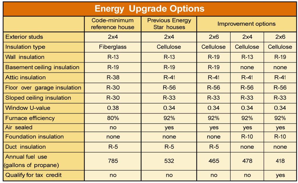

This table compares a code-minimum reference house and the author's previous Energy Star houses with various improvements he considered in order to gain a federal tax credit under the Energy Policy Act of 2005. It assumes air conditioning efficiency of SEER 13.

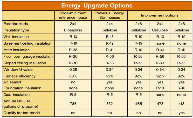

The Energy Policy Act references the 2003 International Energy Conservation Code with its 2004 Supplement. The credit, which remains available through December 31, 2008, covers only heating and cooling energy and requires that 10 percent of the energy savings be the result of improvements to the building envelope. (For more information, go to www.energystar.gov).
While the federal credit is independent of the Energy Star program, the same rating contractors — certified Home Energy Raters — monitor the program. I worked closely with Craig Marden of Conservation Services Group, a local Energy Star auditing company, to identify the best combination of practical, proven methods to achieve the goal. We looked at three main areas for improvement: windows, mechanical equipment, and insulation.
As it turned out, the windows I had already been using, Pella ProLine double hungs, were fine, as was the Frigidaire propane furnace, so those two items required no upgrade. I had already been air-sealing my previous Energy Star houses, which was critical for meeting the federal criteria. So I focused my attention on insulation and bringing the mechanical equipment and ductwork into conditioned space (see illustration).

We determined that I would need R-10 foundation insulation. This would also transform the basement into conditioned space, which would have an important benefit: I would no longer have to insulate beneath the first floor, or any ductwork running through the basement. Moreover, insulating the foundation would bring the furnace and water heater inside the thermal envelope and provide a tempering effect on the space.

Even though my previous 2×4 houses had met Energy Star requirements, I found that in my climate 2×4 exterior walls wouldn’t qualify for the tax credit. So I upgraded to 2x6s, which allowed for an increase in wall R-value from 13 to 19.

At the end of the project, I was disappointed to learn that the $2,000 tax credit was somewhat of an illusion, because I had to deduct that amount from my expenses before determining my income. Thus I had in essence an extra $2,000 in income to pay taxes on. Assuming a 40 percent total state and federal tax rate, I had to pay an additional $800 in taxes — meaning the credit was actually only $1,200.
